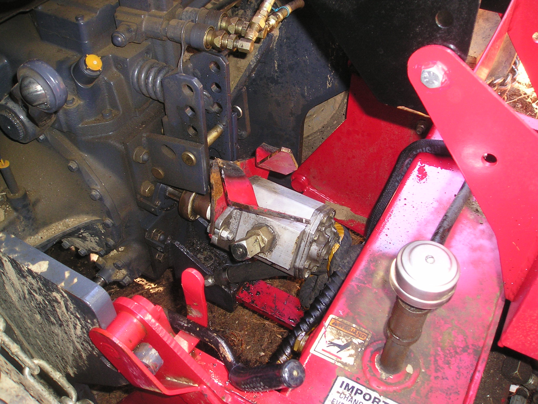

bob do you have a pic of the bracket your hoe use's to stop pump rotation?
the forks or tangs at the top of the pump are suppose to stopped by the red bar on the bottom of the pic."somehow" was a nice way to say !@#$ crappy design either the from the force of pump rotation or stuff hitting them from below and bending them up.of course dealer never saw anything like this:mad: 9 months later i thought i calmed down but now i'm mad again
doug if the pump lets go,its not going to hit my head but it will get where my brians are:rolleyes:

Not sure what you're dirving at but the "forks" should be on the bottom of the pump, straddling the bar that replaces the swinging drawbar. Maybe that's why you "cycled" the pump....both the high pressure and return lines are nearer the middle of the pump, the forks probably can be put on at the top or the bottom, but in this usage, the forks and the major part of the pump ride below the line of the PTO shaft and straddle the bar thru the drawbar frame. Don't have a picture here, but its not a bad design and is identical to all other PTO pump setups I've seen (including Woods).

bob yes it was set up that way but 3,yes 3 times makes me think something was not right.
doug,bob did it:D i'm glad he was the tester ,not me :rolleyes:
