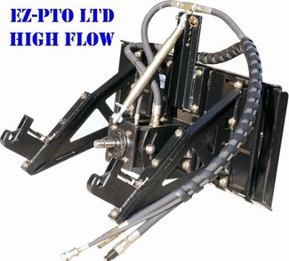

What about a hydraulically driven Skidsteer blower and tapping into your tractor hydraulics?
I have no idea if your 3510 has enough flow rate but thought I would toss that idea out there. Maybe a PTO pump and some long hoses?
   / PTO Relocation #26
This is just one other option you might consider, but that is if you ;have the hydraulic GPM's. A hydraulic motor up front to drive the snow blower.
