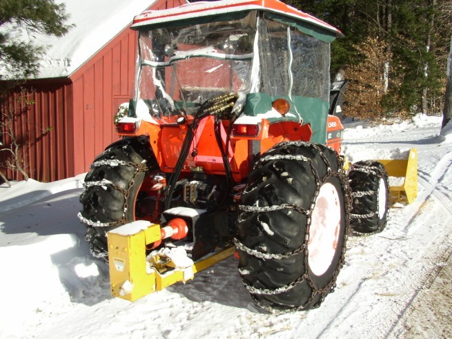

I have an erskine on the front of my JD4500 which is powered from the rear 540 PTO. The darned thing is nearly 14 years old and I think I have put no more than $100.00 of service and repairs in it in that time. And, it has moved alot of snow in the 14 years. Good luck. Roger

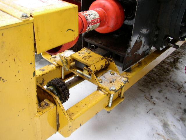

The big difference between Lorenz and Erskine front-mounts is in the rear pto gearbox. The Lorenz pto box uses gears to change the shaft rotation so the blower can be the same whether on the front or back. Erskine's pto box has a chain drive - so their front blower rotates the other way (mirror image chute and fan).
John - the pto box may extend back too much for leaving the backhoe on - it will be close. Erskine is longer than the Lorenz, but narrower. Pic of the Erskine attached. Lorenz pics at Roger's link above.
