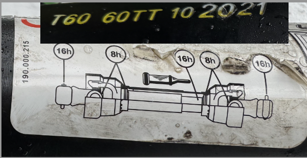

1. For the grease diagram what exactly is that saying? To me it looks like there are several different drive shafts, is it referencing the outer cover somehow?

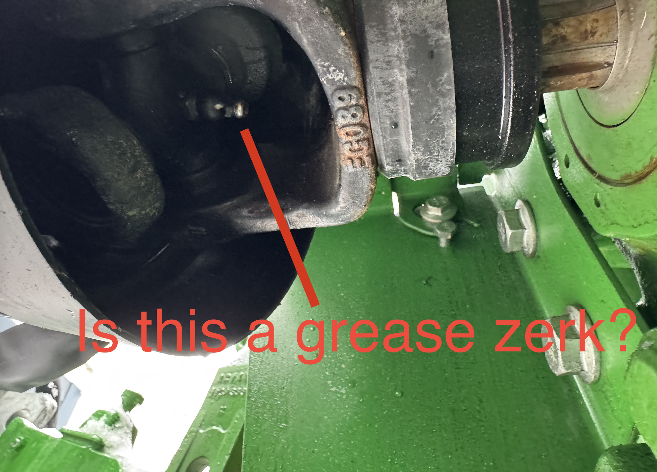

2. On the tractor side of the PTO shaft it looks like there might be a grease fitting on the u-joint but the location requires a 90, it looks slightly oversized so it has me guessing. Do people keep two grease guns around for straights and 90s?

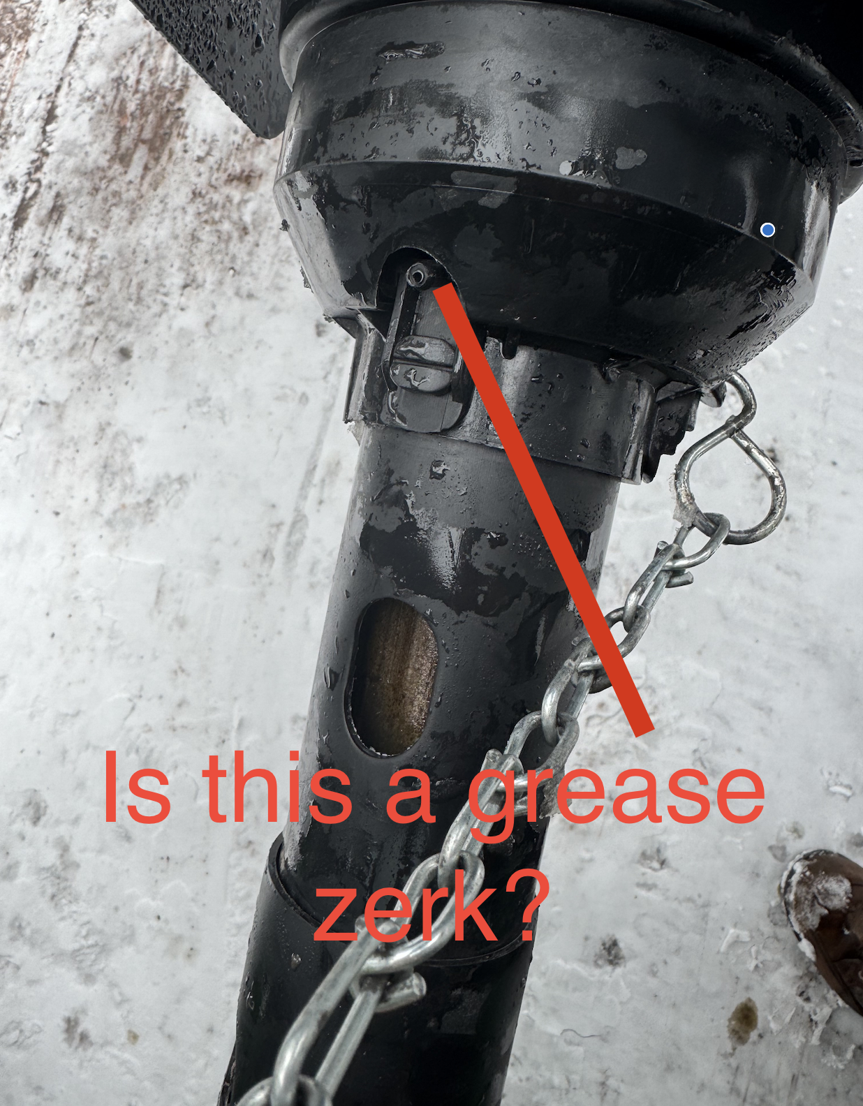

3. Each side of the outer plastic housing looks like it has a grease fitting - is that really what it's for, and why?

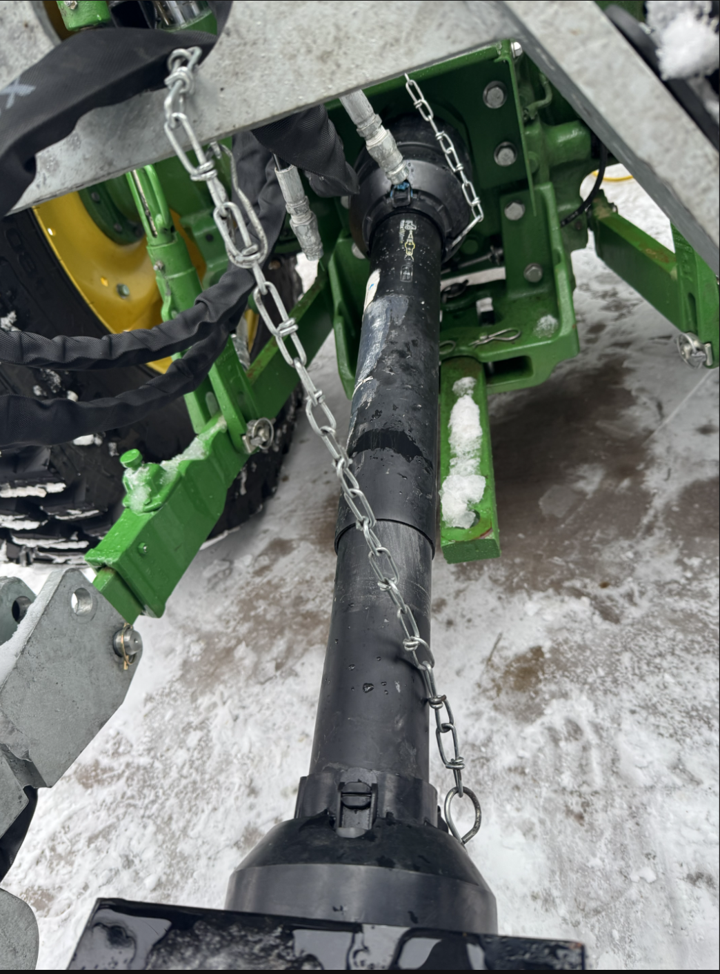

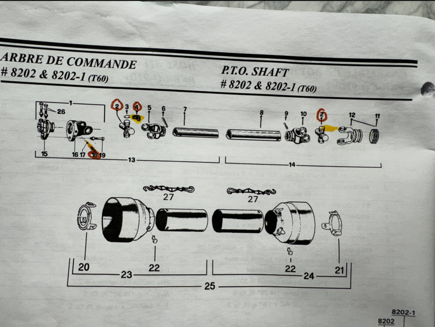

4. How do I disassemble this thing, and I am assuming I need to regularly dissasemble to apply the grease to some parts? I included a diagram from the snowblower manual but I'm still very confused.

1. Basic idea is to grease the splines and their locks on both ends, the crosses on both ends, and then be sure there's some grease between the shield and the shaft assembly. That makes three grease points on each end of the shaft, plus greasing the (usually square) tube slip joint. So, pull the thing off the tractor, pull the two shaft halves apart, grease outside of the "inner" shaft, and slip them back together.

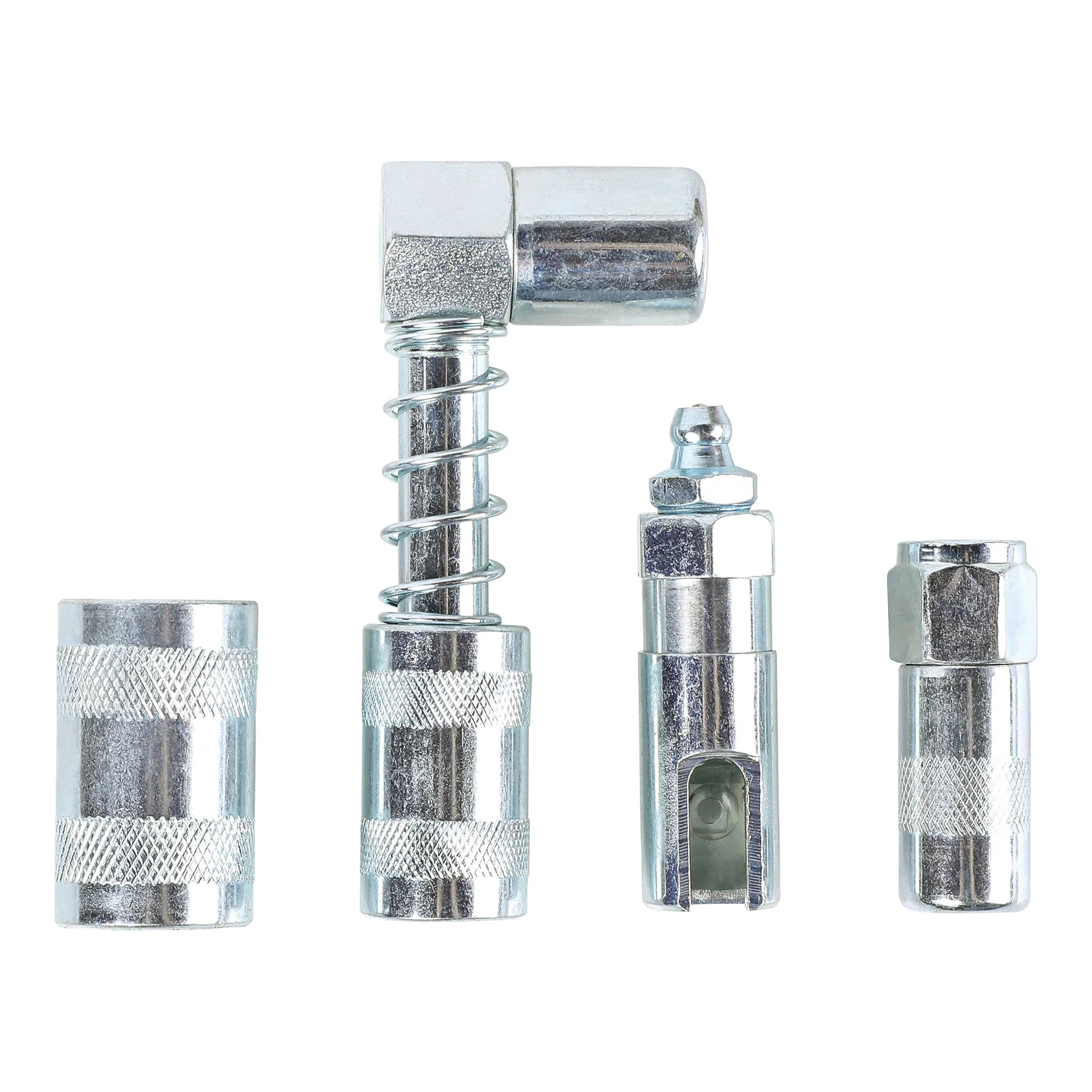

2. The crosses can usually be greased with a straight gun tip, by just knuckling the joint over at 90 degrees. But they do make 90 degree adapters to go on the end of your grease gun, and you should probably have one of these for other purposes, even if not here:
3. Yep... you want to be sure that outer guard can spin nice and free on the driveshaft, as that's what'll keep the shaft from sucking you in if it catches your shirt tail, etc.
4. Just pull. It should be a telescoping tube with no stops. Half the time, they fall apart when you don't want them to! :D

Thanks to both of you, it sounds like to properly do this greasing I will need to disconnect the drive shaft from both the tractor side and the snowblower gearbox side so that the other guard can slip off and I can separate the drive shafts
I was thinking it might be able to be done by leaving it connected or disconnecting only one side.
   / PTO rookie - questions about disassembly and greasing #5
Just disconnect tractor side and drop the implement off the tractor. I never remove my driveshafts from the implements they’re on, unless I’m doing a repair on them.
   / PTO rookie - questions about disassembly and greasing #6
Pull the shaft out and put it on a bench.
