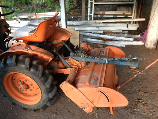

The reason this probably wasn't done was that the B6000 had a reverse rotating PTO shaft compared to what is "normal" for US and EU market machines (counter clockwise vs clockwise for a "normal" PTO shaft).
As such you cannot connect the PTO directly to a "normal" PTO shaft and an adapter would not be of any use.
As I understand it, the B6000 was a JDM (Japanese Domestic Market) machine and was intended to have a tiller more or less permanently mounted to the back. It was never intended to be exported outside of Japan and (IIRC) was never officially exported outside of Japan.

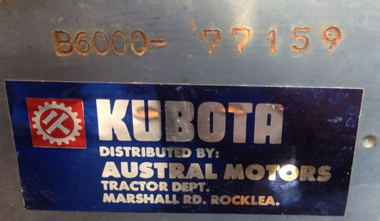

I have been in contact with Kubota Australia. All they did was refer me to Specialist Linkage Supplier.
Would you happen to know how I can find out, for my machine, if it actually is a 'Gray Market' machine? Here is the serial number Tractor Supplier.jpg The Supplier plate look like it is Kubota supported
Would you happen to know how I can find out, for my machine, if it actually is a 'Gray Market' machine? Here is the serial number View attachment 411073 The Supplier plate look like it is Kubota supported

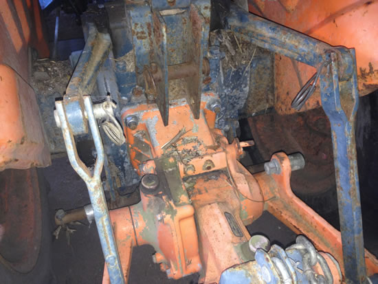

All might not be lost yet, just the tiller. I read some where that there is a pto reverser around. I just can't remember where I read it. About the lower link arm, I didn't see them in your picture, but you can make them. Just hang tight for awhile and do some searching, maybe someone well come up with what you need. Don't sell that little tractor short it's nice little tractor!
