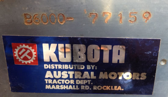

I have been in contact with Kubota Australia. All they did was refer me to Specialist Linkage Supplier.
Would you happen to know how I can find out, for my machine, if it actually is a 'Gray Market' machine? Here is the serial number Tractor Supplier.jpg The Supplier plate look like it is Kubota supported

Would you happen to know how I can find out, for my machine, if it actually is a 'Gray Market' machine? Here is the serial number View attachment 411073 The Supplier plate look like it is Kubota supported
