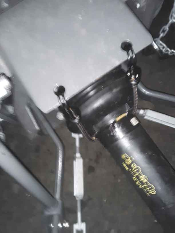

I have a shield on my PTO that is just a PITA. This is not the plastic shield over the shaft but the one on the tractor over the PTO. It is shown in this image, the bungees are hooked to it.
This shaft goes to my snowblower. There is a bracket on the blower to hold the shaft when it's disconnected. In order to hook up the shaft the end of it must go past this shield. The shaft is about 1/2 to 1 inch too long. I have to remember to take the shaft out of the bracket and put in on the ground before I back my tractor up to hook it up. I thought about shortening the shaft but after looking at it it is already shortened as much as possible to maintain the minimum overlap of the two halves of the shaft when at it's longest point. You'd think that if I raised the blower to the point where the shaft would be at its longest I'd be able to get it past this shield, but that is not the case. I'm not the guy that's going to take off that shield. Eventually I will remember to put the shaft on the ground before I hook the blower up to the 3PH.

I just tossed a set of plastic covers and run an open PTO now so that it's easier to grease and much easier to hook up and unhook. Besides, I was taught to never be near a spinning shaft, so just like the little lawn mowers that have to shut off when you let go of the handle, it's extra stuff that careful operators don't need. I would remove that shield from the tractor, too. My Massey 1010 has a similar shield that prevents you from getting both hands on the bell unless you are underneath. Go figure
