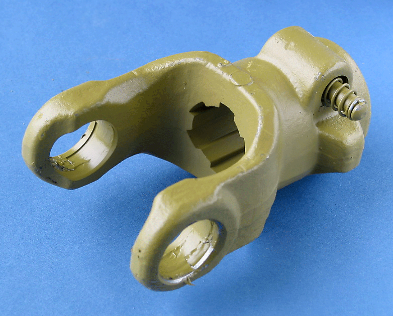

I want to resurrect this thread and describe what happened to me this morning and what I did about it.
My tractor (Branson 4530) has release and drop down, spring loaded ends on the three-point arms, which allows them to be extended about six inches when connecting implements. I hooked up my bush hog type mower yesterday and didn't get one of the ends latched back in properly. When my wife started the PTO, the geometry was wrong and the shaft came apart at the end. I saw the three point issue, reconnected the shaft and aligned the three point properly. She started up the mower and everything was fine.
This morning, I hopped on the tractor and raised the mower full up. The PTO shaft bent and it drove the PTO shaft coupling all the way to the end of the input shaft, much like the original poster described here. Mine, however was the standard spring-loaded, pushbutton kind. Like this one.
So, I naturally came to TBN to find out what to do. I was intending to get a gear puller from the local auto parts place when it dawned on me that the remainder of the shaft was hanging straight down and touching the end of the drawbar, like a lever.
So, I took my three pound deadblow and started gently striking the side of the input shaft below the drawbar. As I smacked it, the collar began to work forward. After a couple minutes of more vigorous pounding, the collar was back to the normal engage position and I was able to drive the button down (which was impossible up until this point) and slide the shaft out like normal.
Anyway, I wanted to document my method and thank those here who helped me solve today's problem ten years ago!
