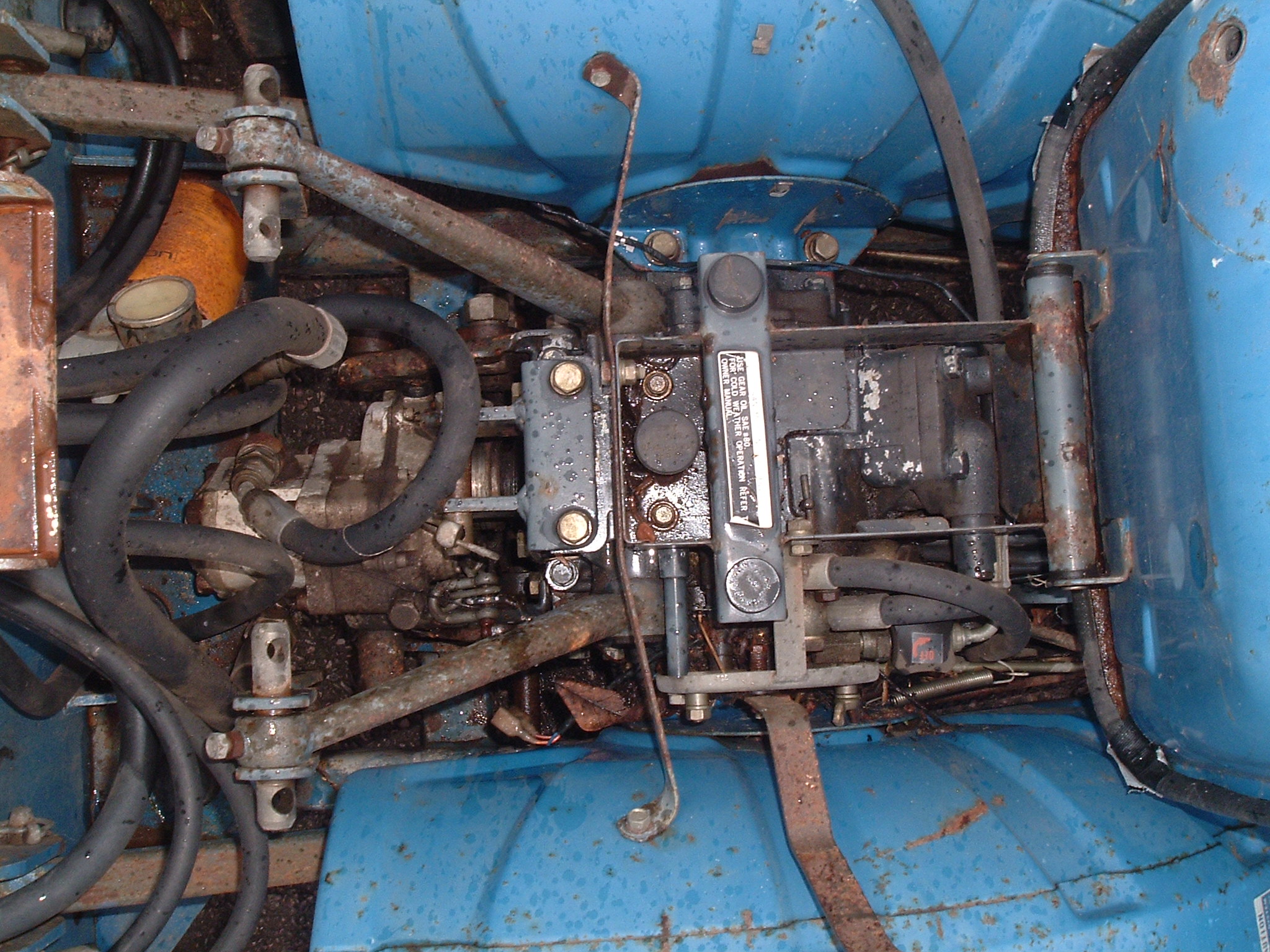

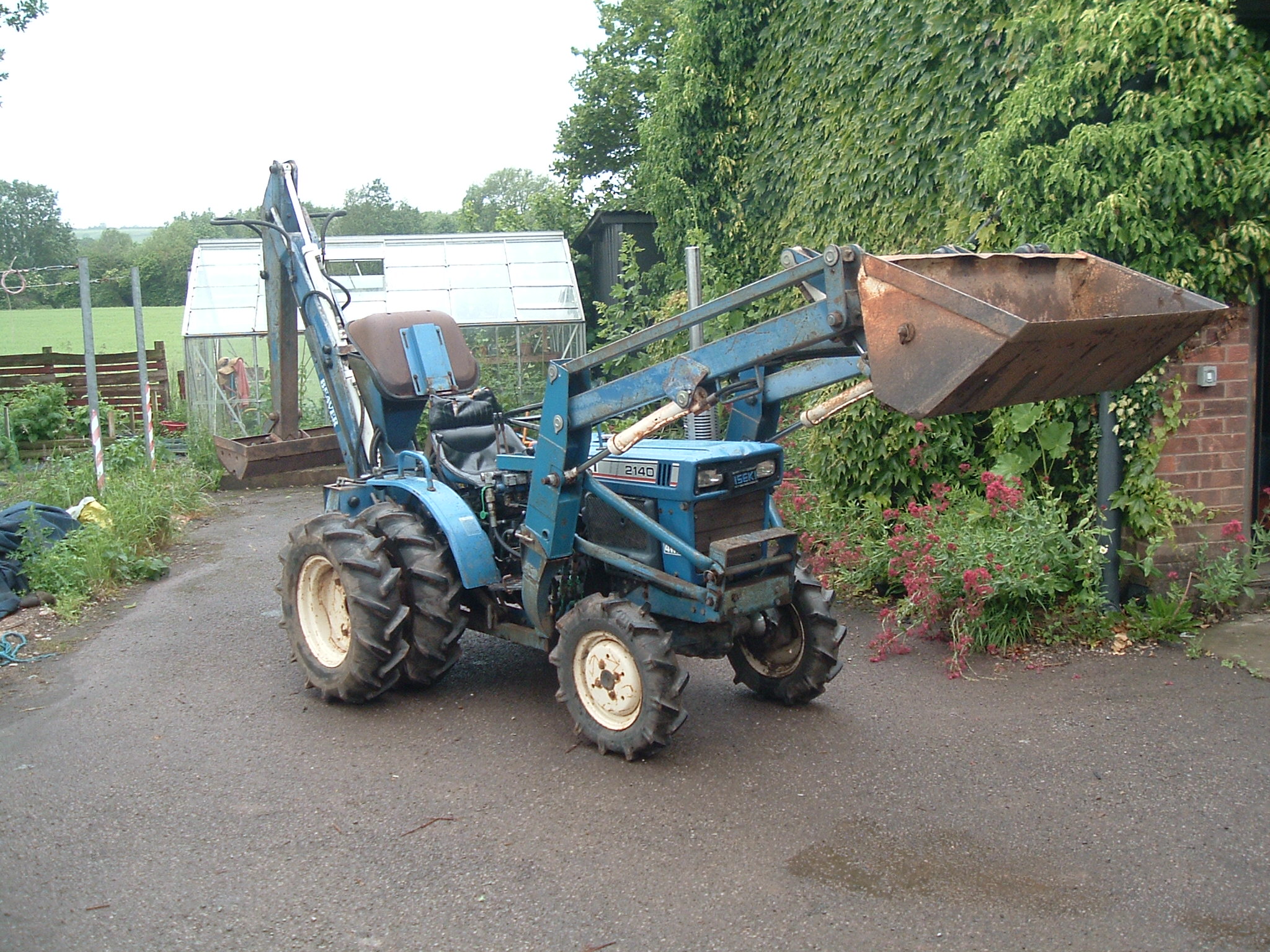

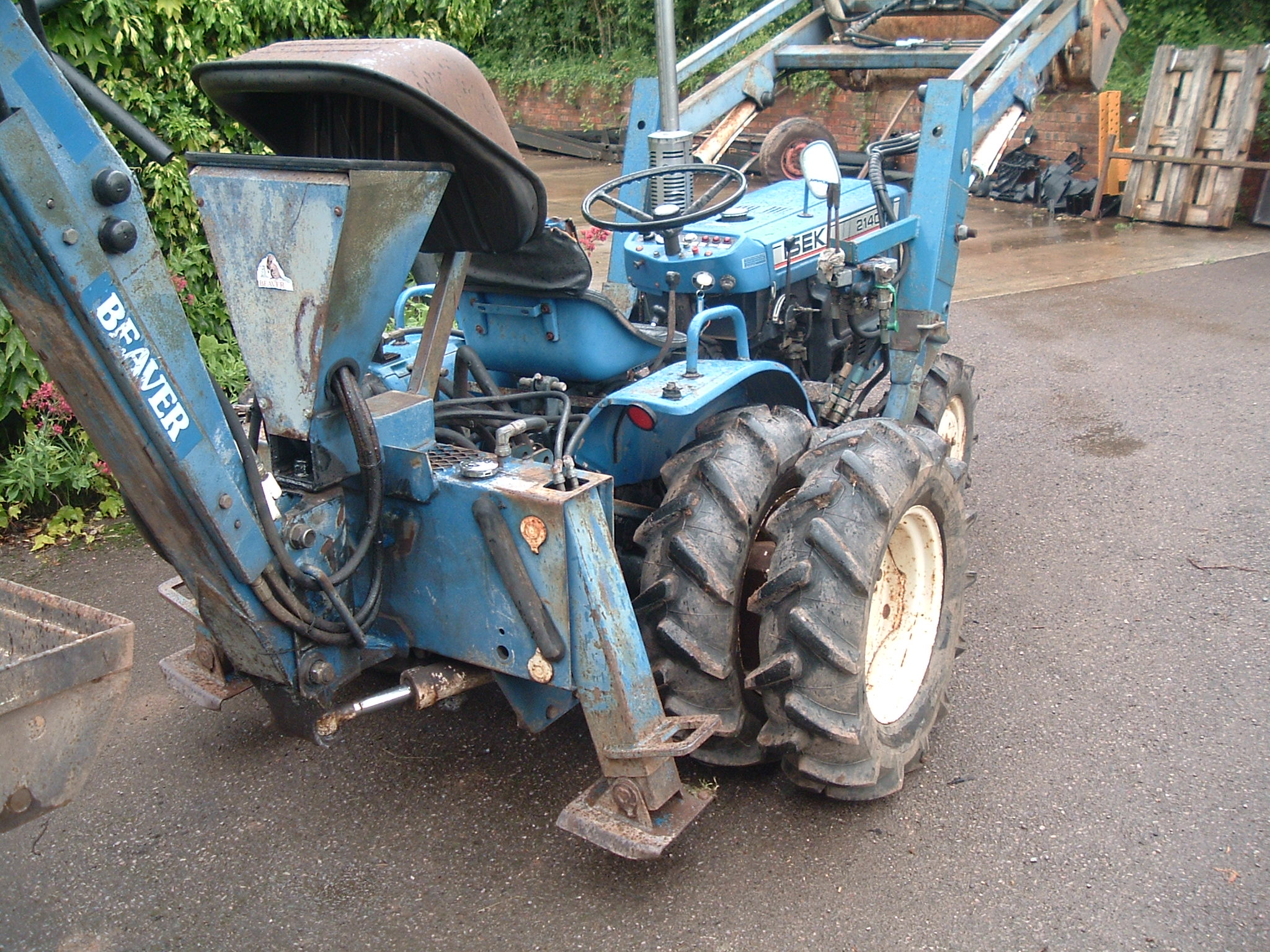

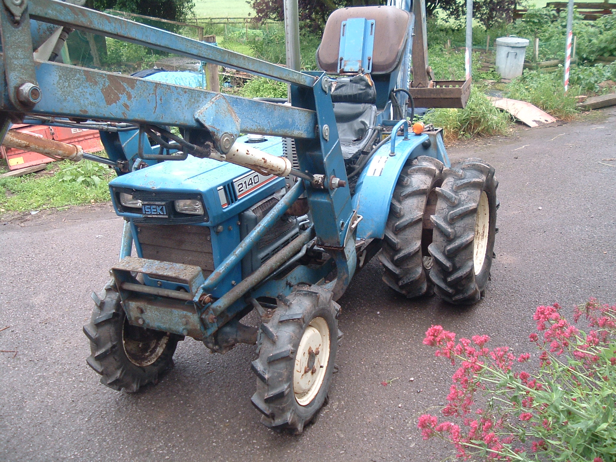

Thank you so much for posting the photos! That is a great looking tractor! I really like the dual wheels on the rear. I knew that they could be set up this way, however I have never seen a TX with the dual rears installed. The fel set up is good to see as well. Thanks for the photos, including the hydraulic photo from under the seat! I did quite a bit of reading in the service manual, and I was not able to find anything specific to the loader, however there were several pages coving the hydraulics. It did suggest that there is a hydraulic bleed screw under the seat, as noted in the diagram below. That may be the issue. You may want to bleed your hydraulic system, it is possible that you have air in the system causing it to run slowly. I also added a few pages from the service manual on regular service that may be helpful as well. I hope this helps a bit. The service manual only covered the tractor, and the rotovator. Thanks again for the photos!

As for my rear wheels, I'm not sure about them. The previous owner fitted them as he was frightened of rolling it, though he never added a roll protection bar, strange... They will certainly be a hindrance when using things like Rotavators as you'll be constantly driving over your fresh work.
