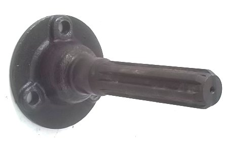

Bit of a quick update on the front PTO. In an earlier post it was suggested that the front PTO diameter is the same size as the rear, which may be 1-3/8. So far I've not had access to the rear PTO shaft due to the back hoe. However last weekend I modified the front framework to give me clear access to the front PTO shaft, this work has now clearly established the outside diameter to be 1" (25.4mm).
So far I've not found any adaptors for such a small pto shaft, so may have to remove the existing shaft and machine another to fit.

I do know of an adapter that I think will work. I think that this one should fit perfectly. It is located in the UK. Ferguson Tractor T20 PTO Adapter Sleeve | eBay good to know, I always thought the front PTO was the same size. They sell these adapters here as well, and I may have to try one. Take care!

The MF sleeve is too big as its for an inch and one eight (1-1/8") where as our shaft is one inch (1"). The shaft is quite simple as shown below
So using an adaptor pto shaft with a more common sized spline I'll machine up a complete new shaft, or at least that's the plan today, just have to see what else I find to convert the size easily.
