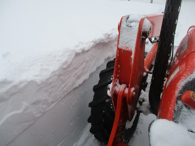

How much weight do you have total with the loaded rears? I'm still trying to figure out what the magic weight/width ratio for snowblowers is. Another thread seemed to say you want at least 5 PTO HP / foot of snowblower width.
Each snowfall normally isn't enormous, its the drift that happens that really closes the driveway. I honestly couldn't tell you how much I get, but I'll attach pictures of one of the worst days last winter. GRANTED, this is the result of plowing for 2+ months and creating berms which just aggravate the drifting issue.
Tractor weighs around 8500lb with loader and 78" HD bucket + weight of snow blower. More than heavy enough for 78", others near me run an 84" on same size of tractor. The 84" usually are taller and bigger fan, might move more snow and take more power, but they were way more money when I priced. (50% more)
You can carry the blower off the ground to put all weight on the drive wheels until final clean up/
I ran a different 78" on a much smaller 38 PTO HP 2wd with no chains with minimal complaints.
64 PTO HP plays with 78" I usually end up pushing snow with the blower without tractor lugging down.
For what you are picturing worst day with drifts, I'd have no issue with my set up. 3-4 foot tall drifts for long distances do require some extra work to open up first pass.

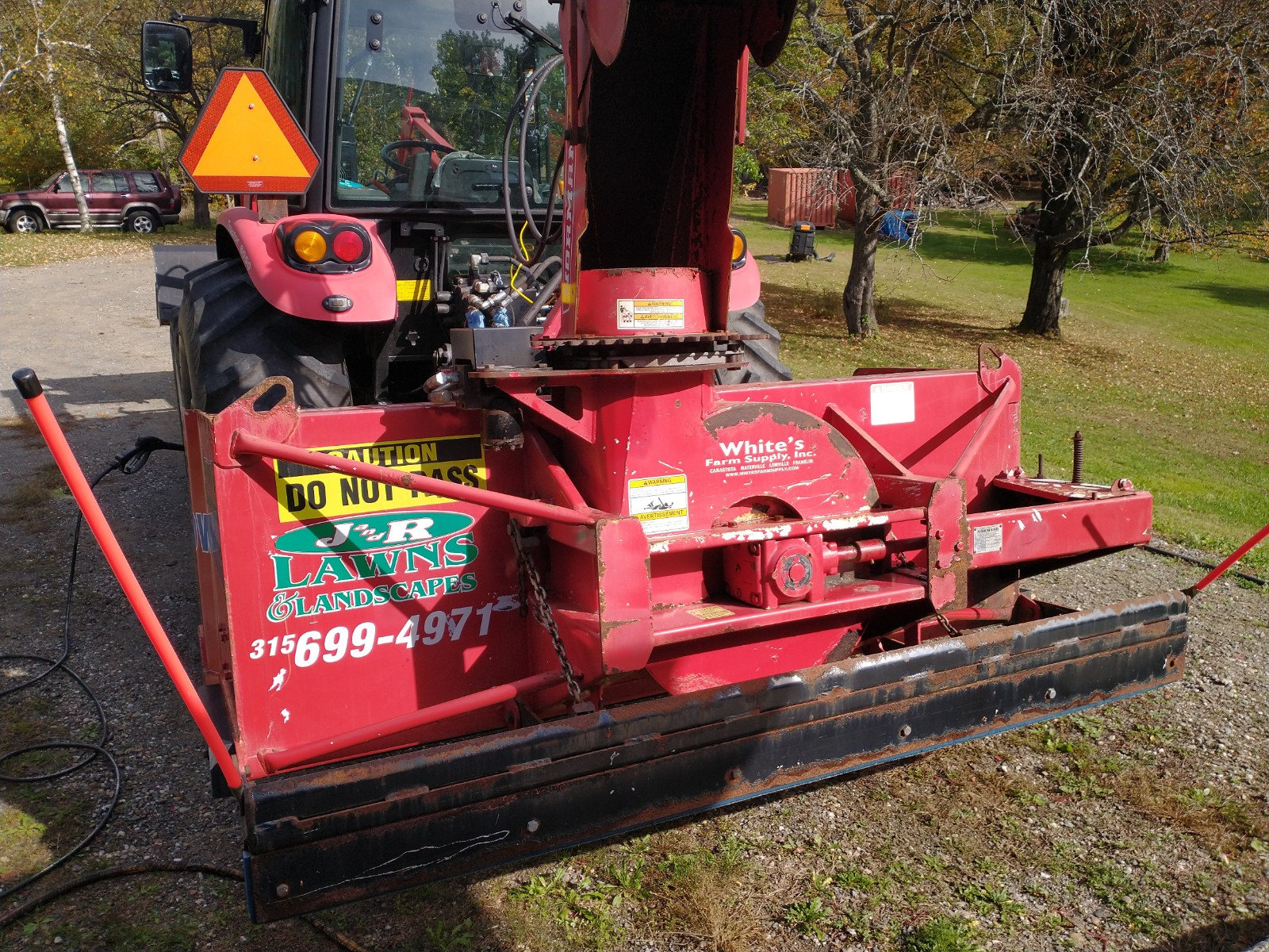

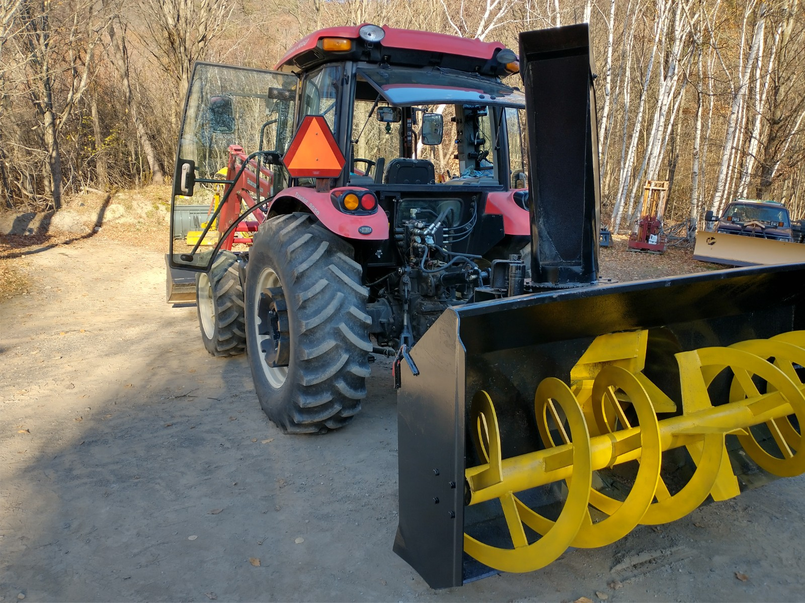

I have two blowers they are both just a bit wider then the tractors.
I like both blowers, the inverted works quite well on 20" or less more then 24" I would be concerned about riding up then digging a hole and high centering the tractor. A person could easily back up into a deep drift 5-6 feet then pull ahead.

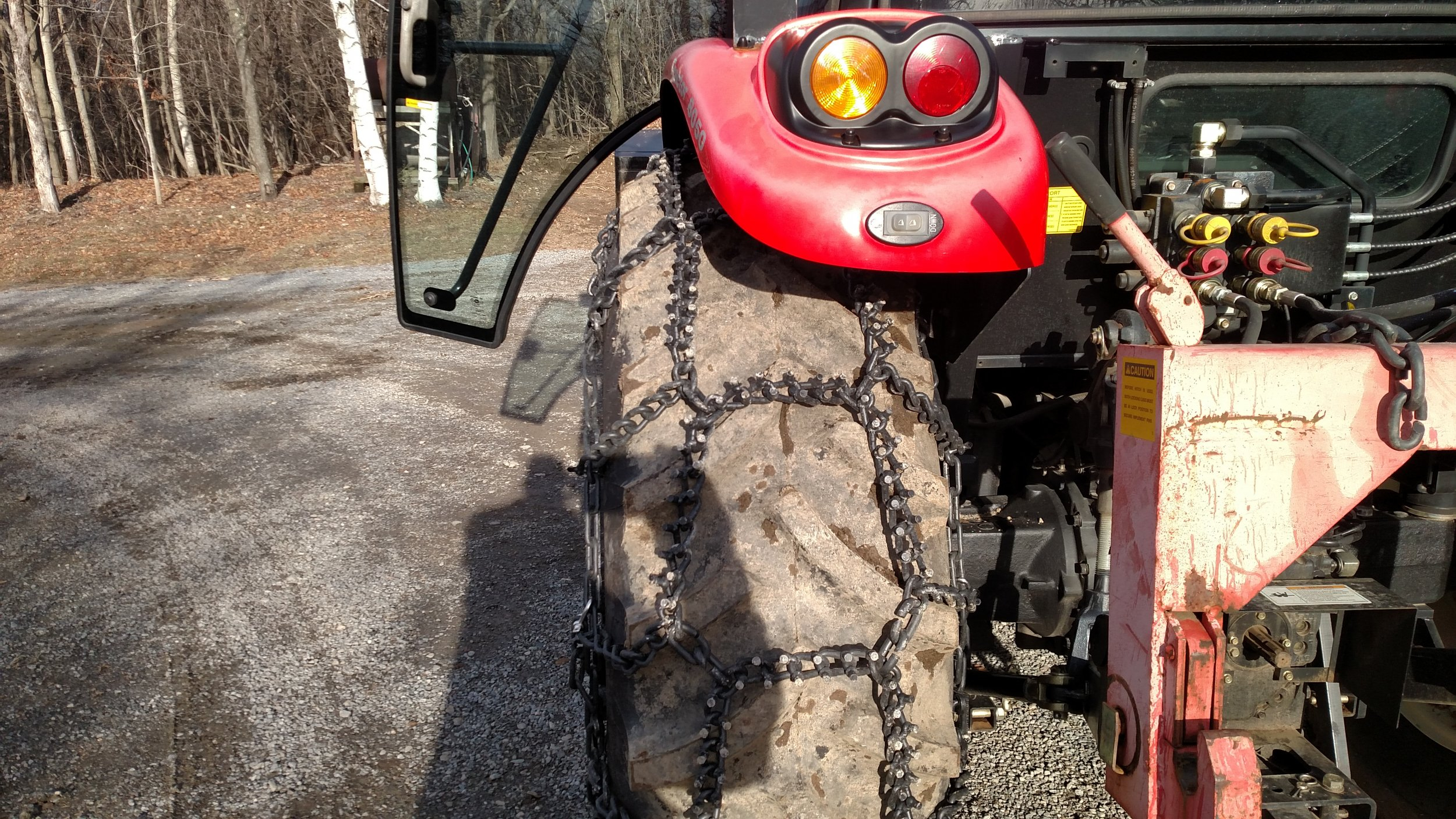

I do run chains all of the time in the winter.
What is your rear facing snowblower? It looks nice
   / pto snowblower size? #25
I have no idea what the brand is it's quite heavy and tall, it was old and used when I bought it.
I think this was the brand not sure I haven't figured it out;
It does seem to be a decently well built unit.

I do run chains on a 2wd loader tractor, they make a huge difference between being tractor useless and useful.

4wd means next to zero need for chains. I do not run chains, loaded rears with cast wheels. I clear several houses plus farm yard every storm.

I never run chains. Have never needed chains on a 4WD tractor. Can't understand why they'd be needed on a driveway. The few times that I've gotten stuck was because I dropped a tire into a ditch or a hole -- chains wouldn't help. And I've always been able to use the loader to push or pull myself out of those situations.
