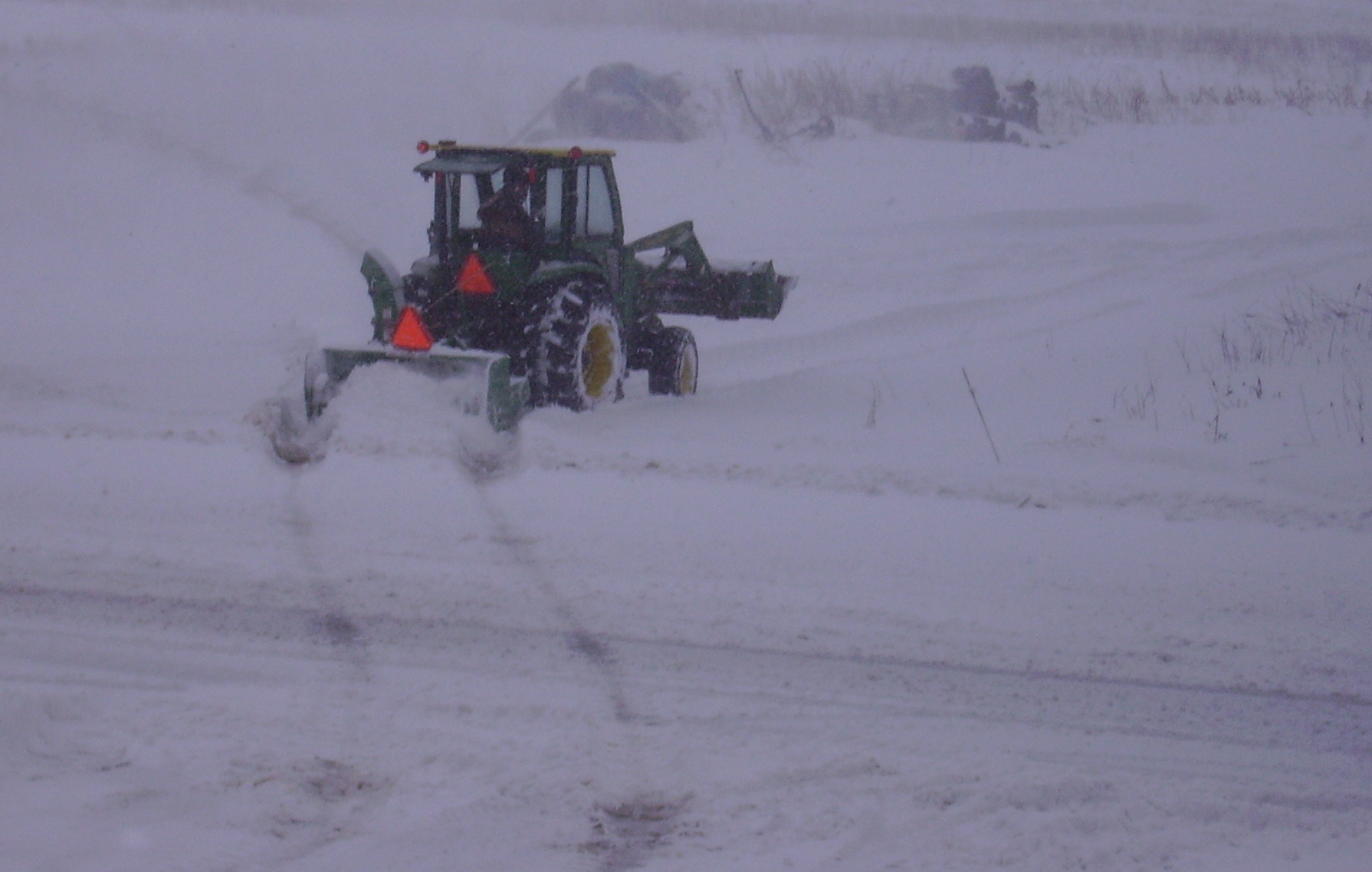

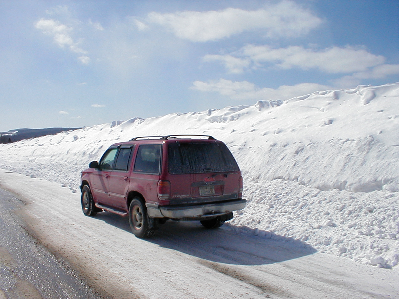

I'm from near Syracuse, NY. We've been known to get some blowing and drifting snow from time to time...
Currently using the only tractor snowblower we've ever owned, a Frontier 1164 on a John Deere 4600. 4WD, forward/reverse transmission, loaded industrial tires (that's what came on it), no chains. 64-inch working width, about the same as the tractor. 100 ft double-wide driveway at the house, longer and wider at the barn. Tractor has more than enough power to run the blower at full capacity. Yeah, we have to make more than one pass, but a blower that's too wide would limit maneuverability. Biggest thing is that we don't wait until it stops snowing to clear the driveway when a big storm is predicted. We'll clean it out as many times as necessary to get us out, or emergency vehicles in, as necessary.
