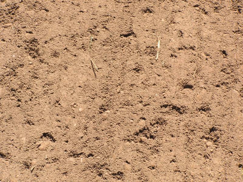

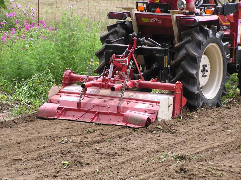

My 2020 has 4 speed PTO. I use it on 2 for the 2nd pass on tiller to pulverize the dirt.
/ PTO speed #10
Same here. Love the way the higher speed along with tine design leave the garden plot worked up.
Here are a couple recent pics, the second is after 2nd pass.
