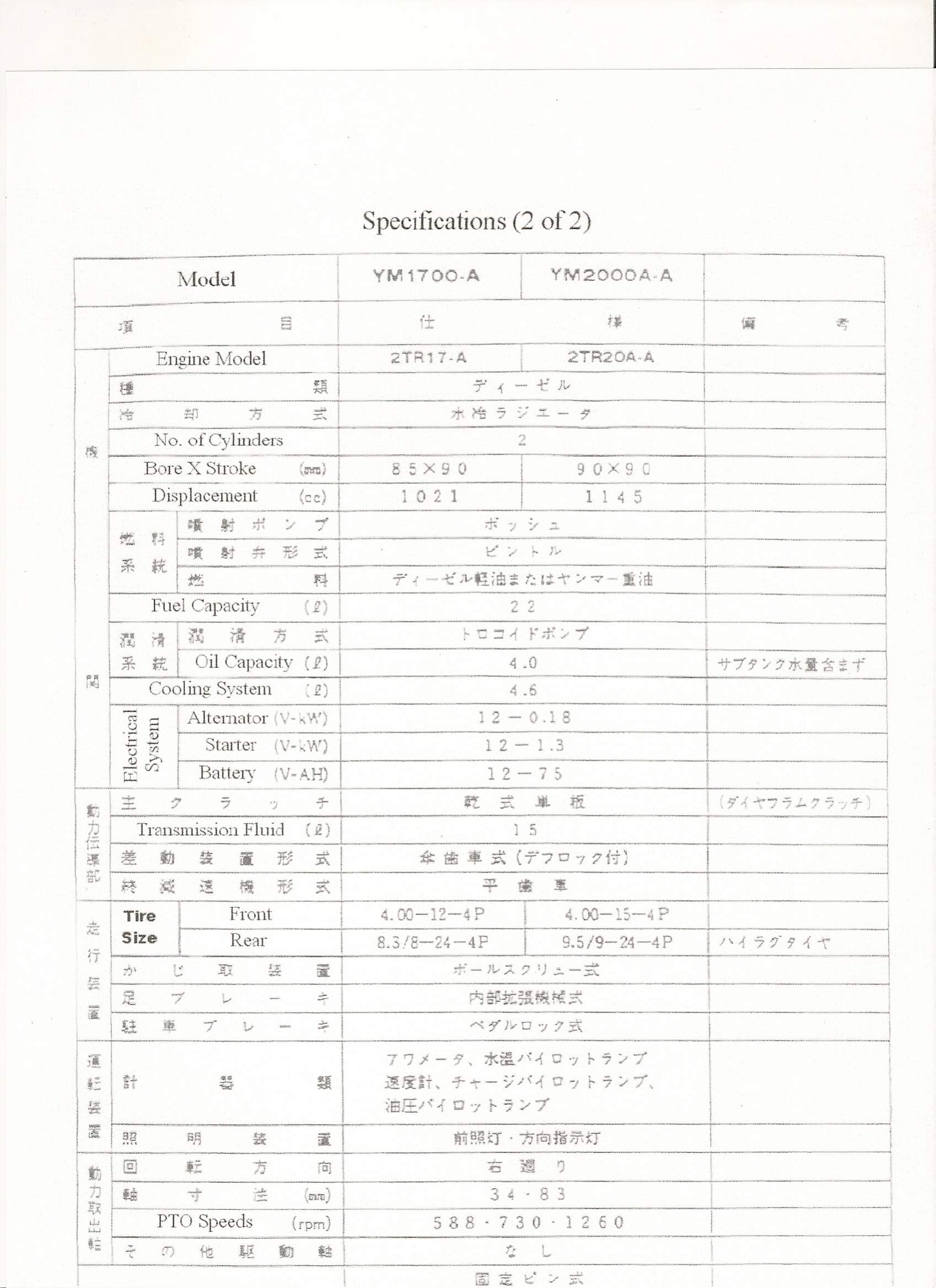

Here is a page out of a 1700/2000 parts manual showing 588,730/1260. I would assume that to be at maximum throttle.
I also have a page out of the 2210 parts manual that is not clear enough to attach here but lists the pto speeds on it as 547,709,929,1232. I would assume that at maximum throttle also.
Not saying these are correct, just saying here it is.

Winston - interesting... I would tend to believe the one in Japanese over the one in English. I'll have to correct my manuals.
/ PTO speeds #9
I found error in my 2002d operational manual in the same area. I bought a little digital tach to check it out. The numbers 284 is showing are correct for my 2002d but not what it shows in my operational manual. My Japanese parts manual reflects the correct numbers.
