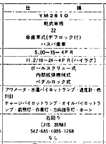

I have owned a Mitsubishi for 15 years or so.
3 speed PTO, 540-710-1000 RPM.
Main PTO usage 4 me is snow blowing with a 3 blade fan 60 rear blower.
I found 540 pathetic* so I have always used the mid PTO range and never looked back. (except when blowing snow, (pun intended))
I did, however, refurbish my blower this last summer and found no adverse damage due to higher RPM usage.
* so much so that the blown snow barely cleared the berms. At 710 the performance was greatly improved.
1000 would have self destructed that poor blower.

Likewise here, I can run the brush mower at PTO speed selector 2 at lower engine RPMs and still arrive at 500 to 540. If the field has gotten a little tall, I bump it up to 600 to 630. The oil in the gear case is still clean and no shavings. That speed levels out at 685, but I wouldn't risk that.

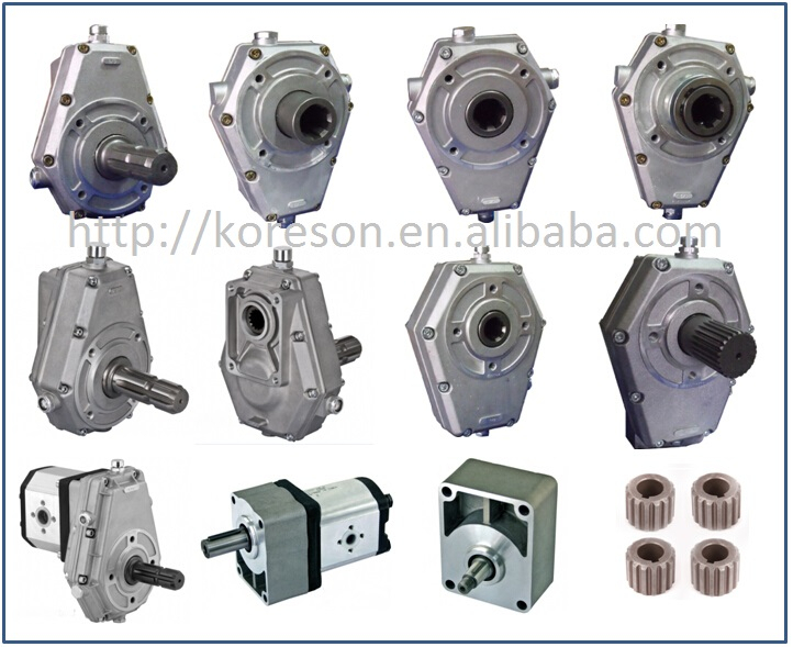

Went looking for the electric powered only PTO device on those Asian tractors. The dumb part is, you can not tell from the back of the machine! So, I then went looking for just the replacement PTO device with the electric drive motor and shaft. ATVs can use the devices too.
Those devices on the picture are just PTO speed increasers to run hydraulic pumps of the tractor PTO shaft.
They increase the 540 RPM at the tractor PTO to somewhere around 1500 to 1800 RPM. Several ratios are offered.
