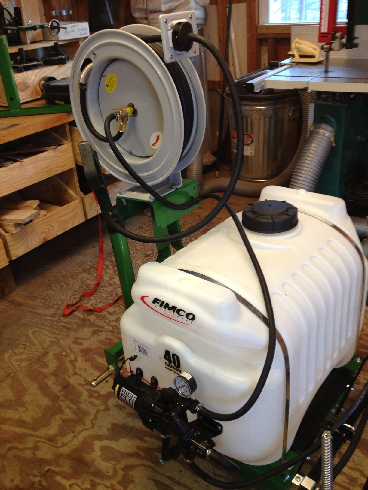

I have a 40 gallon fimco on my 739. It works well for my 2.5 acres. I welded a spring loaded return spool on the top and upgraded the sprayer wand. I love it. Though, I did replace the pump with a better one. Use the wand more than the boom, mainly because I'm spraying weed n feed and have a lot of flower beds that can't be hit. Photo below.
That said, with your acreage and needs, I would think a PTO driven sprayer would give you better performance with less issues. However, as you probably know, the cost is several times that of the fimco.
What motor did you swap out the OEM one with? Surflo?

It was a Northstar NSQ 3 gpm at 60 psi. If you are spraying vegetation killer (roundup type stuff), that is really hard on valves and pumps. Certain classes of pumps are better for that material (like the NSQ series). No matter, you'll have to flush everything clean after every use if you are spraying roundup.

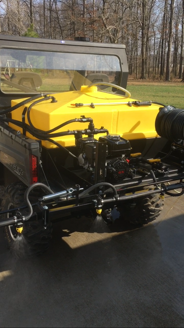

I have a Demco sprayer that I use around my 1/4 mile driveway/house and soybeans and corn. It has worked great for the last three seasons.
   / PTO sprayer or 12v #20
I really like that sprayer....I have never seen that one or the other side by side sprayer someone posted earlier....I paid a lot of money for mine and thought I had looked at all the higher quality side by side sprayer, but obviously not. What type of pump motor do you have on this sprayer? Gas? Electric? How big is the boom? How many gallons is the tank?
