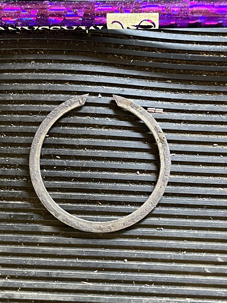

I haven't been able to get the snap ring back on it's in a tight place. Do they make a special tool for them? I get it half way on then it snaps in the grass! :)
Keep trying. My hog has an actual external snap ring with ears that will accept a pair of snap ring pliers. I use ones with the 90⁰ tips.

BTW how can i get this C ring back on? There are usually two holes at the end.

Did the snap ring come from the tractor end of the PTO shaft? If so, be careful the sliding locking mechanism will fall apart and you could lose the balls the lock into the tractor PTO shaft. Get one end of the snap ring into the groove and lock it there with vise grips and then just pry the ring around the shaft, it'll snap right back in.

They make retaining ring pliers made special just for your type of ring. That’s a tough spot to work a ring back on without the right tool. Can be done by working it back into the groove without special pliers if you like puzzles. That spring ring a lot energy and like to fly so be careful. Amazon or eBay.
Had a backhoe pins that used that used heavy retaining rings of that type. After a few times it was worth buying the pliers. Good tool for any mechanics tool box and part of reward for mastering new skills. On the job training. Some auto parts lend speciality tools just not sure if that would be one.
