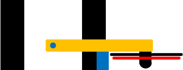

The Dr is the only pto driven weed wacker I see advertise. Can you weed wack close to young fruit trees and not damage them ? You said it fussy on bumps, it scalp lawn on bumps ? I have a small diversion ditch, will it weed wack on angles as it claims ? Did you see it at a dealer before buying ? I am not far at all from your area, so a dealer near by would be worth my time before buying, I hate buying with out seeing. Thanks for your time. TONY
We bought direct (was actually shipped to our dealer as they have a forklift).
It works fine on angles, the bumps/scalps thing is due to how it mounts, here is a picture of how it sits on the tractor:
It pivots on the blue circle and its tire (also blue). If you hit a high or low spot with the tire, it will move the cutter up or down ~twice as much as the bump.
If there is a bump up in the cutting area (but not under the cutting head) it is liable to scalp.
If your trees are young, I wouldn't try to have it "swing back" to cut right around the tree. I snapped off three fenceposts in our pasture last year when I got a little too close with it (they were partly rotten).
I found that our B7500 with the loader off, the throttle about halfway up and the PTO in the 1000 RPM setting worked well. That still had the PTO spinning around 540RPMs, but let the tractor go a little slower and doesn't use as much fuel.
