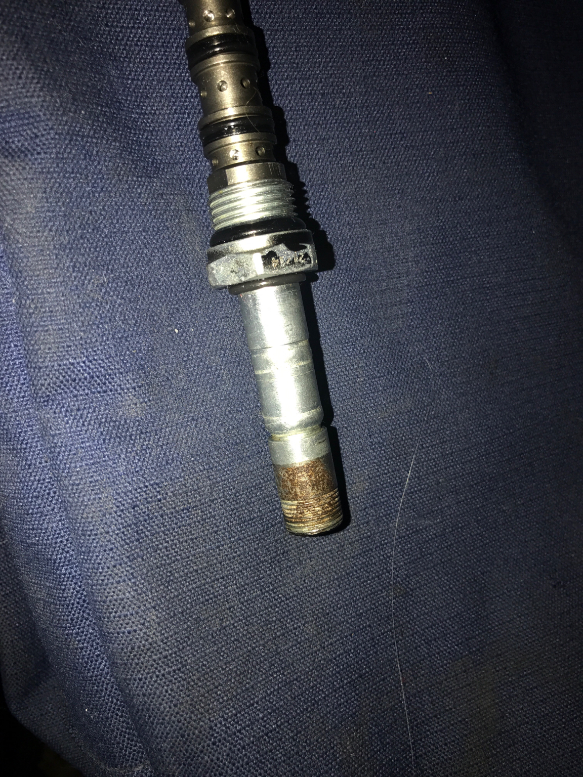

Well that did not work. I ran wires from battery to solenoid it kicked on for a second and died I will call dealer monday

Did any fuse blow?

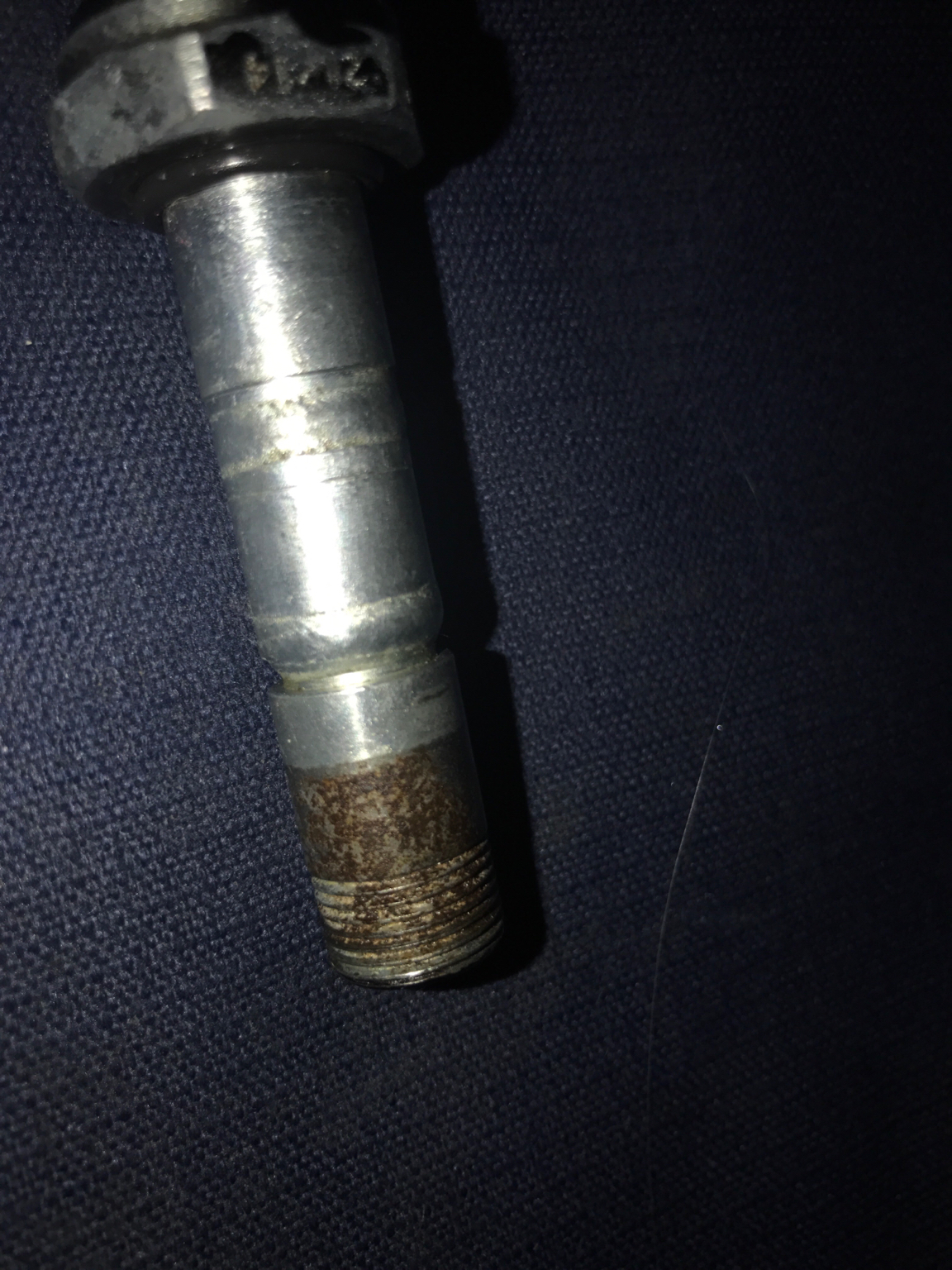

Here are photos of the pto valve that I replaced. Apparently the loose fit of the solenoid on the shaft allows dirt or other debris in and this is the result. Does anyone know how snug the retaining bolt should be behind the solenoid. IMG_2132.JPGIMG_2133.JPG
Only evidence of a short in the solenoid was a small bump on the plastic cover.
The replacement valve shank is smooth and shinny.
FYI, when you order the new solenoid, it comes with a new valve. $140ish as I recall.

   / pto will not engage ls xr4145hc 26 hours #18
Here are photos of the pto valve that I replaced. Apparently the loose fit of the solenoid on the shaft allows dirt or other debris in and this is the result. Does anyone know how snug the retaining bolt should be behind the solenoid. It should be a nut, not a bolt - Finger tight plus 1/6th of a turn. Not very tight at all really.
Only evidence of a short in the solenoid was a small bump on the plastic cover. That's evidence of 'melting' on the inside.
FYI, when you order the new solenoid, it comes with a new valve. $140ish as I recall. Seems reasonably inexpensive for both as a combo.
Some thoughts above in red.
   / pto will not engage ls xr4145hc 26 hours #19
No there was none in. I sent power straight to solenoid it engaged then stoped
The implication is that you have two faults.
1.A fuse blows in the loom when the solenoid isn't even connected.
And
2.The solenoid won't maintain the 'pull' when it's fed direct power anyway. (Or the valve is not actuating).
Even if you replace the solenoid/valve combo as Danger did, you will still have a short-circuit in the loom to find.
