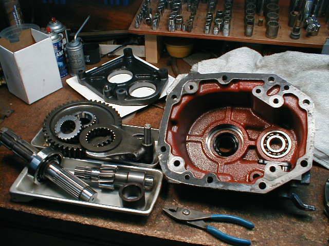

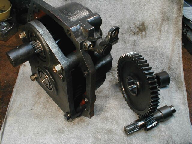

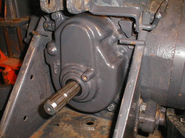

The M4030SU's pto is all mechanical - no solenoids, no hydraulics. The M4030 has 2 hand levers for the pto. It has one lever for the clutch plate, and another is a pto shifter. A driveshaft runs from the clutch at the engine to a gearbox at the back end of the tractor. This gearbox reduces the rpm to pto speed, and also has a shifter to engage/disengage the pto. On some models the gearbox has 2-speeds, but on a M4030 it is single-speed, with a neutral position.
First check the hand lever linkage for the clutch - maybe it's bent and keeping the clutch disengaged. Then check the linkage to the rear gearbox - make sure it is not bent or disconnected. There is shaft going into the box at the top left side, looking from the back, that moves the shifter inside. If necessary, disconnect the outside rod and exercise the lever with vise grips etc. Try turning the pto shaft by hand. Shifted one way it is free and should turn easily, shifted the other it will be connected to the pto driveshaft, clutch, etc. and should turn harder.
BTW, the indicator light switch is just on the linkage - it doesn't actually sense the engagement inside the rear gearbox. One other point, there are no shear pins etc. If the pto clutch and rear box are engaged and it still doesn't turn, then the problem is inside and more involved. Let us know what you find.
Pics are a rear pto gearbox for another model - the M4030's box is very similar except it has an oil filler plug and a flat top.

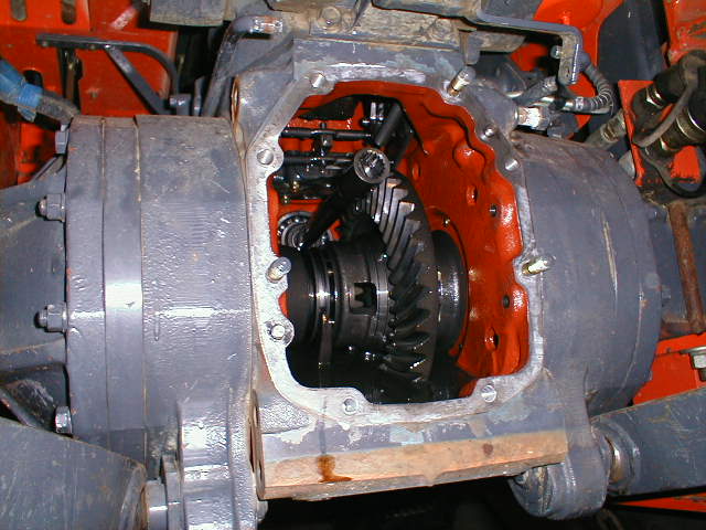

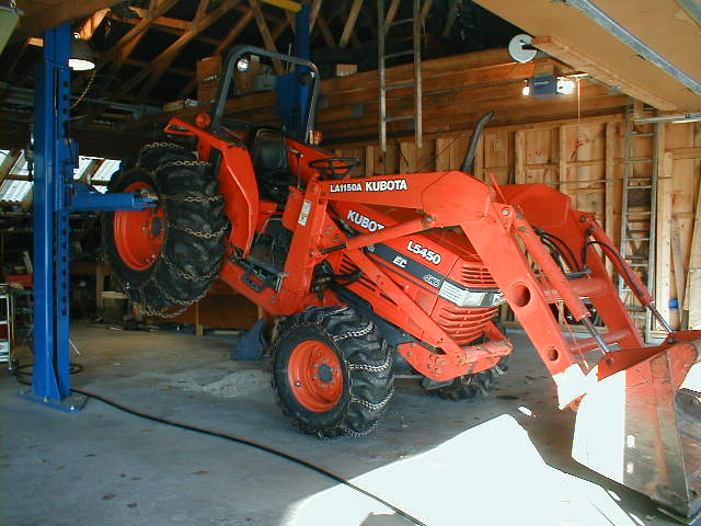

It may be rust-frozen in its hole from years of not being used - put some penetrating oil on it - try tapping the end of the shaft with a hammer a little. Eventually it should turn. The rod should move back and forth about 3/4".
If it absolutely refuses to move there's something wrong inside the pto gearbox and it will have to be removed. Drain the transmission oil (may fill two 5-gallon cans) and unbolt the gearbox. After the bolts are out it still needs some work with a prybar etc to get it off - they use alignment dowels and adhesive on the gasket surface.
The pic below is one of my L5450s with the pto gearbox removed - I raised the back end of the tractor on a lift (pto about 54" off the floor). That pools the oil forward so the job can be done without draining.
Good luck and let us know how it goes. Dick B

If I go into the pto gearbox and the problem turns out to be the clutch can I get to it from there or do I still have to split the tractor?
