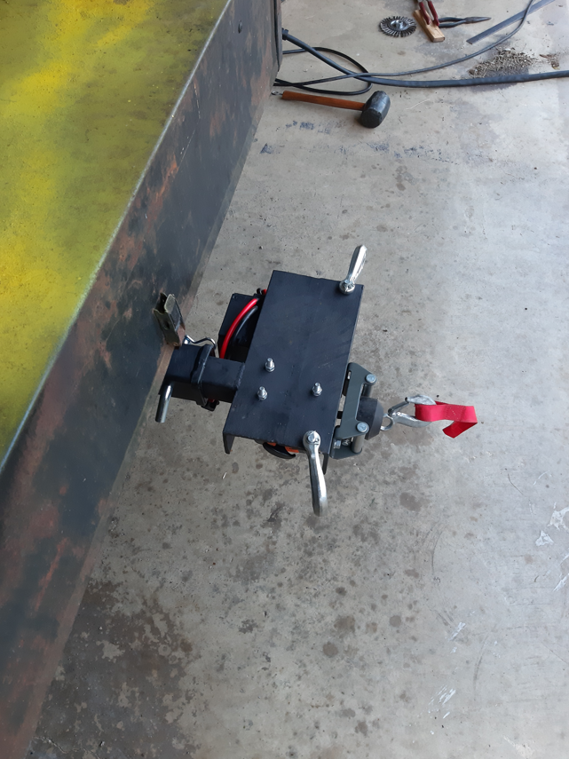

Separately from your questions, today I fabbed up a receiver hitch and custom hitch extension to be able to rear mount my winch or tow a trailer. the front receiver was a much easier project. you can see that I do not have the electric/hydraulic lift for the bed, would love to find the specs of what is needed there.
custom extension just clears the bed, and the receiver itself just clears the bed's footwell when dumping. of course the bed cannot dump with the extension in place.
extension clears the rear by just over an inch. pay no mind to the upside down winch, i was using it as a trampoline to see if i could get the front tires off the ground.. i could not.

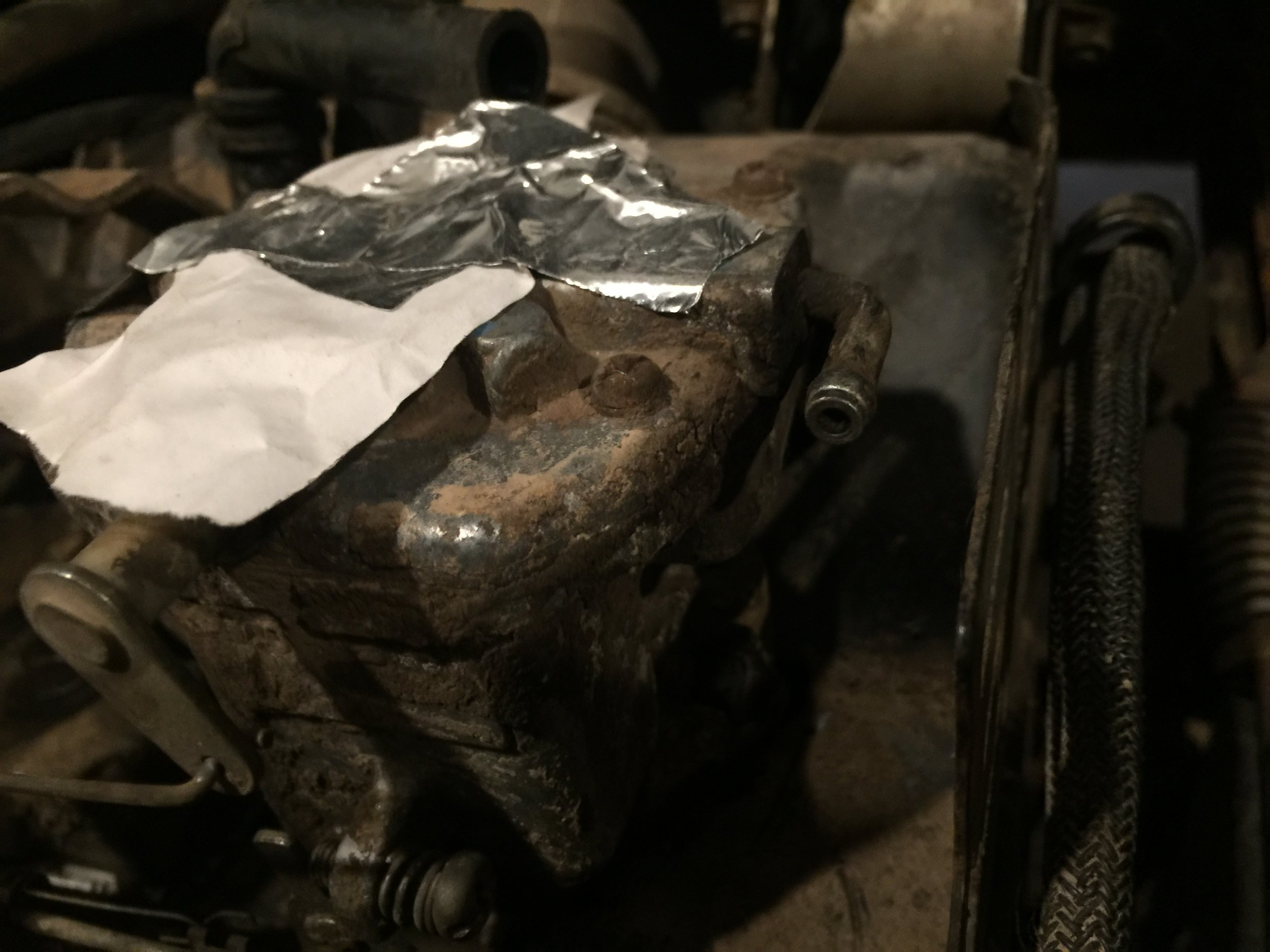

Having trouble w/ mine running...checked out vacuum/pulse fuel pump and based on the tests it is fine.
Problem is when I crank up, it instantly fires up and then dies. On the passenger side looking at the top portion of the carb. there is an inlet for what appear as a vacuum line connection...nothing is connected to it.
Also fuel cap has cork in it but does have cut out section for venting purposes.
Any ideas...might be carb.

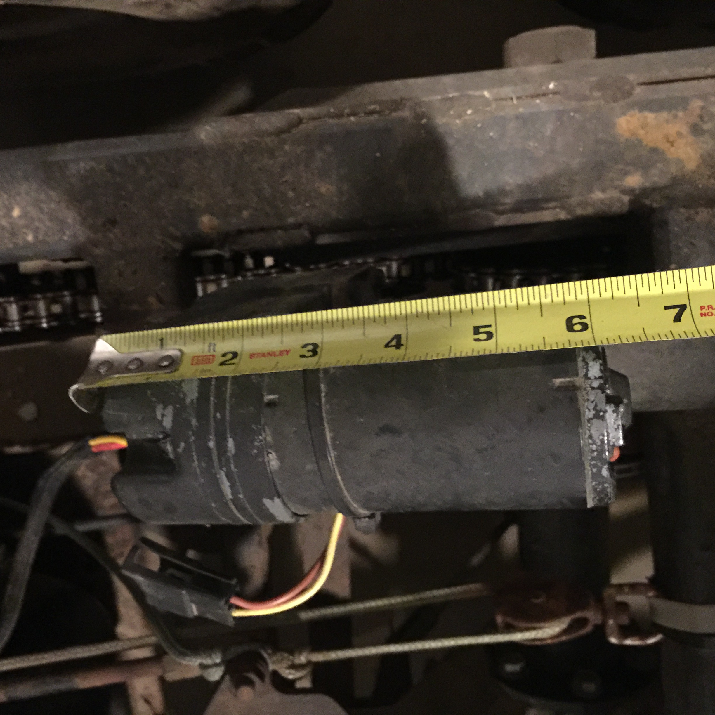

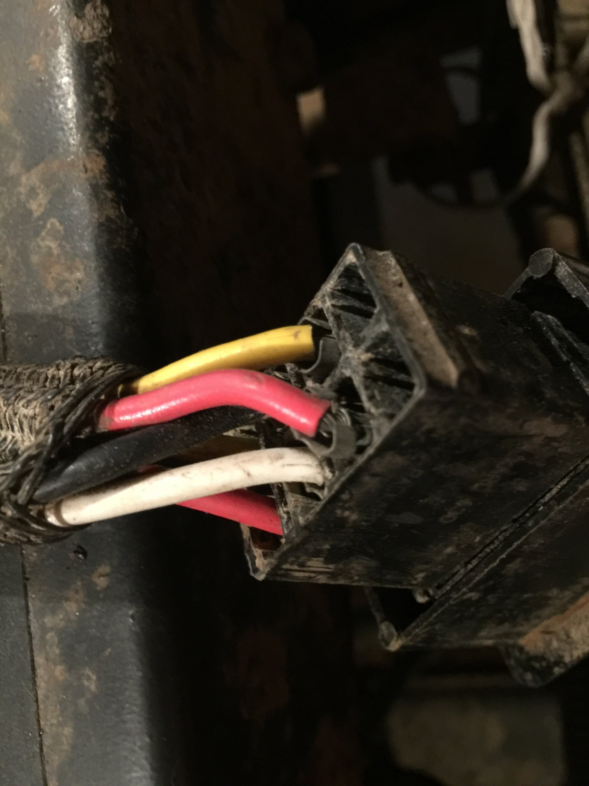

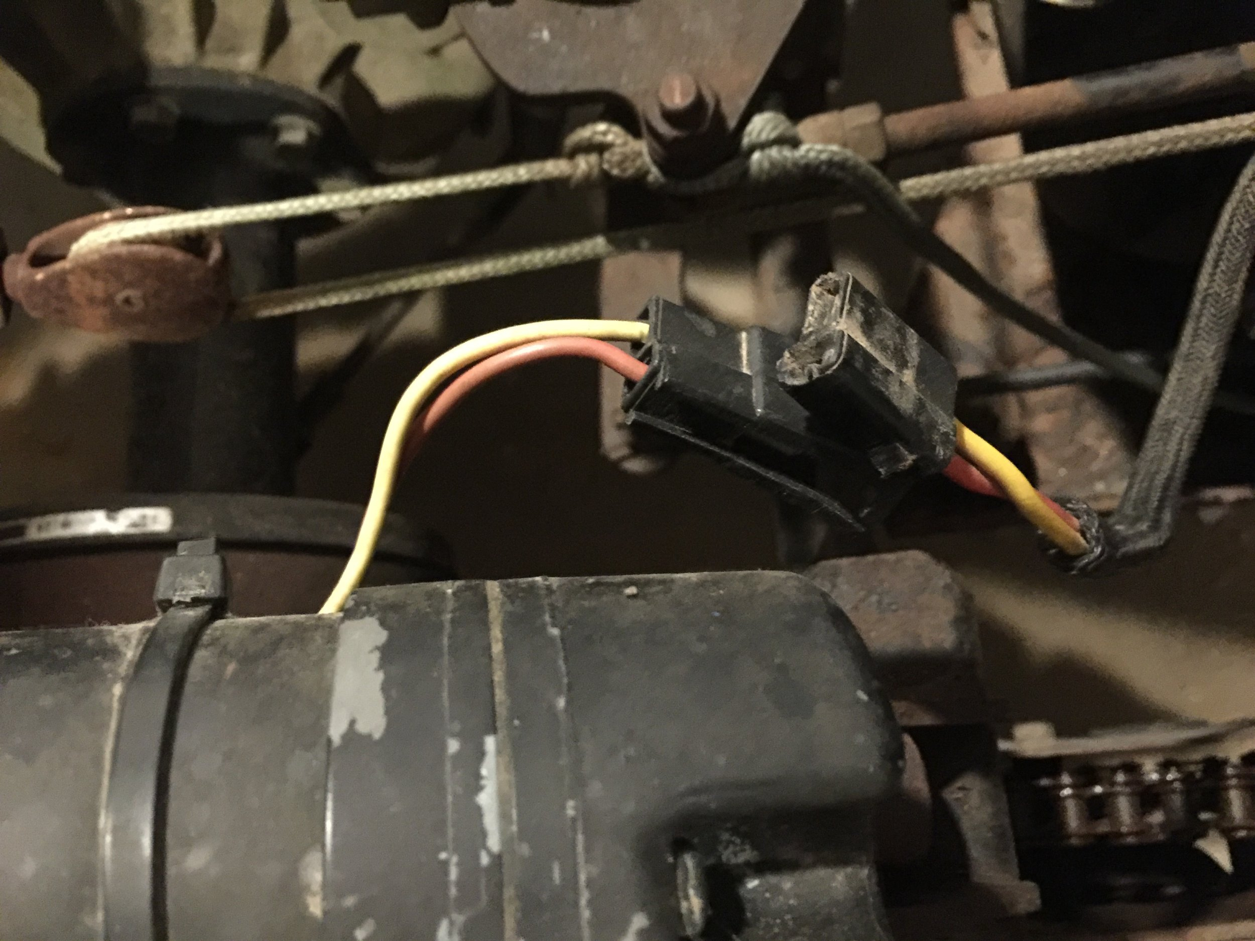

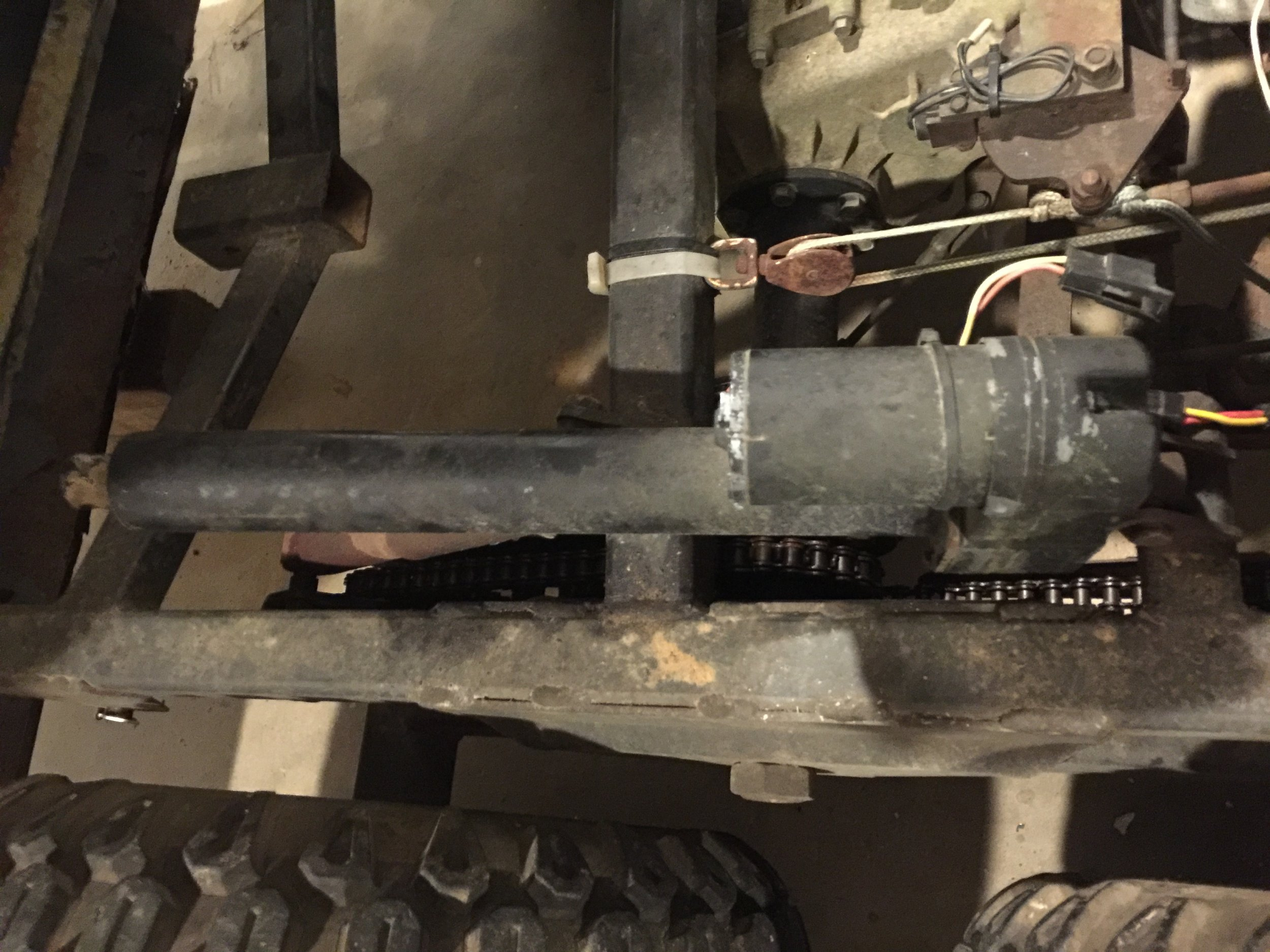

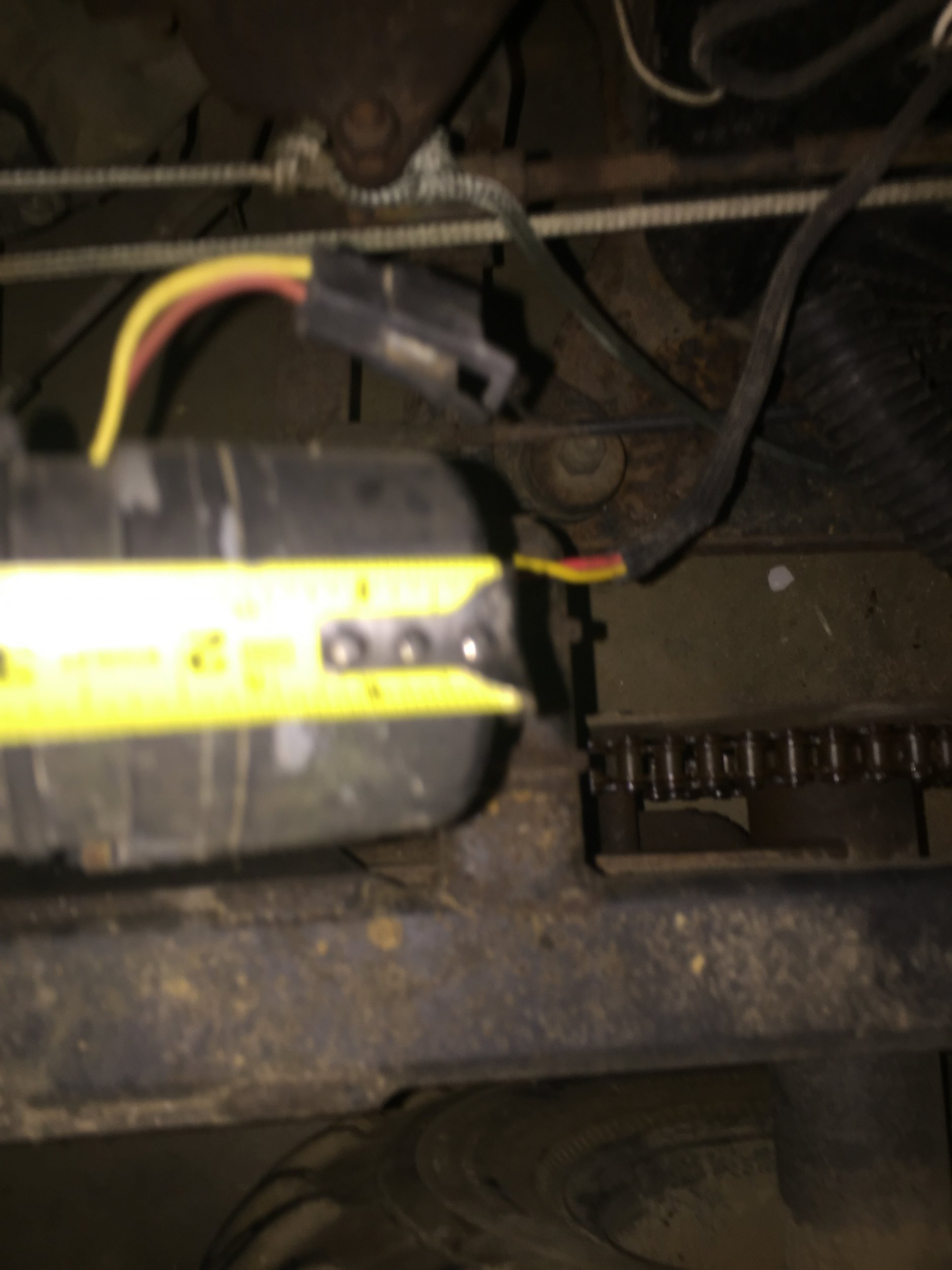

My lift bed extendable tube isn't working; there are 6 wires to the switch and 2 to the arm itself, yellow and red at the latter. How can I test if it's the arm itself or something else?

that line on the carb not having anything connected to it is definitely going to be AN issue. if not in use, it should have been capped to keep dirt out, if in use, it obviously should have been hooked to something. my new carb doesnt have that connection, where it would have been is capped off. IF i had to guess, maybe it is an overflow drain line connection? your carb may pre-date some of the EPA safety changes. my carb sends fuel overflow into the carb throat instead of to the ground via drain line, if the float needle fails to seat. you may need to pull the top off the carb and look for grit, clogs and stuck parts - debris could have gotten in the top of the carb and is causing problems.
their use of cork in the gas cap was a bad idea, it degrades and debris gets sent into the carb. i bought a large fuel resistant rubber washer from ACE and cut it so that the gas cap seals at the rim but doesnt block the tiny air hole in the cap. gas cap is not of the best design, but it works.
from your previous question, in your photo of your carb, the screw in the bottom of that image is your idle adjust, and it looks like the reset spring is in place on the linkage.
dying after crank - i have noted that on mine, if you crank it and then disconnect the battery, it will not continue to run for very long without the battery in the circuit. this could mean many things.. the charging system could be weak, there could be a killswitch relay that grounds the plugs when the battery is removed, or they could have a "faulty" design where the carb fuel shutoff solenoid is operated solely off the battery circuit and not by the charging circuit (which might actually make sense, as the headlights go out immediately when the battery is disconnected despite the engine running for a few seconds). so technically a weak or missing battery could cause it not to continue running - IF mine is operating as designed. And if mine is operating as designed - I dislike that design, as i would want to jumpstart and run my pug with a weak battery instead of being stranded.
you have the 'deluxe' model!! 6 wheels and power dump - nice! mine is a single rear axle, no power dump.. yet.
just guessing on the electric/hydraulic controls, without part numbers to pull diagrams.. looks like any labeling on the lift ram/motor may have been stripped or painted over, that's unfortunate.
IF there is no other connection of ground to the lift motor, then the red and yellow wires on the motor would simply be red = positive, yellow = negative for one direction and reversed polarity for the other direction. This is a guess without part numbers to pull up wiring diagrams, just using knowledge of other similar equipment, mine has none of the wiring for the lift. if the motor could be connected to ground in any other way, do NOT follow these next steps, as it could damage your motor. [obligatory warning:] DO NOT jump a test wire from battery to that connector with the hydraulic ram connected to the bed, one could lose an arm or LIFE. Now that that's out of the way, running wire from battery terminals to the motor's red and yellow leads should operate the motor. use a wire connector for negative lead, and then clips or a gloved hand to just touch the positive lead momentarily to the other lead to see if you get motor movement. if you get motor movement, swap the connections and see if you get reverse movement.
then assuming above test worked..
i have no idea if there are interlocks or other safety or limit switches in the wiring to the lift motor, my guess is not, but that is just a guess. assuming no other disconnects are in the system, that should be a momentary double pole - double throw switch. meaning that of the wires to it, one should always be positive, and one always negative. with the motor disconnected, a volt meter can tell you which wire is constant 12v (likely will have to have the key in the on position). putting the meter in continuity mode will allow to you find which wire is always negative. so then when the switch is depressed one way positive is connected to a certain color (red or yellow), negative to the other, on one end of the switch. pressing the switch the other way would result in a connection on the other side. my guess is that in the wiring harness somewhere, the red wires coming out of that switch tie together, then the same with the yellow wires (or more likely it could be two red/yellow pairings, depending on how the switch is made), and that with the black and white wires, one goes to positive, and one goes to ground [negative]. with the motor and battery disconnected, on the back/bottom of the switch, using a volt meter in continuity mode, put one probe on the black wire and depress the switch in one direction and place the probe on the reds and yellows there to see what the switch connects and doesnt connect. then do the same with the white wire, then repeat black and white wire tests with the switch depressed in the other direction. now you know if the switch is good, and which wire is positive and which is negative depending on which way the switch is depressed.
so if the motor and switch check out..
there could be some other disconnect in the circuit, there could be a relay somewhere that disables power to the lift switch if the engine is not running, or if the key is off, or there could be limit switches on the bed that are stuck.

johnwayne, I removed the top of the carb. and there was alot of crud (looked like disintegrated red gasket seal) in the front side at the bottom. Vacuumed bowl out and cleaned w/ carb. cleaner as well as the needele
valve on top and passages. Put it back together and difference between night and day in running and performance. The open line at top is probably a drain as you mentioned but had alot of cob webs around it...I may cap it off.
I need to get the fuel resistant rubber washer for my fuel cap since it is cork.
I'm not having any problem w/ it dying after starting now since cleaning most of the carb. (wasn't able to remove the lower jet but sprayed what was exposed and used compressed air) so the crud in the bowl was probably
affecting it dying and I also set the idle up a bit.
Haven't been able to determine what's going on w/ the lift motor. There isn't any electrical wire ground but the metal pins that pass through the sleeves on either end, might be some sort of ground...just guessing.
I still connected separate wires dirrectly from the batt. to the lift motor harness w/ still no movement. There was some arc when I touched the alternate wire so must be doing something wrong.
Still working on it so hope to determine what I need to do.

the more i think about it, that top line must be an overflow drain for if the float bowl needle doesnt seat. just put some fuel line on it, and fasten it so that the line cant get caught or pulled into any moving parts, and would empty outside of the frame/skid plate. the length should keep dust and bugs out. capping it could work against the carb.
if it arc'd, the motor of the lift could be seized. no idea if the motor can be removed from the hydraulic piston - in an effort to explore freeing the motor up.
