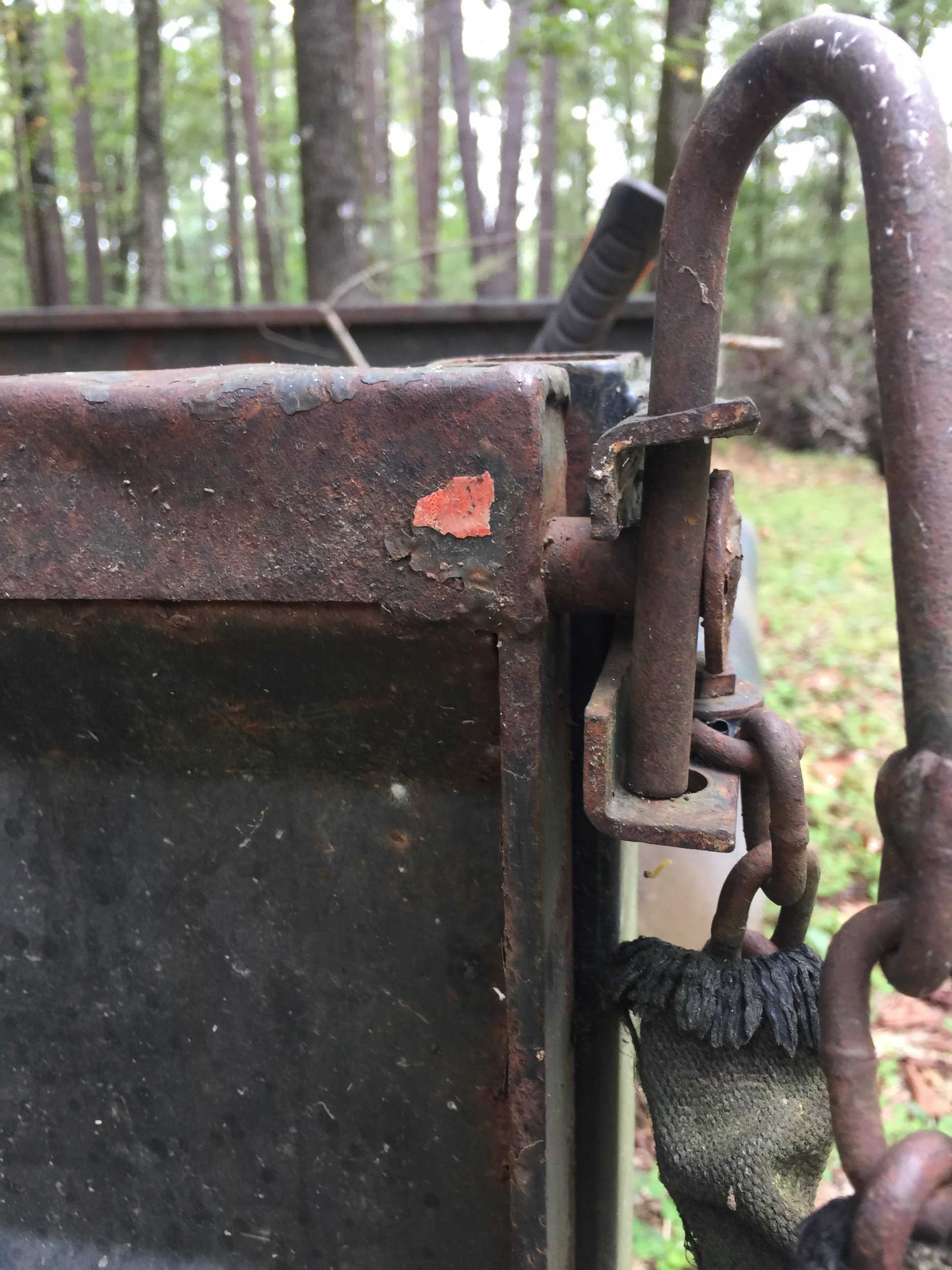

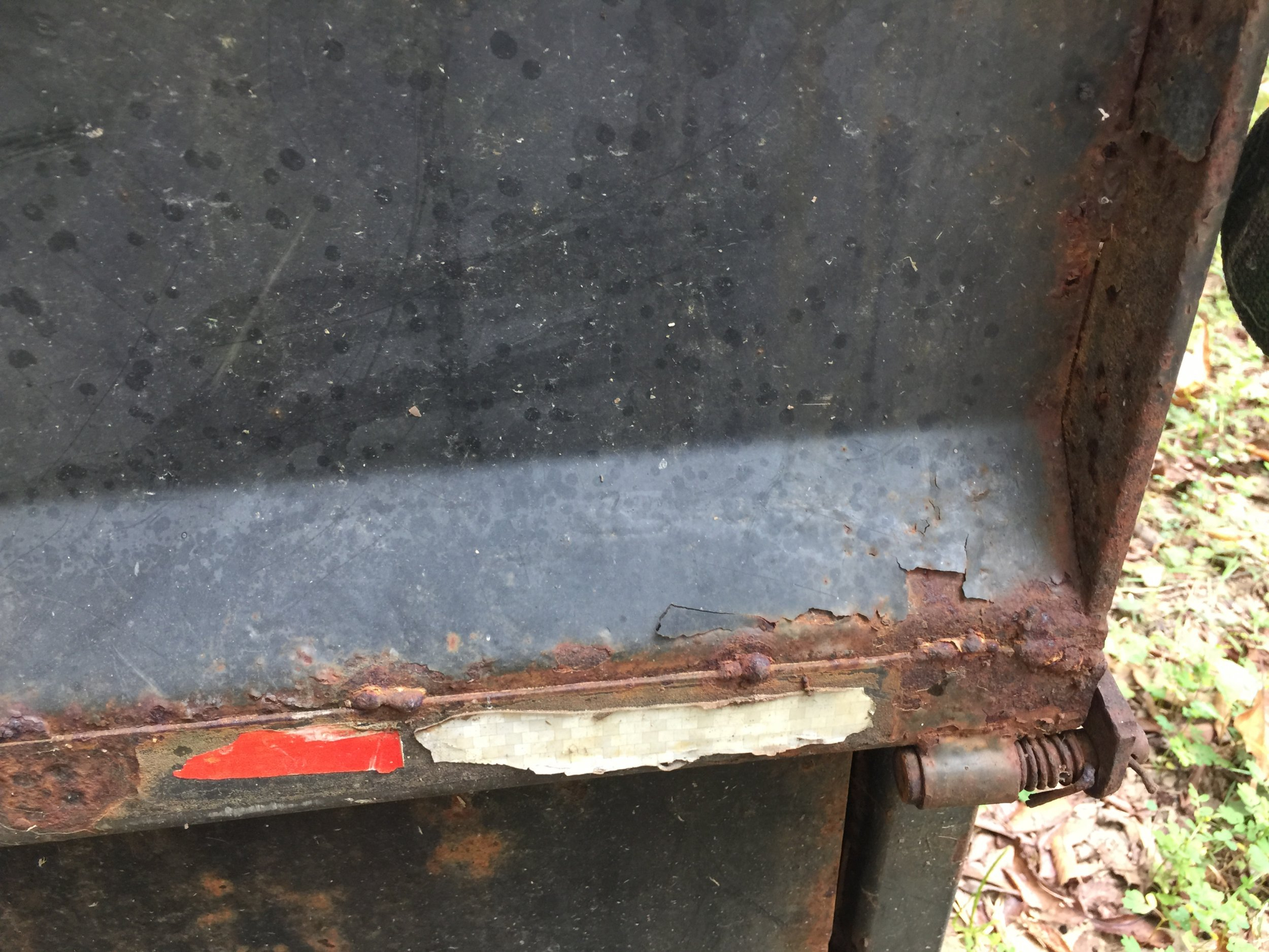

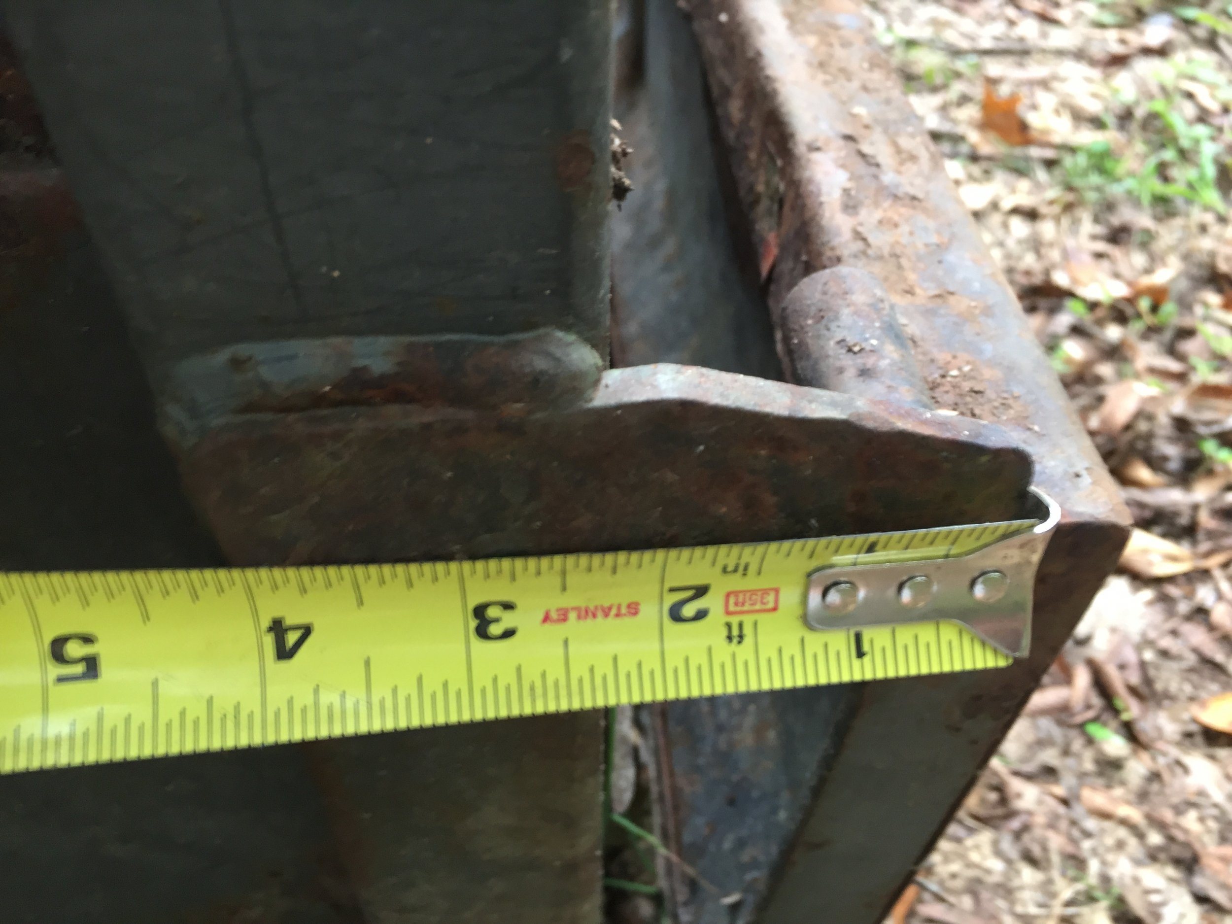

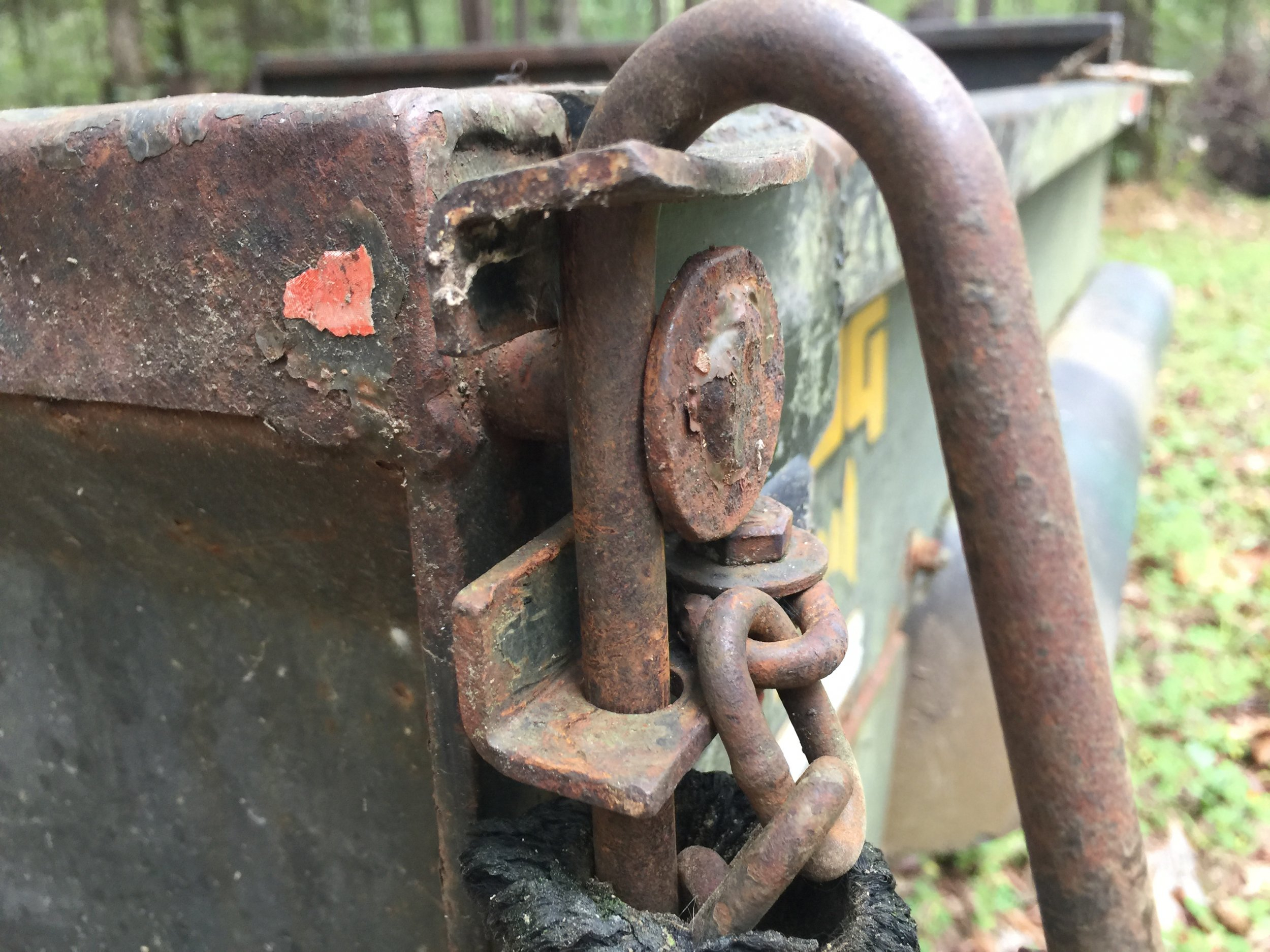

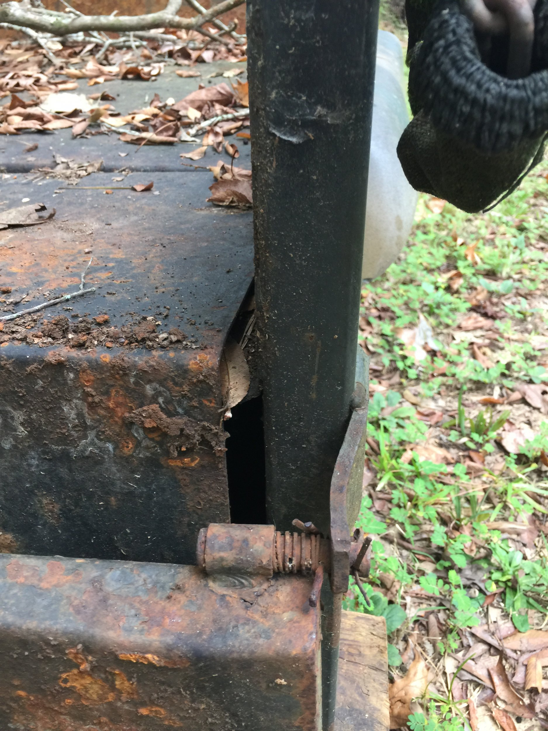

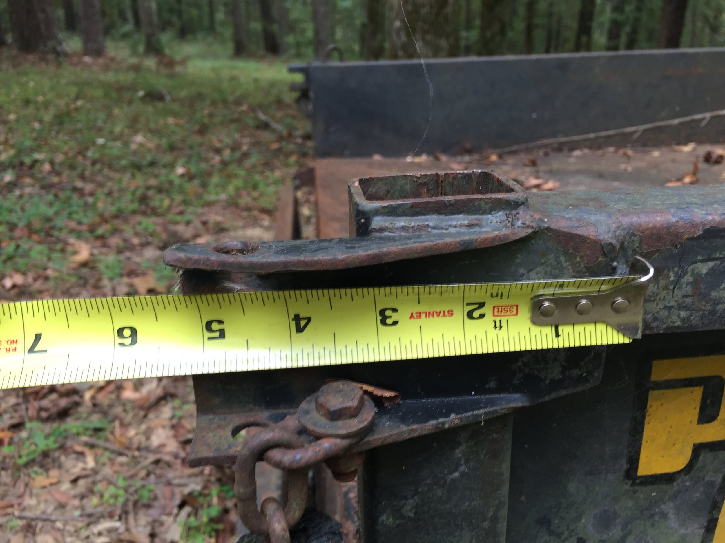

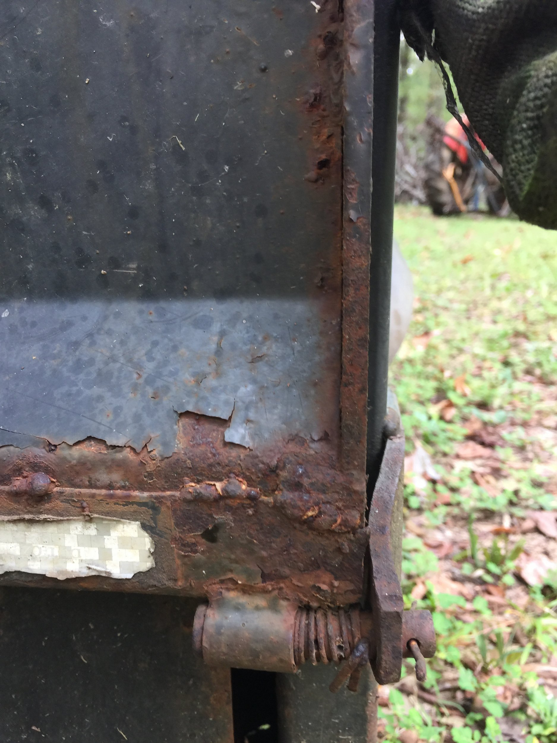

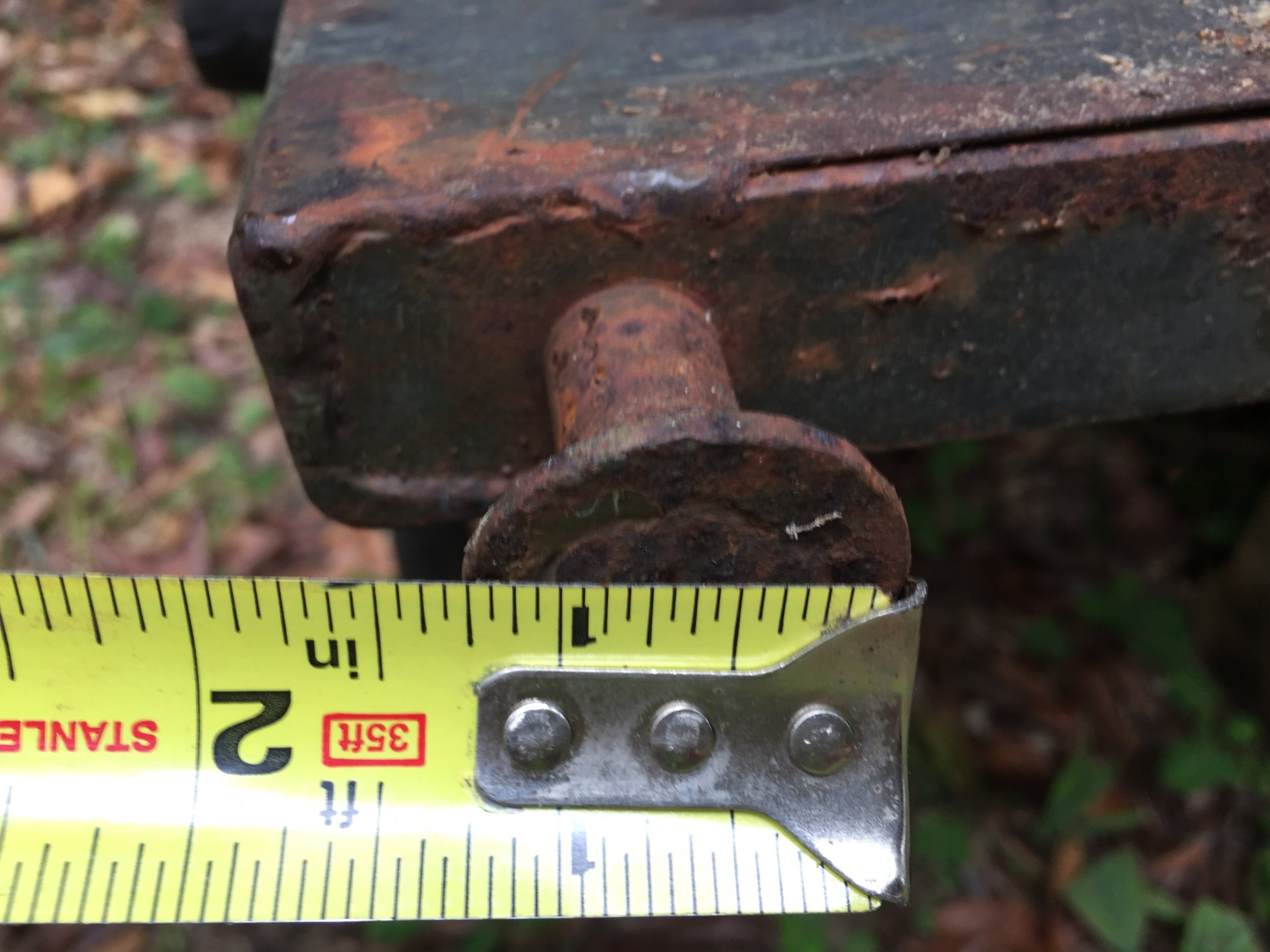

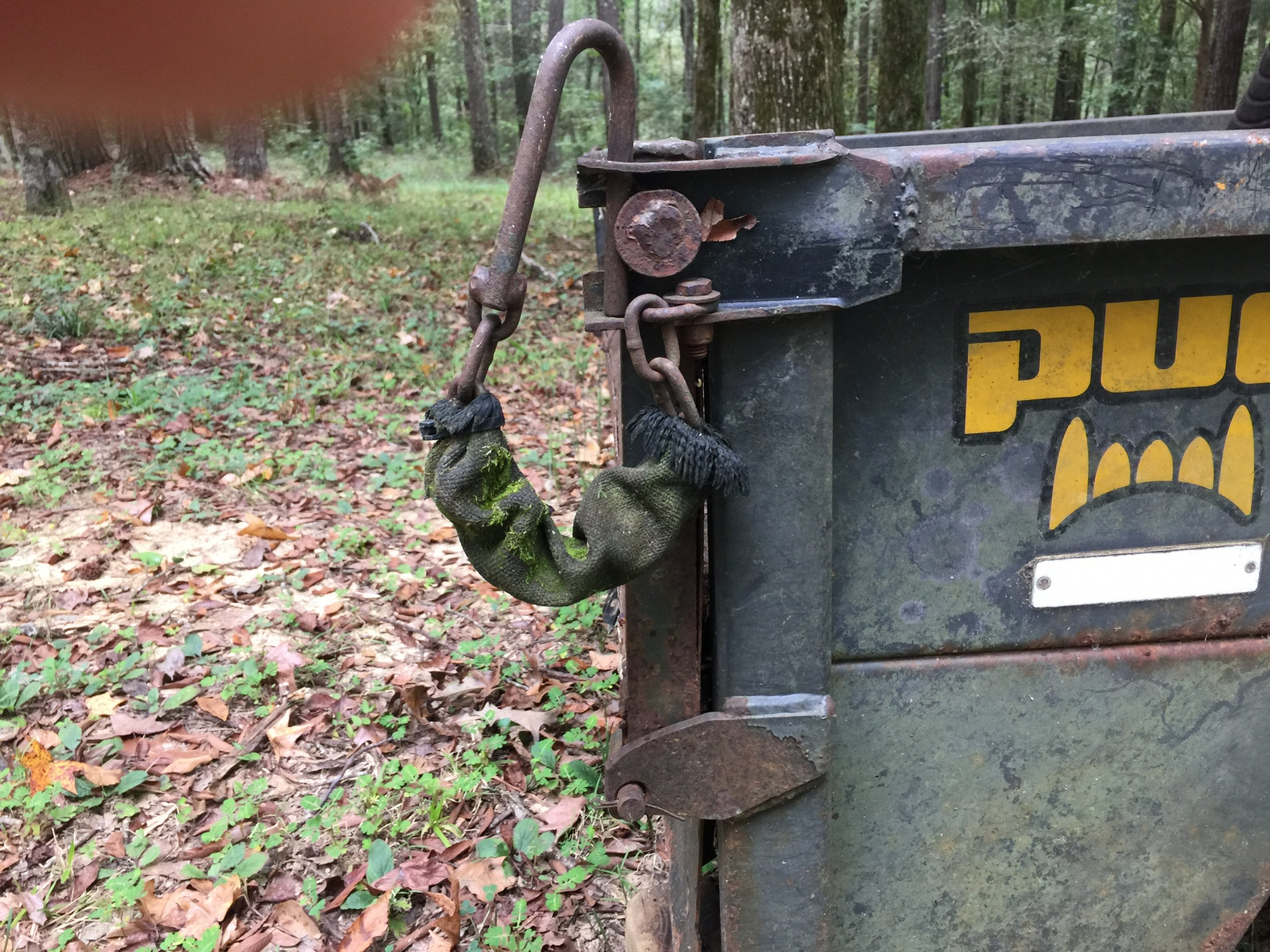

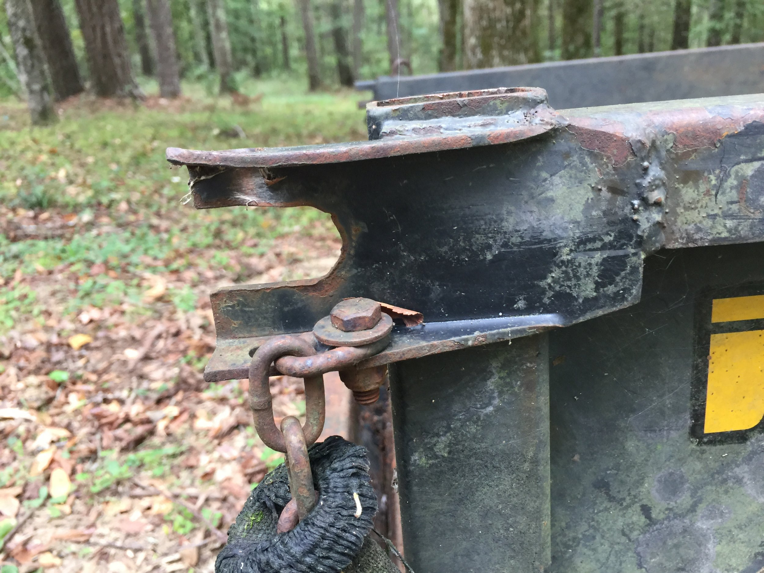

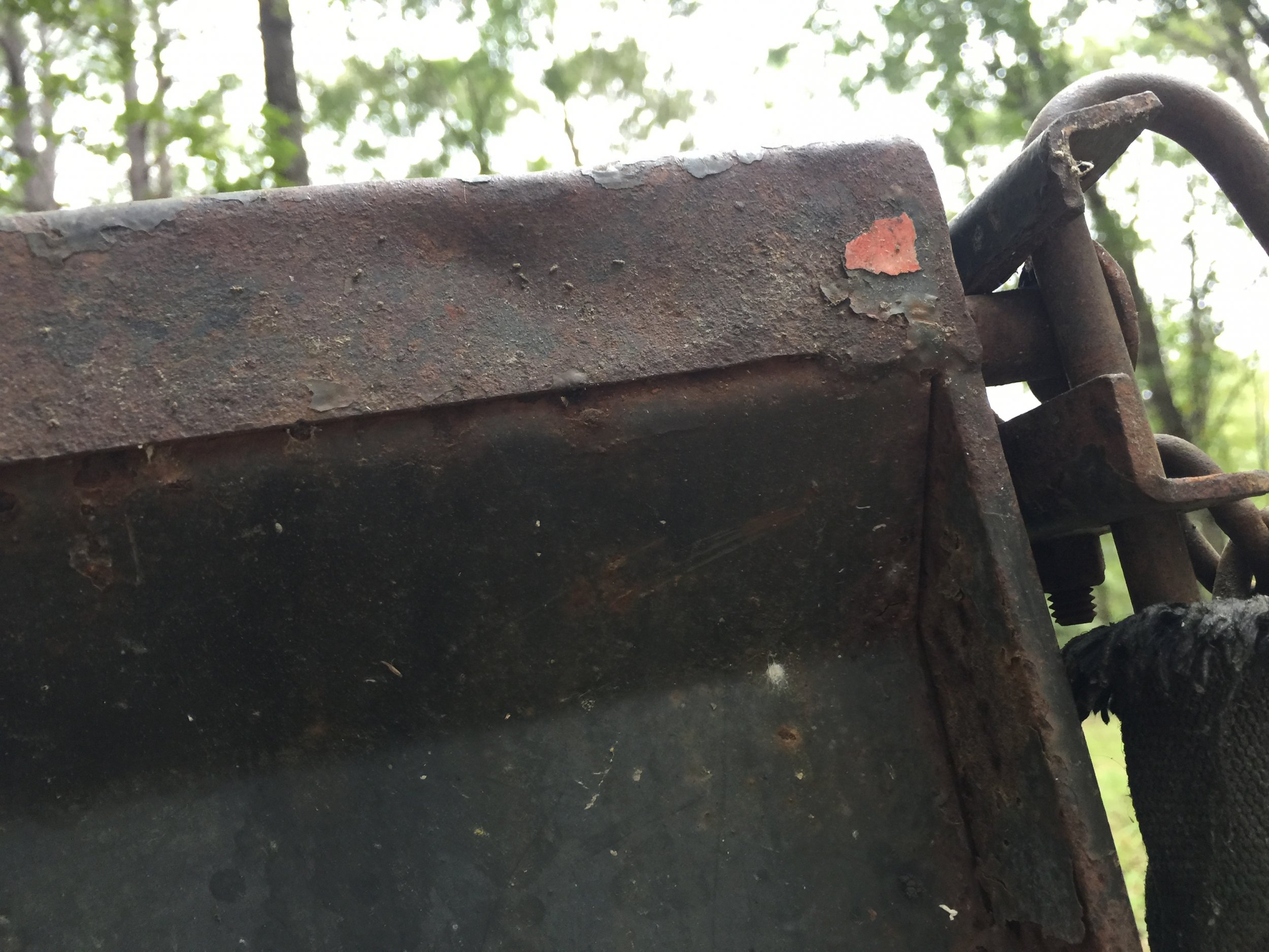

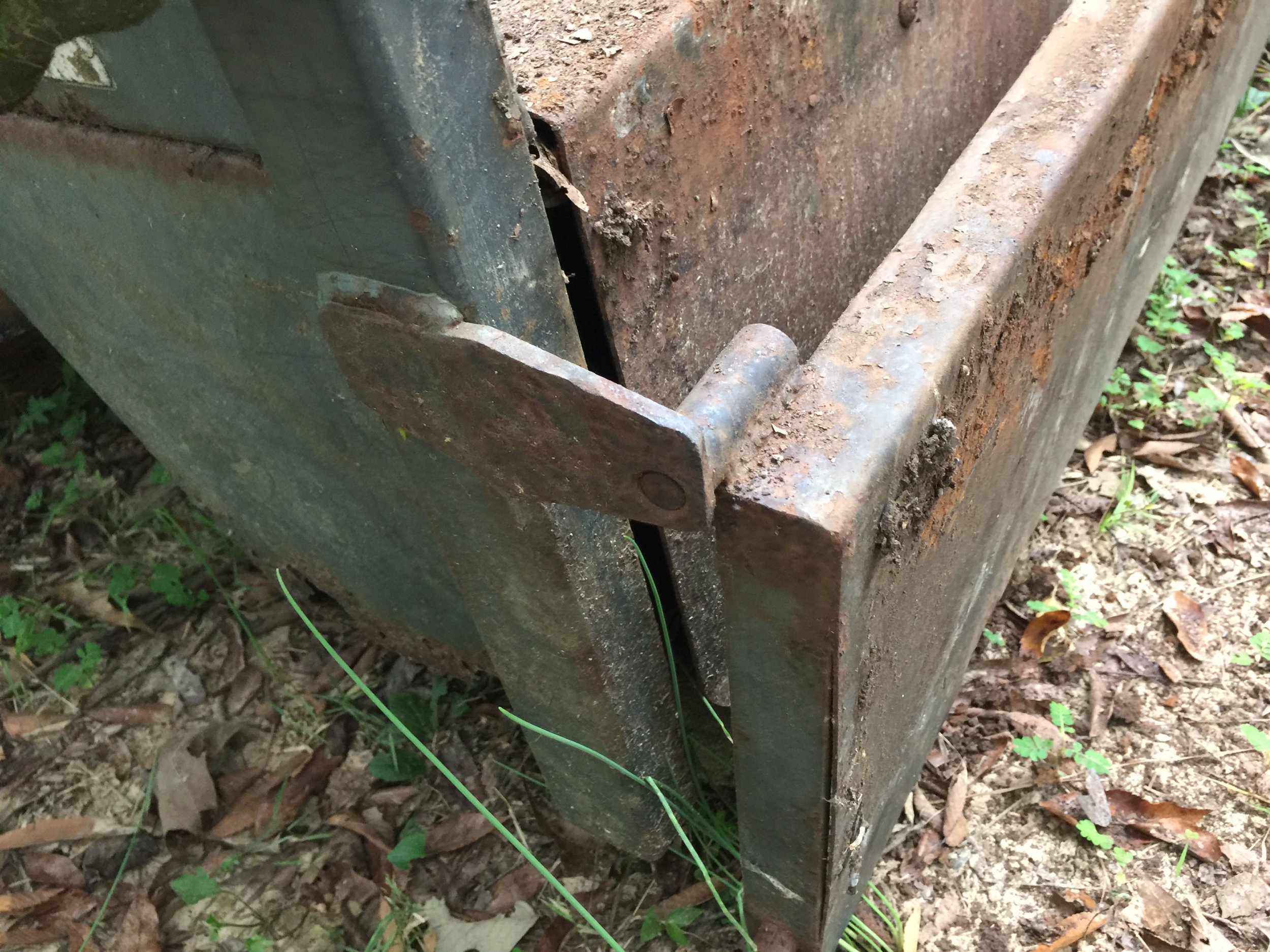

@minton my pug was bought in MS. now looking for a tailgate photo or diagram to build one. when i serviced the brakes on mine, i had to modify a universal 3-leg hub puller to get the drums off.
   / PUG F570 #44
I can send a photo but not clear on what you specifically need. To me, a tailgate is the dump bodies rear access point. My parts manual has diagrams of different sections of the PUG. Will any of those help?
   / PUG F570 #45

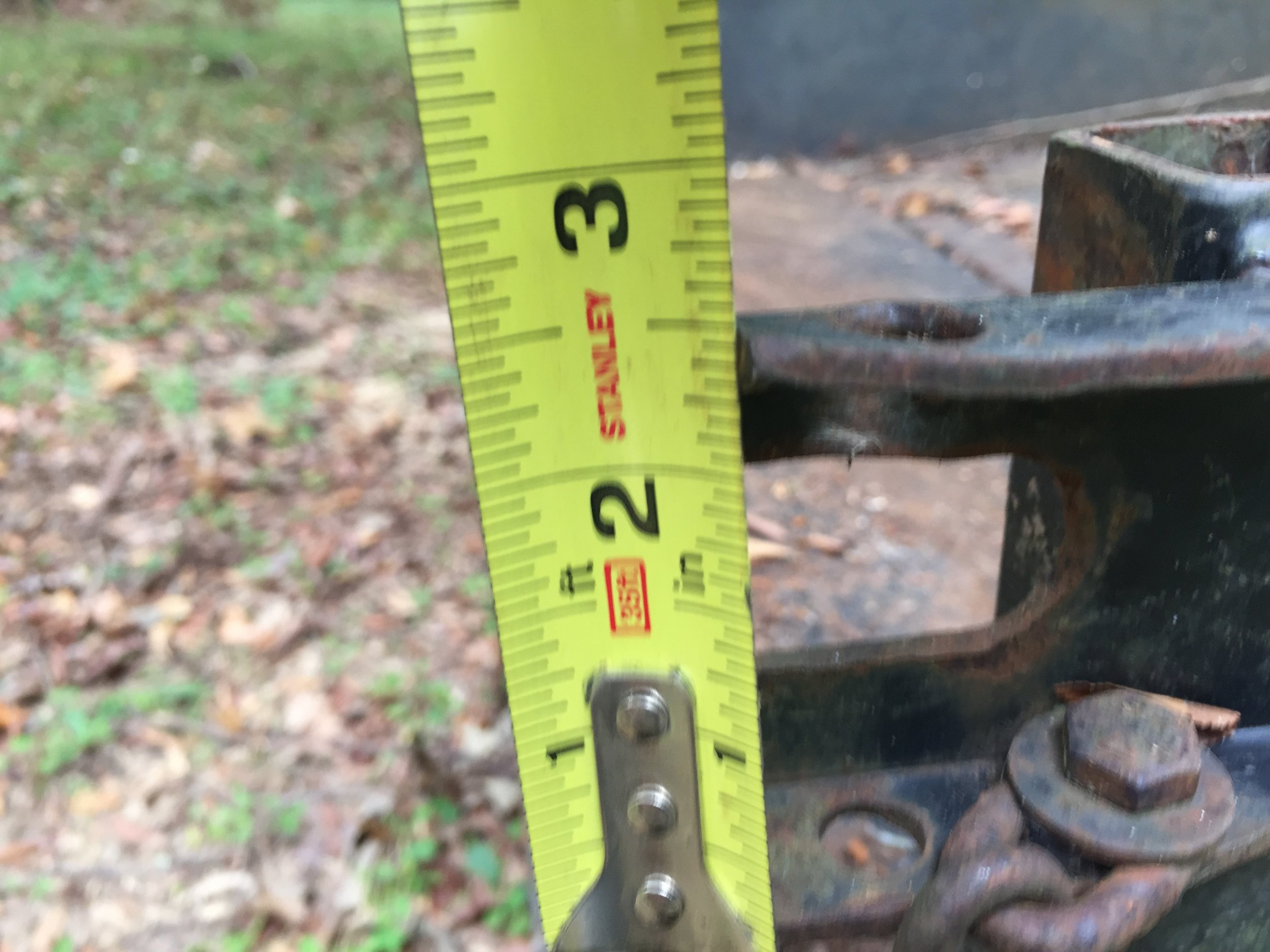

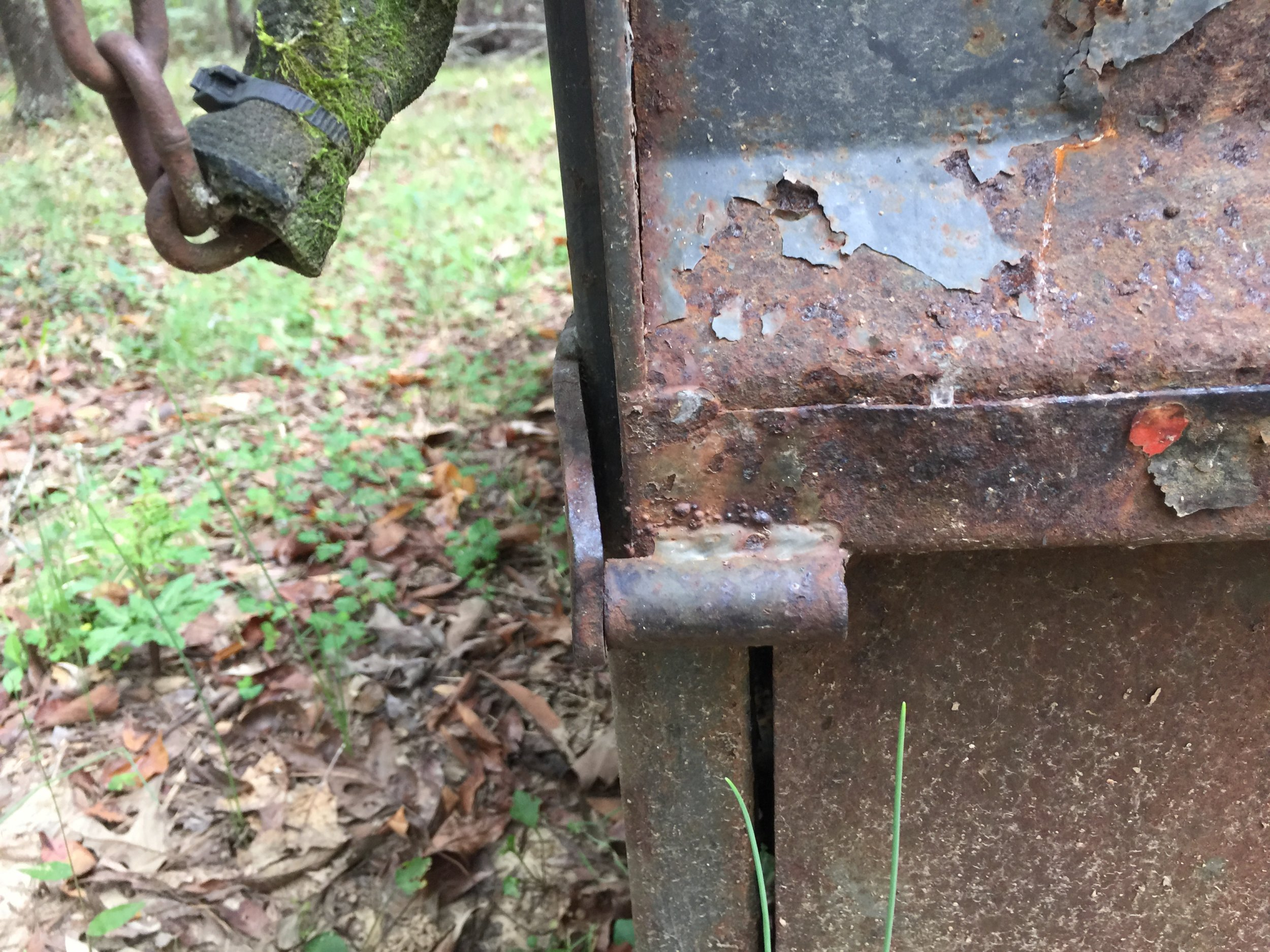

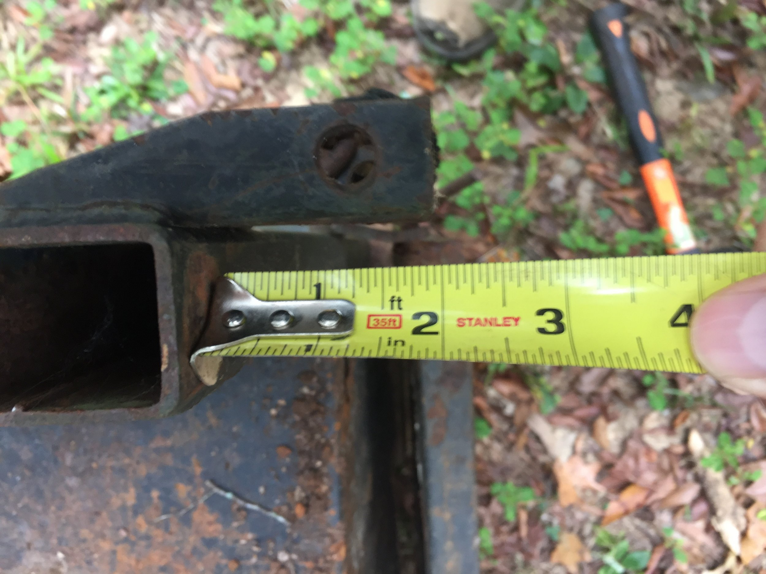

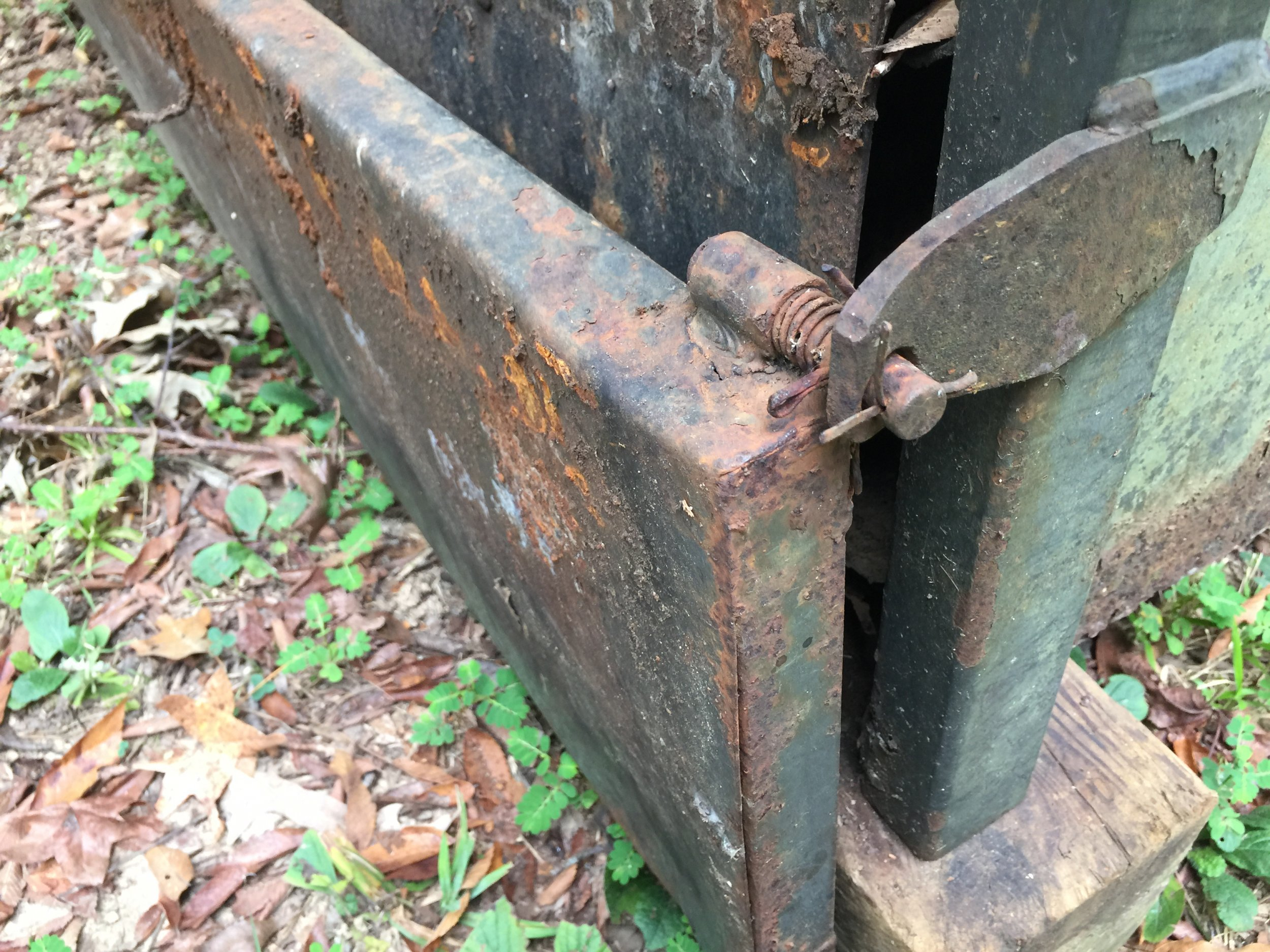

@minton hopefully i updated my settings so that i see notifications sooner.. if you imagine the tailgate of a pickup truck, thats the piece mine is missing. If you have photos of yours, it would help greatly, especially how the ends that fit into the pivot point and latches are made. the "parts diagram" of mine is kindergarten at best, no visible finer detail. For the rearend issue i am having: I vacuum pumped out the gear oil and left a magnet in it. Found nothing other than miniscule grit from normal wear. the "ka-thunk" i experience occasionally when changing from reverse to forward now happens soon after the shifter change, if it happens. I chalked it up to older parts freeing up with the fresh gear oil. The Jackson-built pug has a spring loaded rod in the shift linkage. It may a situation of the gearbox being bound into gear by the shifter and the linkage expanding suddenly when the shiftment fully seats from its bound position. Or it could be something sloppy in the differential. Either way, I have nearly 20 hours on it now, and it runs great other than the "ka-thunk" after a direction change - which only now happens occasionally. Is there anything I can provide for you on yours? The powdercoating is flaking off everywhere, so I will be scraping and painting soon.

johnwayne, sure, see if these help and if you need more let me know.

Here are some more:
