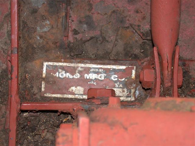

Updated with pics (see original post)
- Here is the serial tag (can't tell type)
Any guesses??

</font><font color="blue" class="small">( Updated with pics (see original post)
- Here is the serial tag (can't tell type )</font>
Looks as though it says manufactured by MONO MFG Co. S.A.
S.A. in Mexico is a designation of a private company much like INC. is here. I wonder if it's made in Mexico or another part of Latin America. Of course, the S.A. in this case could simply mean South America, but I'm not inclined to think so.
It's sure not a brand I'm familiar with.
