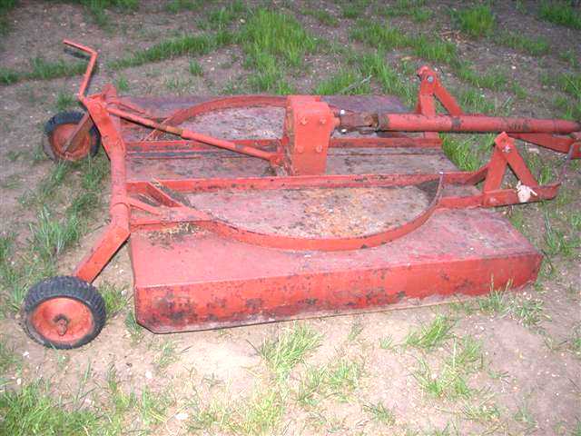

</font><font color="blue" class="small">( Looks as though it says manufactured by MONO MFG Co. S.A.
S.A. in Mexico is a designation of a private company much like INC. is here.
John )</font>
<font color="green">The way serial tag looks it could be the U. is missing from the S.A. giving you a rotary cutter made in the USA not Mexico.
There is a Mono Manufacturing in Missouri http://www.mono-equipment.com/contactus.htm
At this web site they make a reference to replacement parts for Mono lawn mowers, tillers, and brush hogs.
Mike </font>

I didn't notice that you had attached a pic in the original post.... /forums/images/graemlins/blush.gif
Well, it looks sound enough but those rear wheels are.......uh....well, they're unusual. If you buy it, you might want to replace them if you can pick up something cheap...

you're not going crazy, it was added later.
You're probably right, the U. is just missing, hard to tell on here.
I think it looks like it'll do the job for you. Is there a stump jumper with the blades that swing out on increased RPM like in many other cutters, or are they fixed blades. Better to have the swingers for those times it hits a stationary object. For the price, it's a great deal from what I can tell.

We use both pull-behind and 3-pt bush hogs at the farm. Our pull-behind has a single tongue which attaches to the draw bar of the tractor. This one seems to be what I think they call a "semi mount" which attaches to the rocker arms and the PTO but without a top link. That would make it basically a 3-pt mower when in use but without the ability to raise it off the ground.
For $150, if it cuts your 40 acres once, it'll have paid for itself. I think I'd do something about those wheels though. It doesn't look as if it would take much rough pasture to do them some serious damage.

I took the liberty to lighten up your picture a little to see it better.

As far as the mower mentioned in the original post, for that price, you ALMOST can't go wrong....
But about those WHEELS...............?

Thanks for all the great info and input!! (and Bill for lightening up the pic, as it was dusk when I took it last night)
The front of the mower is simply a tongue attachment to the tractor. I can't really see a way to attach it to the 3 point.
I think for what I am going to use it for, it will be fine. Basically, it will be a trailer mower for now. We have some brush to get down and who knows what I might hit in doing so. Feel alot better ruining a $150 mower, than $1000 one...
The person I got it from bought from his Grandpa here in NE Kansas, so probably bought locally. He did use it several season ago, replaced the yoke, and the gear box held oil fine. I will look at the blade tonight and post another pic of it...
