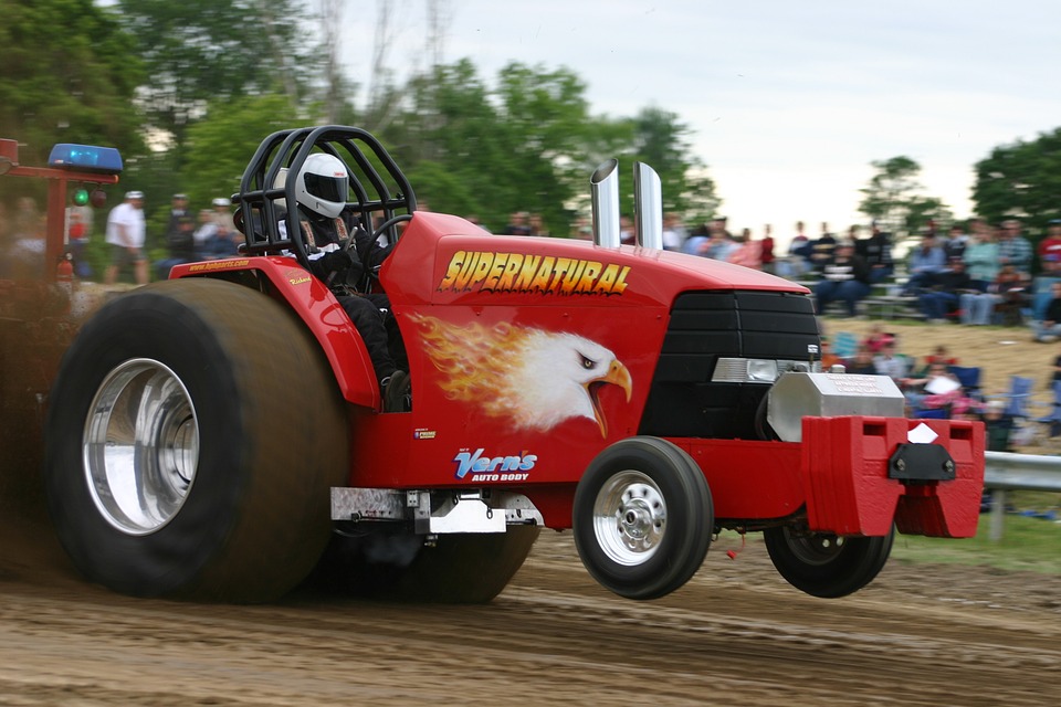

Tractor pull tractors do not flip over. They are drawbar hitched below the rear axle.
   / Pull from the front or the rear? #176
Pulling tractors must usually play by the rules. Some have adjustable height hitch points.
They also have the safety benefit of running on table top smooth and flat pulling grounds.
That single detail would likely reduce working tractor flips to ZERO!

Maybe because regular tractor tires can’t get enough grip on the hard packed slick dirt, but other than that I don’t see how it helps with flipping over backwards.

Right, and hence they do not flip over backwards. Always below the axle.
If one were working a tractor on table top smooth and flat grounds, what would catch up and cause the load to unexpectedly flip the tractor? The operator would know at starting off if the load was too much. No surprise! No catastrophe.
Unless you feel that the typical tractor operator is incapable of making adjustments that might extend his or her life span.
go back to post 140, click on the link, and watch how DIFFICULT it is to flip a tractor over backwards.
It takes three things to conspire to make a really bad wreck. And the first one is usually "I was not paying attention when....".
