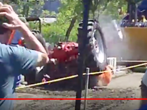

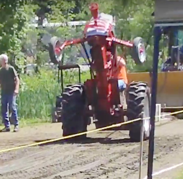

On the 8N, I don't see any sign of a low drawbar. I looks like it was hooked high.
Bruce
   / Pull from the front or the rear? #162
I paused that video there too. I don’t know much about those old Fords, but it looks like there is a spot for a swinging drawbar, but nothing there.

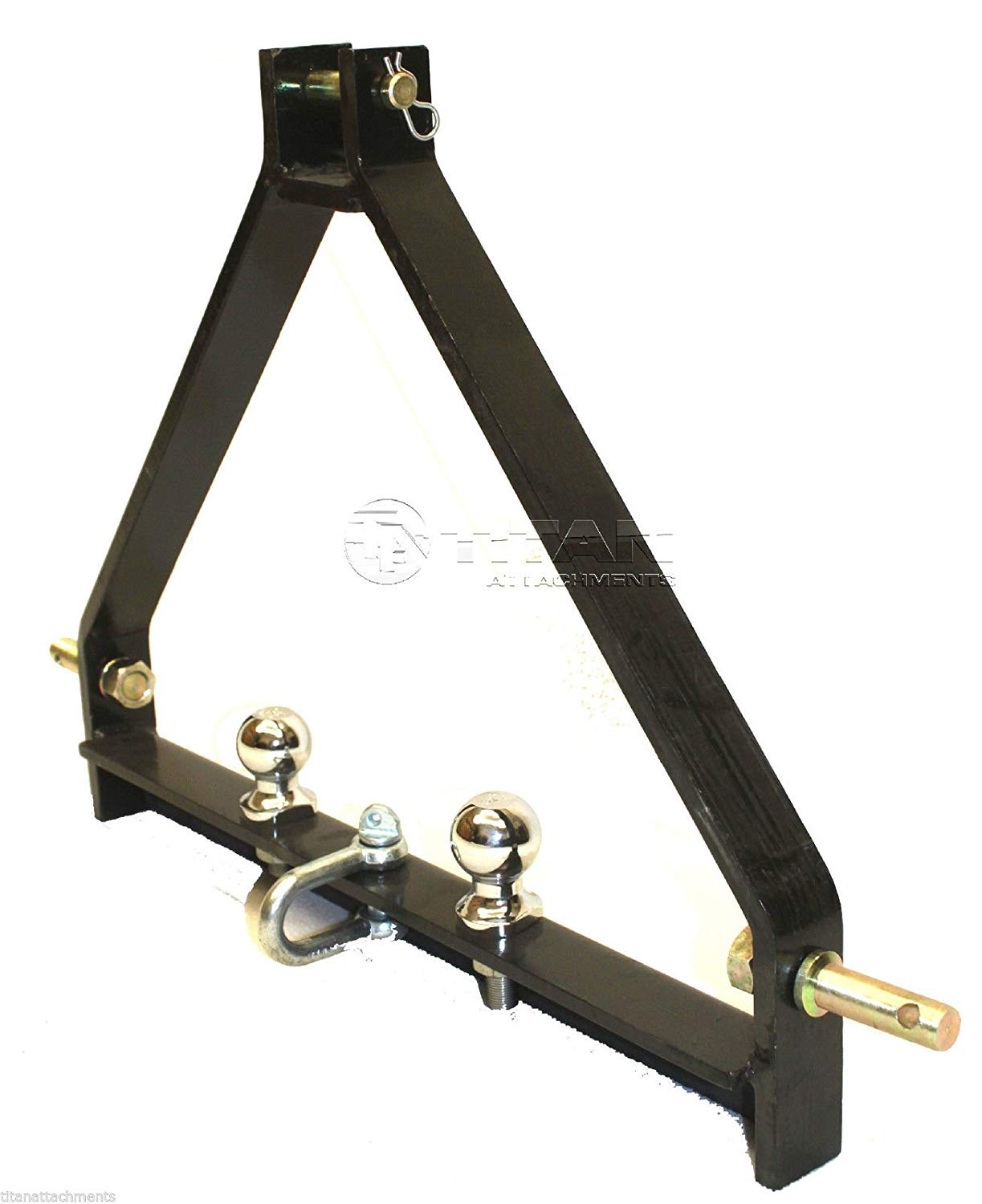

I think some of the posters are confusing the tractor's drawbar with one that's mounted on the 3PH.
A tractor mounted (below the rear axle) drawbar will tend to pull the front end of the tractor down....much less likely to result in a rear rollover
   / Pull from the front or the rear? #166
Good question. Towed implements get towed from the drawbar, and 3pt implements get attached to the two lift arms and top-link. I never found a use for the 3 point drawbar when I had a machine with a 3pt hitch.
I have towed a trailer using a 3PH drawbar...looks something like this:
Used it to tow a smaller trailer (probably a quarter ton) when we lived in Pennsylvania.
Nice trailer, and I've regretted leaving it in PA.
Anyway, a drawbar such as shown in the picture works great for trailers, but if I was towing or pulling something without wheels, I'd use the tractor mounted drawbar most tractors have below the rear axle.

Exactly. Which is why tractor pull tractors do not flip over (that 8n was hitched high). The front tires bob on and off of the ground.
