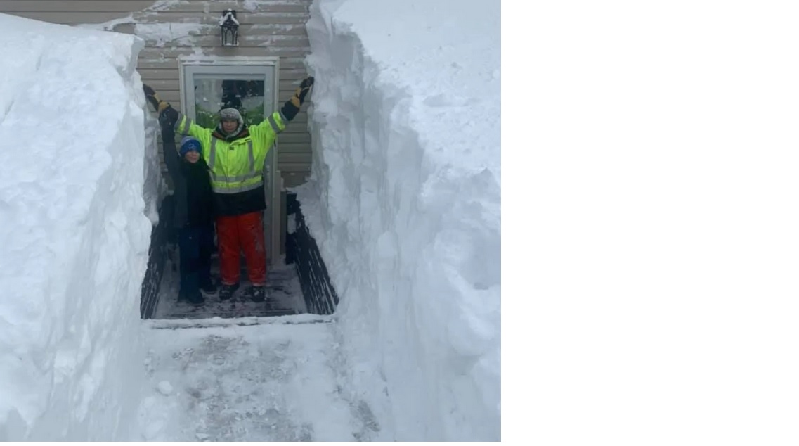

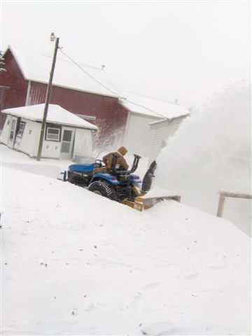

Pic's of the storm ending now in Eastern Newfoundland Canada

Wow, that's a lot of snow you have!
I'm sure those bi-directional blowers cost a pretty penny!

Check out Paul Short's recent video on the Newfie storm. A rear pull wouldn't fare too well with all that snow. The convertible on the other hand would shine.

I just got hired to do a quarter mile driveway with 30" of snow on it or more later on this week. Without a push blower, my tractor would high-center in the snow and get stuck.

Holy carp - that's a LOT of snow. I used a rear push on my mile long gravel driveway for 25 years. That's 25 years of sore shoulders & neck. If I had that much snow.........I'd probably move to Florida. No, I'd be looking at a front mount( FEL ) blower for sure. Or one of those new Pronovost bi-directional for sure. I don't think that there is a tractor in this world that could handle that much snow with a rear PULL blower.
With the amount of snow you show in your pics - snow is not a game for you. Get serious, get something that will handle all that carp.
I just looked at the OP's pictures again. How strange - all that snow on the ground and barely a flake on the roof.

Holy carp - that's a LOT of snow. I just looked at the OP's pictures again. How strange - all that snow on the ground and barely a flake on the roof.
That is what high wind does in a blizzard. The wind blows it off the roofs and into low lying areas or dead air areas.
