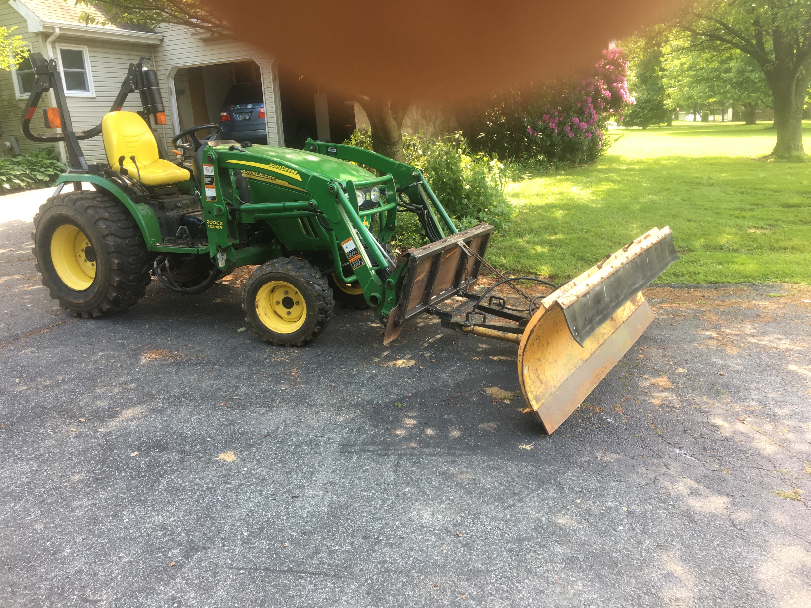

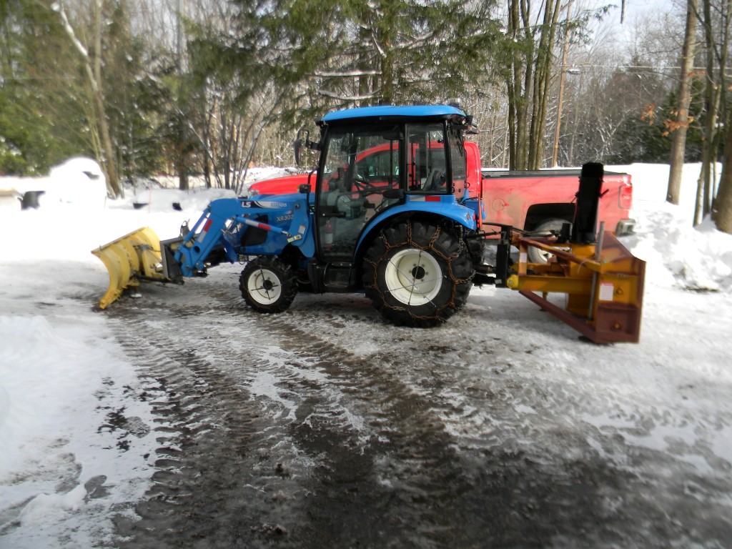

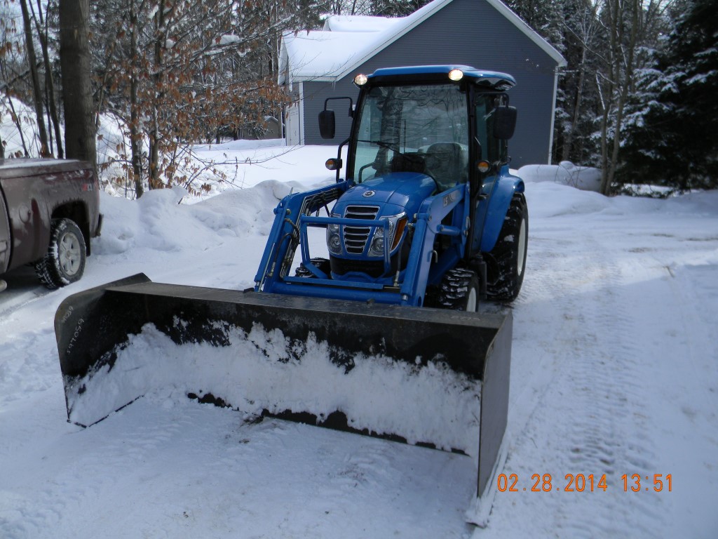

I got a pusher when I bought my tractor. (was part of the deal) Pushers work great on parking lots or anyplace where a straight line push is needed. I added a pull back blade to get up close and it worked great. However, once the pusher gets full of snow it makes turning very hard even with chains on all 4 tires. You can get a rubber blade instead of steel for the pusher though a steel edge doesn't really do any damage to blacktop or concrete. We used a 16' pusher at work for clearing lots but on a much heavier machine. I used mine for one season then sold it. My driveway had too many curves plus it was a gravel drive.
The next summer I built a quick attach plow out of an old 7 1/2' truck plow and have used that since. I ran hoses from one of my rear remotes to the front to angle the blade.

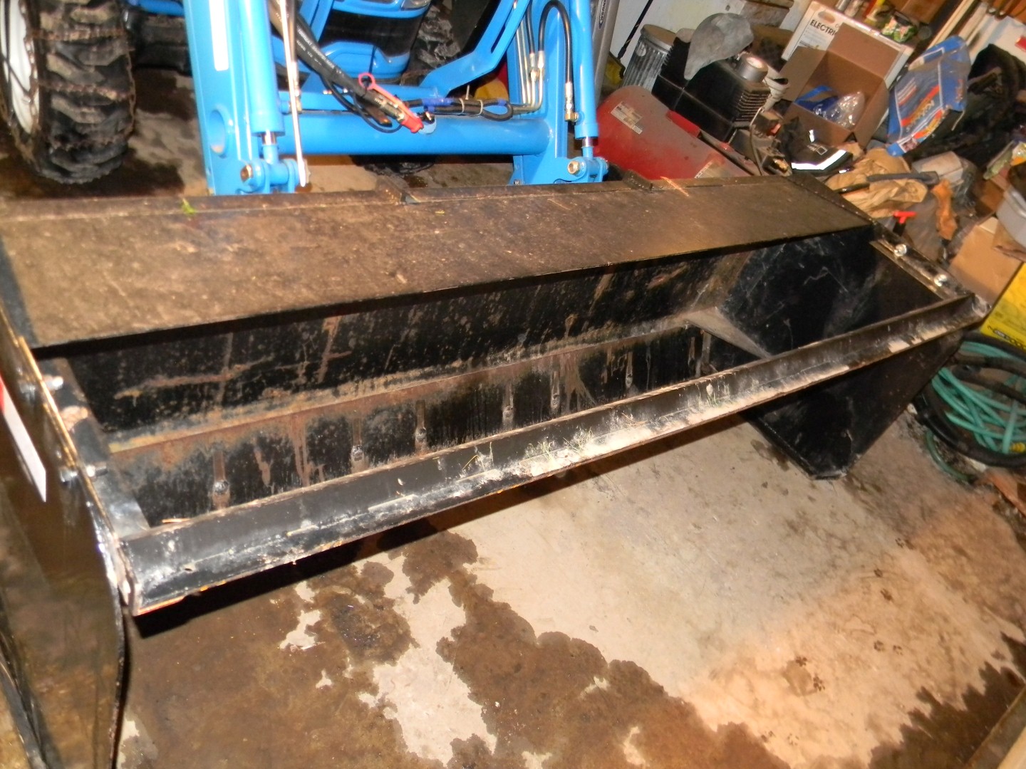

The oem bucket on my GC2610 is 4' wide. I made my own for plowing snow. It is 6' wide and about 8" taller. Right now, I'd have no place to push the snow if I could't pile it.

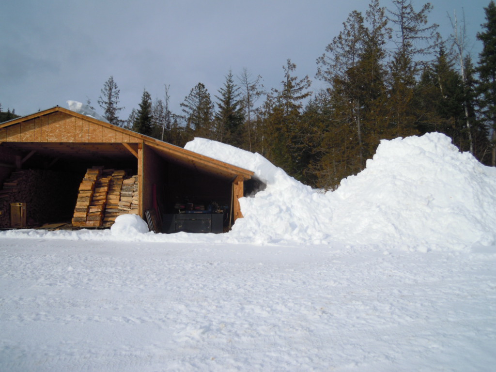

Every tool has it's place. I have a regular bucket, large capacity snow bucket, 8' snow plow with hydraulic angle, rear blade and 2 rear mount snow blowers. I don't have a snow pusher but made some wings for my plow to contain the snow on longer pushes. This made a huge difference when trying to contain snow for a longer push. What I discovered is that the there are a few major differences between pushing snow and carrying it. A large capacity bucket is great to move snow from one location to another for longer distances and for moving it from one stockpile to another location. But for moving snow shorter distances, for me that is about 150', my modified plow with wings is WAY better for the following reasons; 1) when I push the snow into a pile, I can pile it much higher because I don't have to curl the bucket down to get the snow to fall out of the bucket (my guess is that is about a 4' elevation difference, 2) I don't have to curl the pusher down to unload the snow, I simply push into the pile and back up. This saves a lot of time! and 3) pushing snow into a pile compacts it as it is pushed, instead of end dumping the snow, which leaves it uncompacted. This is also huge because you use less storage space for the same amount of snow.
Here are some pics from the last week showing the piles of snow around my house and outbuildings. The driveway is a whole different animal, requiring different methods. The piles are over 10' high and compacted. When I used the high capacity snow bucket, I immediately noticed that I couldn't pile the snow as high and my storage areas were filling up too fast.
