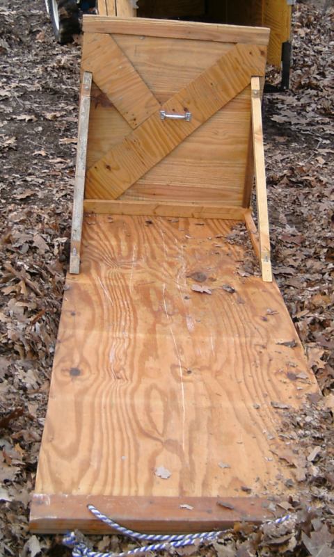

Finally getting around to building the slide out 'shelf'. Question for you...why did you attach the rope to the front of the shelf, instead of just putting a hole in the shelf inself at the rear and threading in the rope?
also, did you find that with the front vertical board only part the height of the box, that when you pull the shelf out the leaves drop down inside the box? A front board the same height would help with this ,but I'm worried it would be too heavy to put back in.

I attached the rope to the 2x4 angled uprights because they were the 'beefiest' part of the whole slide-in. It is a tremoudous amount of weight when the trailer is packed full and I think it would distort the slide-in out of shape over time. I would need to add additional support(and weight)across the rear edge to attach the rope there.
I'm happy with the height of the front vertical board. The wind velocity packs the leaves in pretty tight, so they stay in a cube as they come out, losing very few leaves over the back of the vertical upright. Your results may vary depending upon: 1. How much your vac breaks the leaves down. 2. How tightly they pack in the trailer.

Thanks, I understand. What I had considered doing was just screwing a 2 x 4 the width of the board at the rear end, would add stability against 'curl' and then drill holes in it to run the rope through. (With a knot). I think that would handle the weight, but now I'm thinking you way is better; my way the knot would rest under all that weight, and when pulled out the rope might abrade over time. (This approach would make 'rope management' easier I thought).
I think my trailer is a bit larger than yours -- mine is 36 inches wide by 84 long, so I'm trying to think through all the issues with weight, inertia, etc. before I get it together. (for example, I've thought about using metal guides on the bottom instead of the wood ones you used)

Your trailer is much longer and a little wider. Mine started out as a standard 10 cubic foot lawn and garden trailer similar to what you see at TSC or Sears. Depending on how high the sides are.......it will be quite heavy. Thinking out loud......when unloading the trailer a prop on the ground that would hold one side of the 'slide' up would dump some of the leaves off to the side when the 'slide' dropped off the edge of the trailer. Thus making it easier to remove the rest of the leaves to 'free up' the slide from under the leaves.

Got most of it done. I'm a bit worried about the front vertical panel pulling off with the weight of the leaves when sliding out. I had screwed in the panel to the 2x4 supports, but now I think I should put a lag bolt in there since that will bear the brunt of the pressure. I think I'm also going to poly coat the bottom of the sliders to reduce some drag.

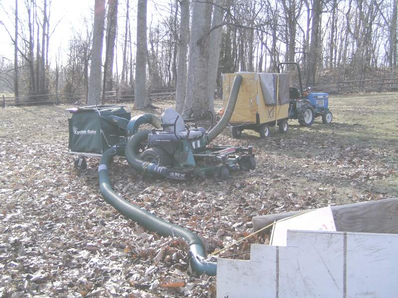

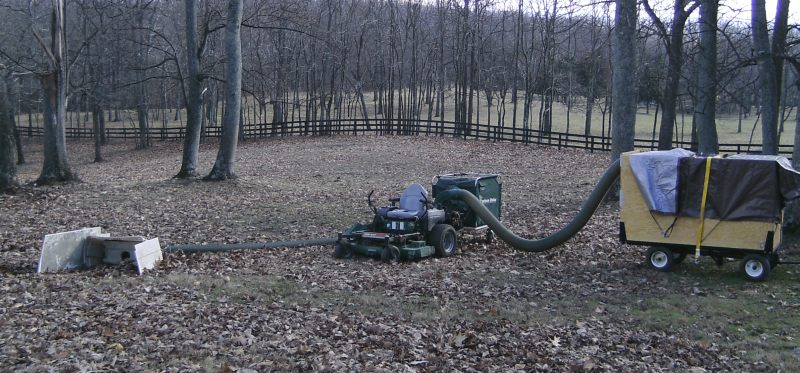

Well, here it is in action...my first post with photos, so hopefully I'm doing this right.
Two pics show the entire 'system' in action. Note that the bag on the Cyclone rake is bypassed. The entry vacuum hose goes to the vacuum, and then outputs into the large cart. On the imput side, I'm trying something new; instead of the backbreaking method of manually sucking up the leaves, I attached the input hose to a box (just a plastic storage bin) with 2 boards forming an entry shute. I then use a backpack blower to blow leaves into the box.
The other pic shows the sled.
The system works great. A little slow in some ways (getting the leaves into the box takes some subtle blower work, and getting the whole system in place takes a while). But once going, it saves the big time waster, dumping the leaves, since this cart holds at least 5x what the cyclone rake bag holds, and now with the sled, the dumping is very quick.

pic of the sled....

The system works great..........the dumping is very quick.
Excellent! Should be good for years to come.
I have an idea'r. :D For the next update down the road apiece. Is there a possibility of hooking the large wagon up behind the cyclone rake and pulling the whole rig while vacuuming with the mower deck. It kinda be like driving an 18 wheeler that doesn't back up. :rolleyes: .....but it would work in open areas. Just 'leafin' a thought for a future project. :) You can never have to many future projects. :D
Good job on the sled!

Well, as for the sled, I have you to thank, it's your design!
BTW, there was no problem at all with the larger size, it still just slides out fine.
Regarding the 'semi' idea, I have thought of this. I'm not sure if the 'trailer' on the rake would be strong enough to connect the cart to. What I have considered is, at some point, finding someone to help me weld a small platform on the front of the cart, above the level of the tongue. I could mount the vac on that (it is held in place on the vac cart by just two bolts) and do away with the vac bag altogether.
