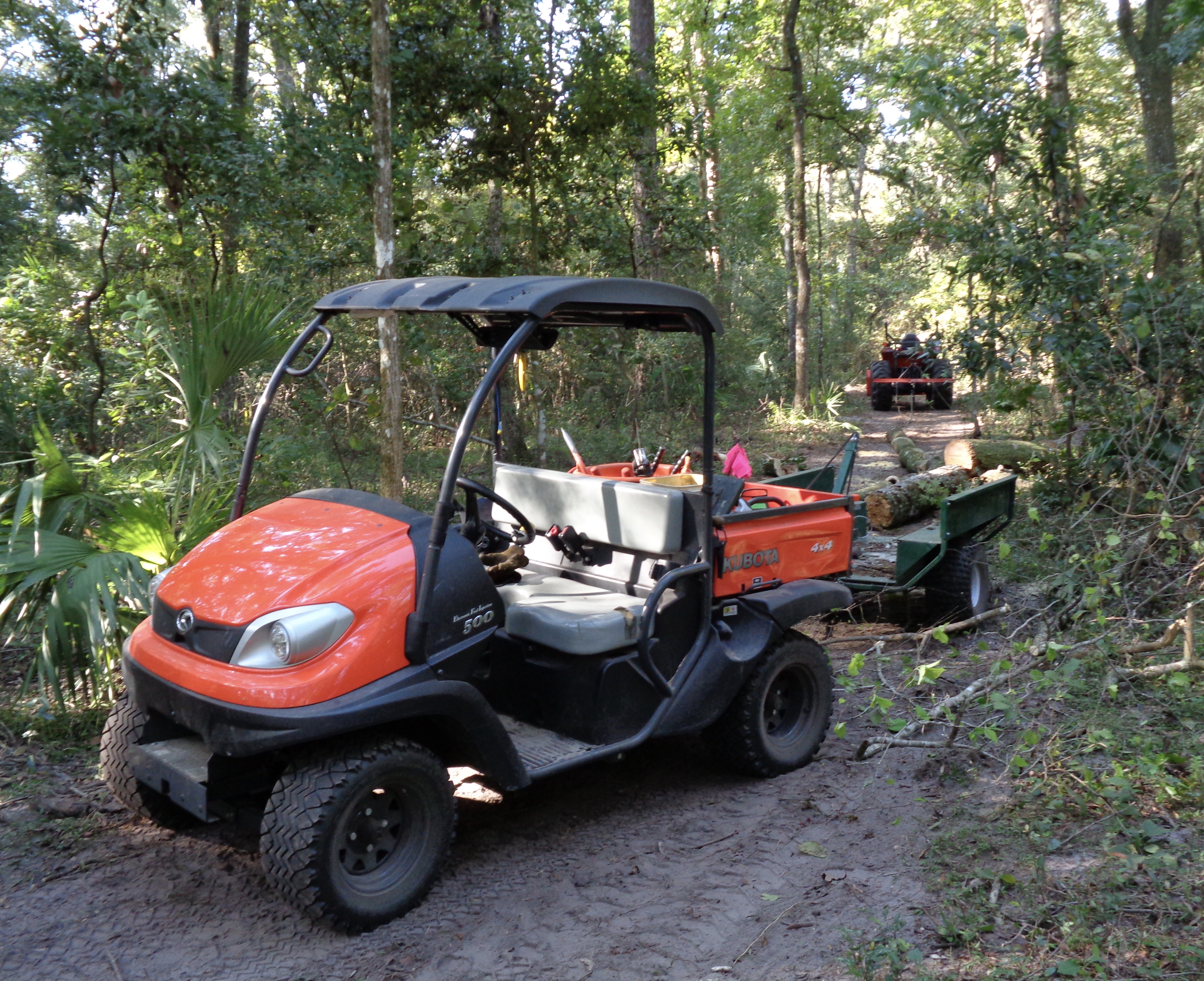

After six months the RTV500 will sag to the driver's side.
Adjust left shock one increment harder or right shock one increment softer and you will be set for life.
Turf tires take on a "set" in 24 hours of sitting. Takes about five minutes for tires to return to round as they warm.
I put a little Seafoam additive in with the gas.
Great vehicle.

Thanks for the tip! Im going to try and keep the ethanol out of this one, and I treat with MMO and Startron, and it has done me well so far in most of my OPE. I see you have definitely put yours to work, and I really like your trailer.
I have seen some pics of people that have built some side rails for the bed. It doesnt look too hard, and could help when hauling brush or stacking up firewood... Any suggestions there?

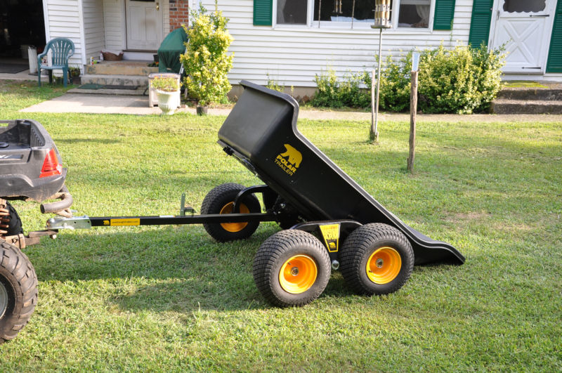

No tractor?
I personally would not carry heavy loads in the bed, though many do. Center of gravity would be too high in my estimation, with the potential for a rollover.
I suggest pulling a trailer. The eight year old, single axle, dumping MUTS I have is the berries.
Polar trailers are high value but do not dump 100%. Polar trailers are sold by Lowe's and Home Depot on their web sites. PHOTO
LINK: MUTS – The “SWISS ARMY KNIFE” of ATV work trailers – THE BEST ATV WORK TRAILER EVER!
