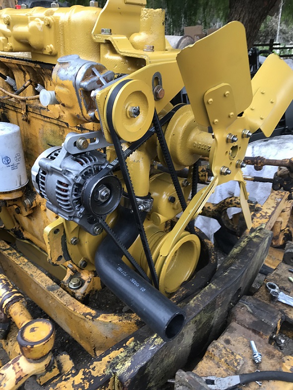

So I got rid of the generator and I'm going to use a Denso mini alternator 45 amp. Had to make a simple little bracket, and finally got the belt sizes right. Lol. Just got to put the radiator on and hook up the hoses. Wednesday my carb rebuild kit will be here.
What is involved in a swap from a generator to an alternator? For some reason, I've never done that.
   / Pulled this old Oliver out of the field... #158
It's relatively simple if you use an internal regulator alternator, but the bigger problem is if the generator was a POS ground switching all the rest to NEG ground becomes the issue, like starters generally need worked over to switch polarity, and gauges need to be reversed so the read correctly. And if it's a original 6 volt, and most all alternators are 12 volt, other changes will need to be made to make gauges read correct, I've seen starters left and they just spin like crazy on double voltage, for casual use that may be acceptable, otherwise the usual cure is to stack two 6 volt batteries and tap off the middle for the starter and electrical system, and let the other battery go along for a ride, switching one for the other every so often. Voltage reduction for a starter level of current is not a easy task.
My system was a 12 volt POSITIVE ground. So to start, I first put the positive battery cable to power the starter. The starter doesn't care about polarity. It can be positive or negative ground, and will not spin backwards like you would think, or like I thought. LOL
Then of course negative battery cable to the engine block.
I used an internally regulated 3 wire alternator. The main output lug on the ALT goes to the positive lug on the starter. The other 2 wires on the ALT goes to key on power at the IGN switch to excite or turn on the ALT. The 3rd wire on the ALT is now a dash light, replacing the original AMMETER. With the key switch on, the light lights up, once engine is started and running, the light goes out.
Back to switching over from a positive ground. Now the coil gets positive power from the key/start switch position, and run the ground from the coil to the distributor. I think that covers it. I had to do alot of reading to figure all this out. LOL
Oh yea the gauges will not work. The aftermarket makes reproduction gauges for a modern negative ground system.
