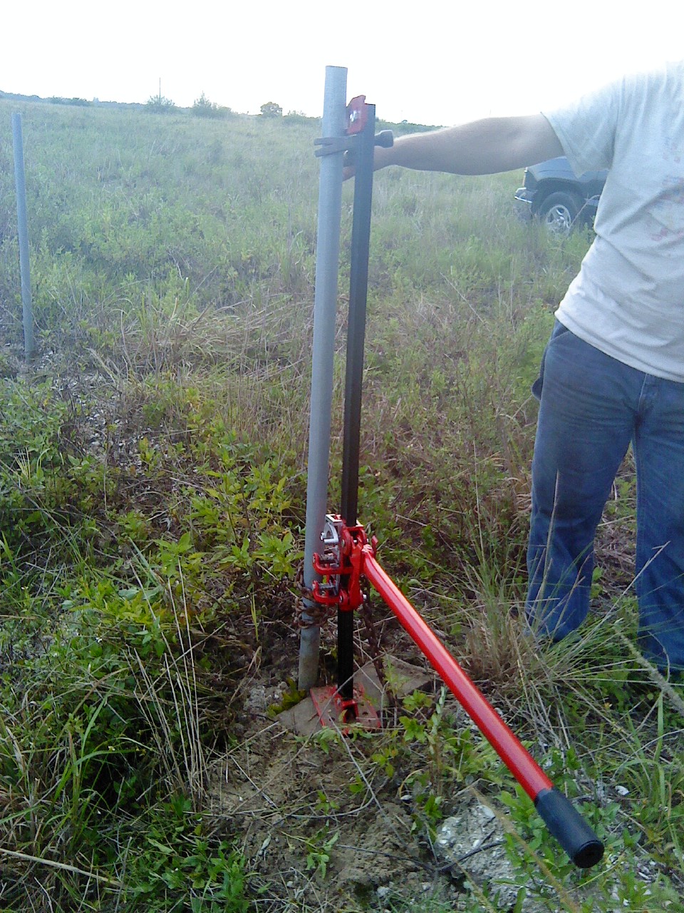

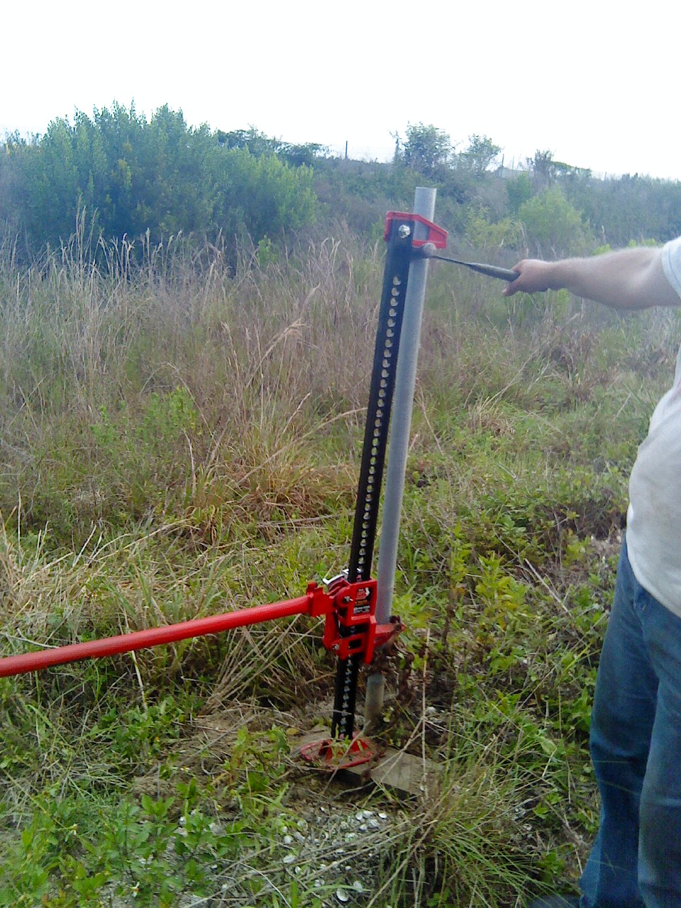

bthomas67wagon the jack I show in the pic's has a 7000 pound lift capacity I think that should be enough.

I'm happy to say that I have roughly 98-100 of my 110 posts out of the ground and ready to be moved to my new place!! :)
A couple people tried unsuccessfully and I turned down or ignored dozens of other requests, but gave it one more shot with a guy who insisted that he could guarantee success and he came through. It took him 4 hours flat to pull them and only snapped 1, so I was amazed!! He said that the key is to pull from the top and not the bottom, but IDK...
Regardless, success !!!
