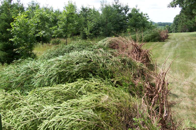

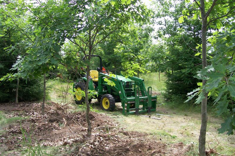

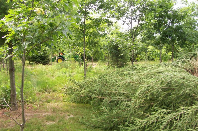

I've a 4300 and I remove a lot of 30+ ft spruce trees with my forks primarily. I stab into the ground each side and curl the forks up to sever the roots. They are long and tough. When I have several broken off, I push on the tree about 5-6' up and usually the root ball will roll out when the tree tips over. Then I put the forks under the root ball and lift while pushing. That usually does the trick. I then shake as much dirt off the rootball as possible and drag the tree off to the brush pile. Rabbits think it is a large safe castle for them where the coyotes can't get them.
I'm leaving the red oak interplanted between the spruce, and will be done when I remove about a thousand more. :)

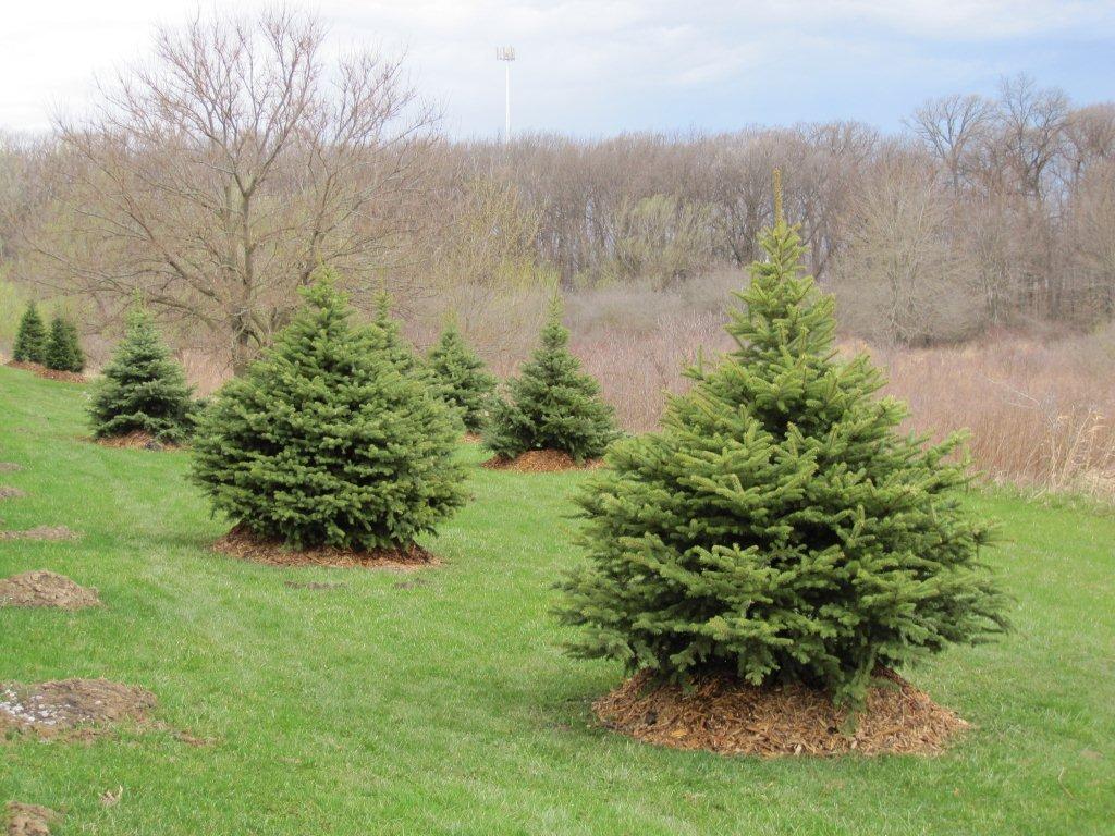

I am with you NOTV8 !
I love Blue Spruce (Colorado Spruce)!
A 30ft tree costs a bundle and when you transplant a more than 8ft tall the survival rate goes way down, according to the Arborists I have spoken with.
I guess... One mans Jewel is anothers trash......

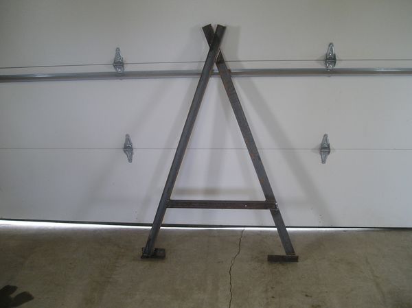

After reeding a long thread here a while back, I made this "A" frame from angle iron. It is about 4 feet tall and works the same way as Kennyd's truck rim would. If I ever make another one it will be about 6 foot tall so I can get a longer pull before removing the slack out of the chain.
