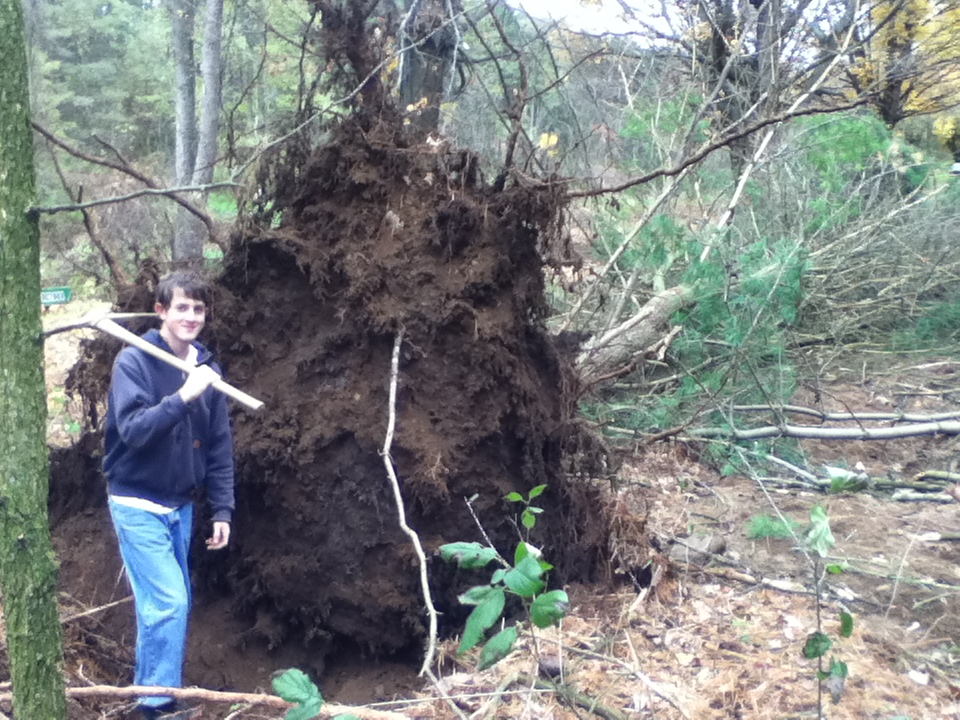

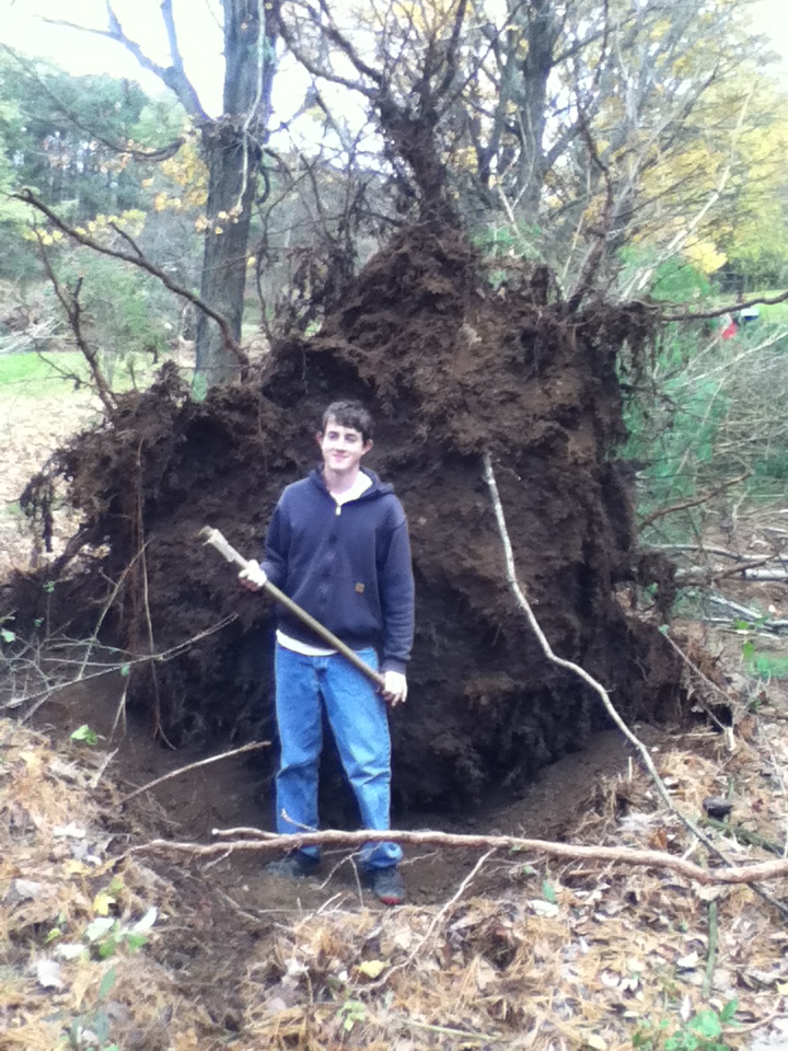

[Hook 'em high!
I was amazed at the difference wrapping the cable at 16' above ground versus say 10' or 12' has when pulling over a 60'+ trees. Get all the leverage you can! Found it handy to carry a bale hook up the ladder to use to reach around the tree trunk & grab the end of the cable. A small weight on a string tied to the end of the cable might also be usefull to "whip around" the trunk, so you can then pull the larger cable around the trunk with it.
A very long cable is better than a shorter one as it reduces the cable angle when you hook them high on the tree, that is, when you pull anything with a tractor where the load is above the plane of the connection point on the tractor, you're actually pulling the back of the tractor off the ground the more you pull, and you will lose traction. (versus a load below the connection point which makes the rear tires dig in that much more, which = wheelie instead of spin). Having weights (like your 6520) and 4WD will help, as well as a long cable that reduces the angle.
ATTACH=CONFIG]295535[/ATTACH] IMG_1742.jpg
