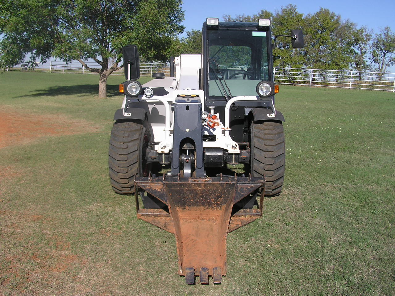

I'm wondering if there's a better way to pull out trees than wrapping a chain around them and yanking them out with a tractor.
Trees are various citrus, almond, walnut and grapes.
There's gotta be an easier way to get em out, right?
My easy way is a stump bucket.
