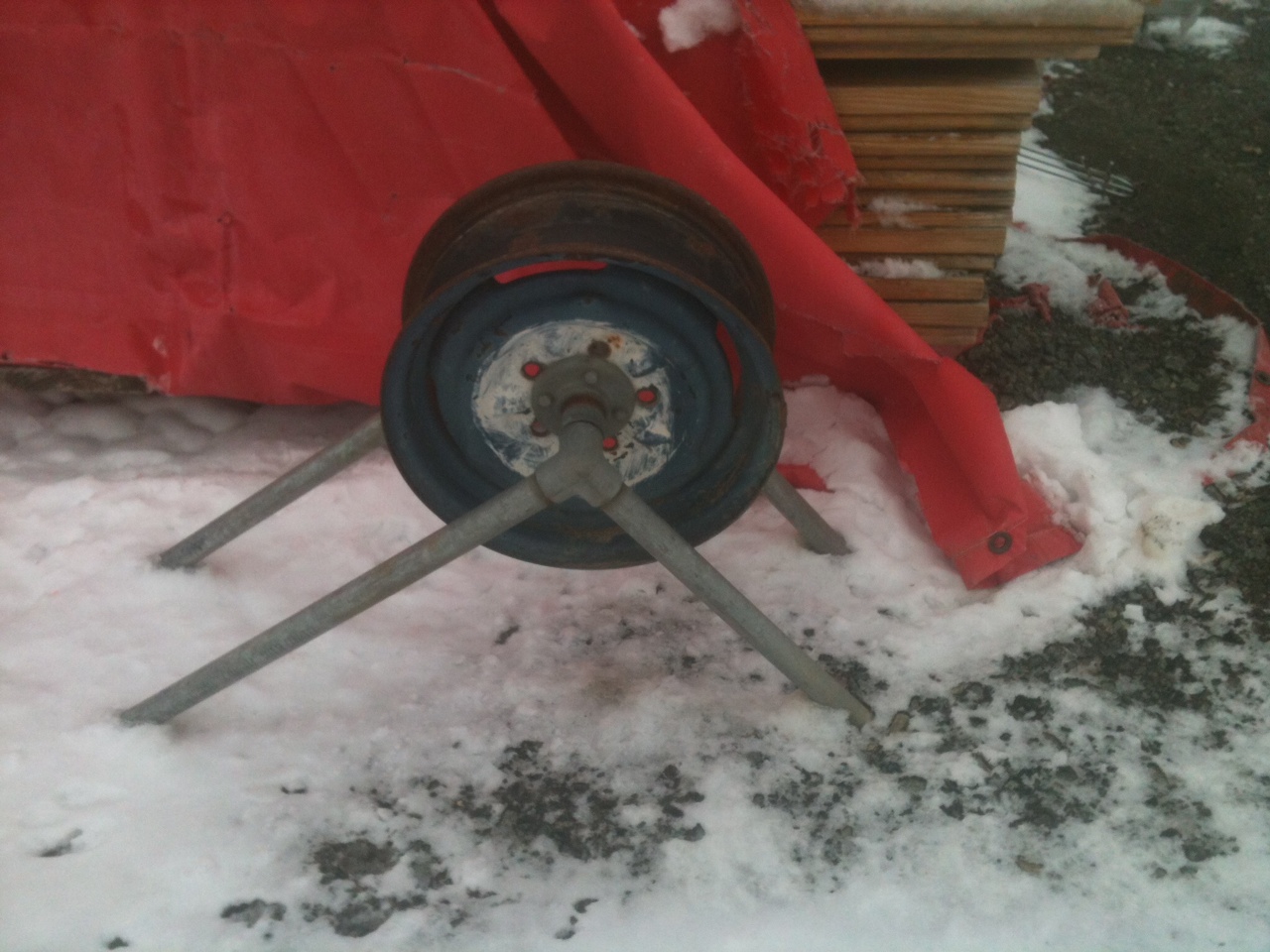

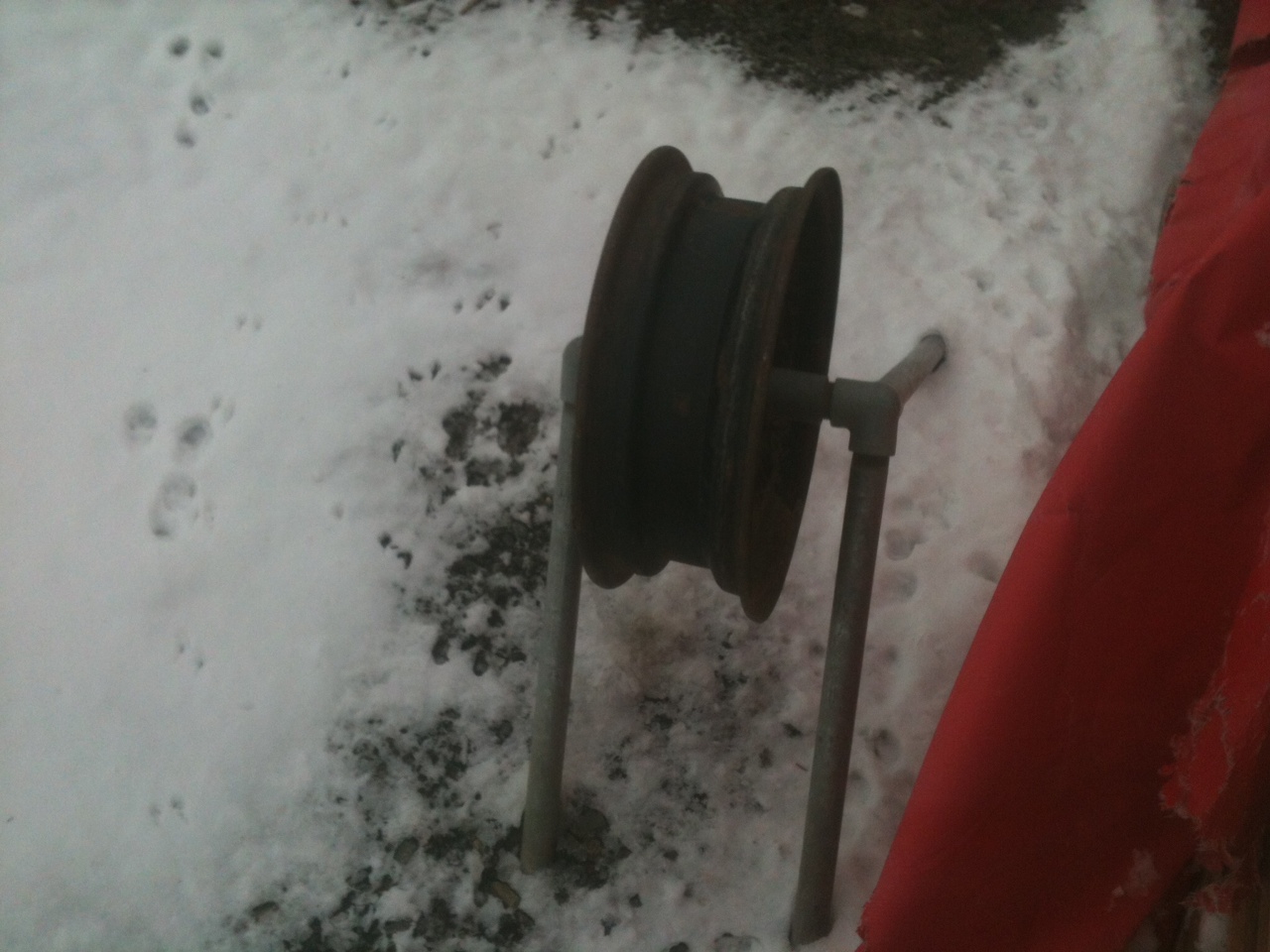

For those of you with a pump on polly pipe w/ a pull rope, I have used one of these for 30+ yrs. Just set the short legs straddle of the casing and pull away.
E/S
