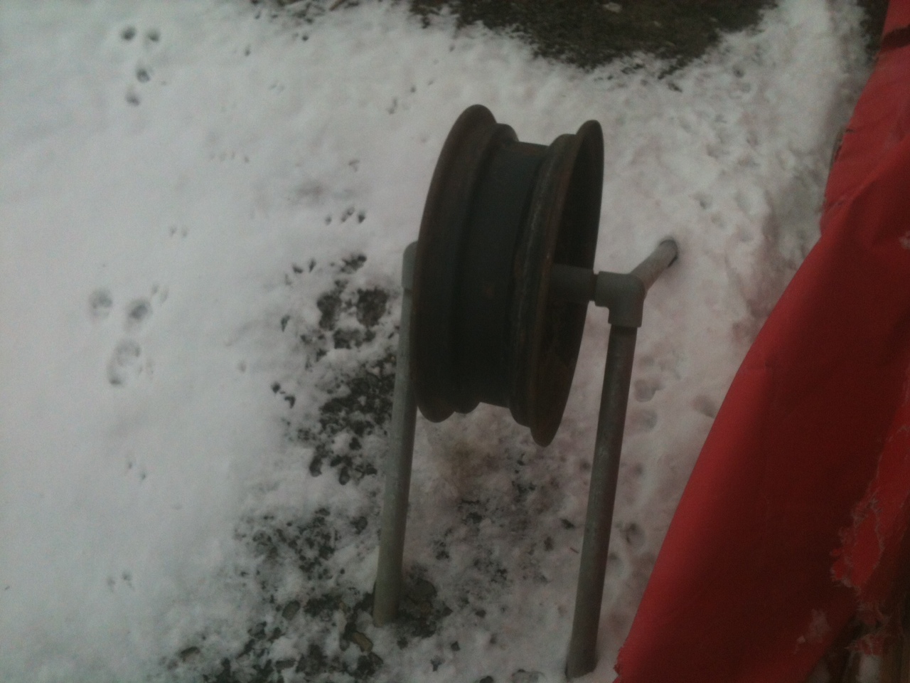

For those of you with a pump on polly pipe w/ a pull rope, I have used one of these for 30+ yrs. Just set the short legs straddle of the casing and pull away.
E/S

And why the pump has a tasb for attachment. Ill admit I havent use the rope to pull a pump out I alwasy considered it an added safety against loosing it down the shaft.Knowing now it is supposed to be used to pull the pump up I then imagined something like the piost with the car wheel and then a cheap winck on it to drive the wheel and you would just wind the rope onto the wheel.Im not sure how much rope would hold..

I've been told to hook the rope to a ATV/Truck/Tractor and pull it over a large tractor rim (with no tire on it), but I think that will only work if its a single piece of plastic pipe.
Note I've never done it, but I'm planing for it since I don't know how old my well pump is.
