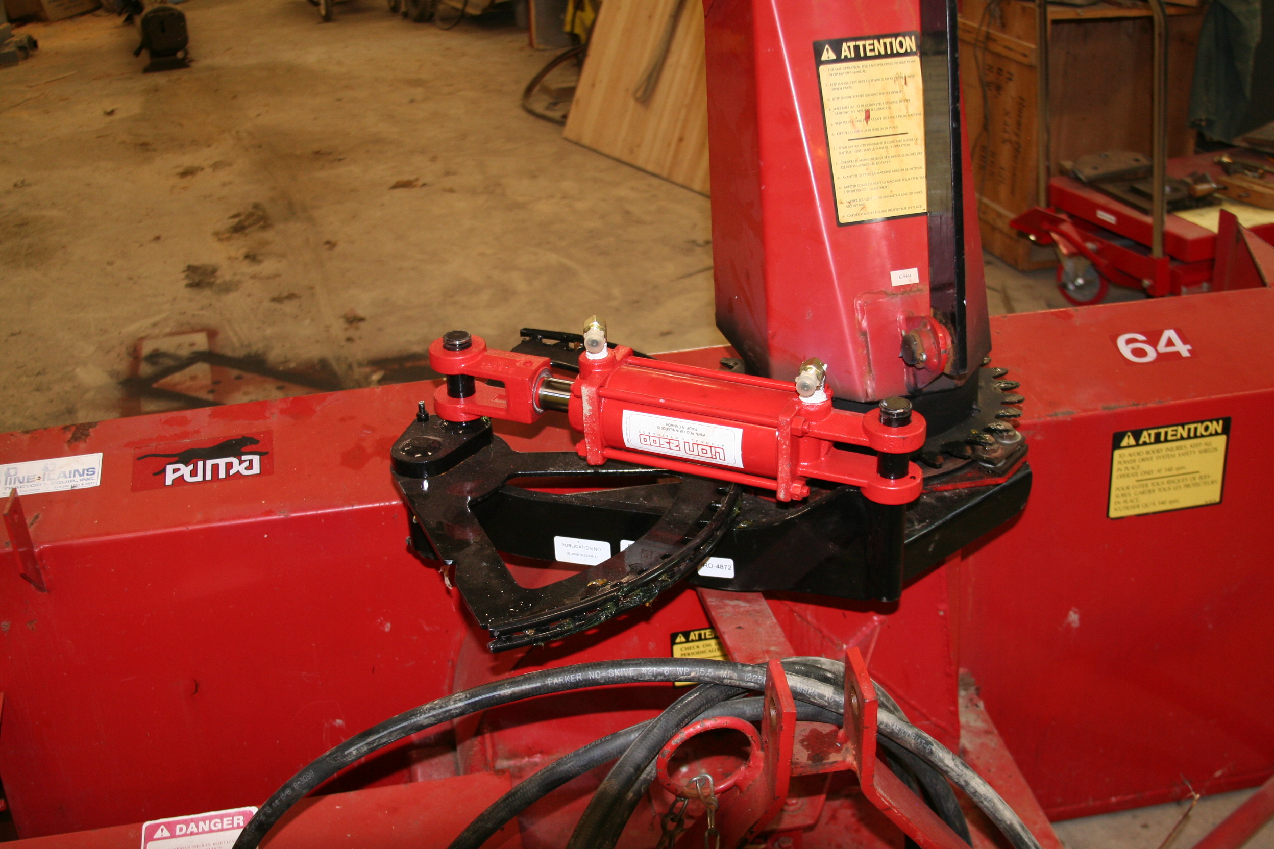

I have a Puma 64 10 years now No complaints
I did add hydraulic rotate and chute when I got a new tractor with 2 rear remotes.

Well, I went for the slightly used Puma 64 after all. It was too good a deal to pass up, and came complete w/ hydraulic chute mechanism. Plus, it matches my Kubota better than the old blue Ford 715 blower I've used for the past 25 years! :)
/ Puma 64 vs. Blizzard?? #9
Looks like someone suffered a little interference between the fan and chute baffle; rocks or something left in driveway :confused: Nice looking unit, all the same. Should use you well
