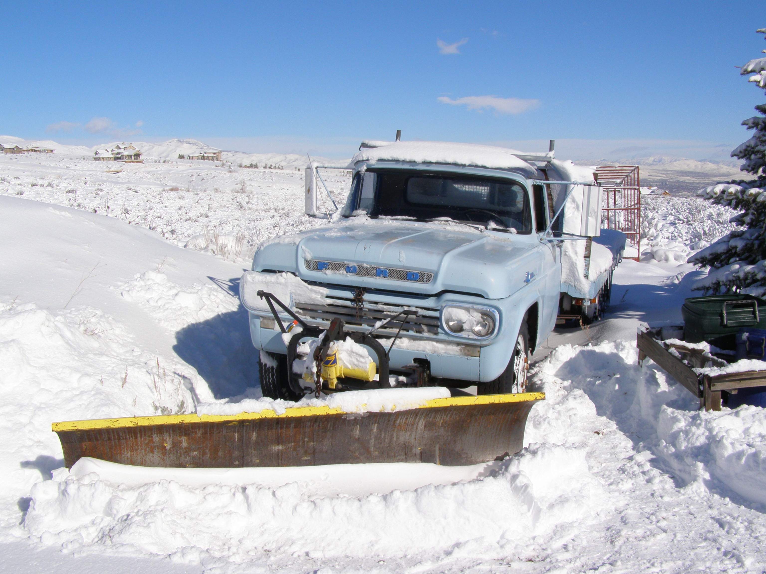

I ended up talking to a dealer in California and I'm sure I got the link from the Puma's/Pronovost web site. I was aware that the Puma was a bit different version of their snowblower but I was not trying to make a live with the snowblower, only trying to keep the roads clear in the event of a major storm which happens about every 5 to 10 years. What I have learned about snow removal................ Is to send it some place out of the way, is the best way, as the plow can't always find a place to put it. This is an average snow event. Most are less but some are truly eventful. As like about 4 or 5 years ago when we recived 2 feet a day for 4 days and then the wind blew..................:D I wasn't really smile...ling then, I didn't have the Toys/Tool's to get the job done like I do now, only the plow and a 8hp snowblower and a family with the will to fight.
