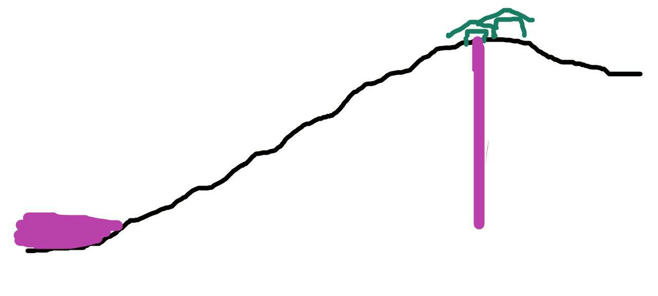

Where we live it's on top of a hill. My well is down 85ft. If you walk way down over the hill on my place is a nice spring. Judging elevation it's about 85 ft. down from well house. Spring is shown on an 1840 plat.
I always thought that spring is overflow from our well. The water is great tasting.
I also wondered after a rain how far down it can go. A heavy rain it looks like rivers across pasture going down to the creek. image_2019-06-21_16-42.jpg
