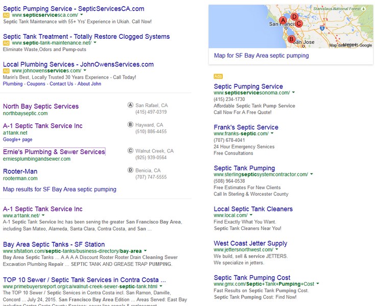

Good thinking on the map... the company he originally spoke with is listed... it's 74 miles away and the closest...
Looks like a region with 9 million people... few are on septic or septic in need of pumping in the SF Bay Area.

Septic pumping in SF Bay area, a few to choose from.........
https://www.google.com/search?num=2.......0...1c.1j2.64.hp..5.12.1000.0.rQ59Alvj48g
