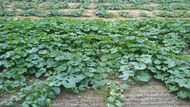

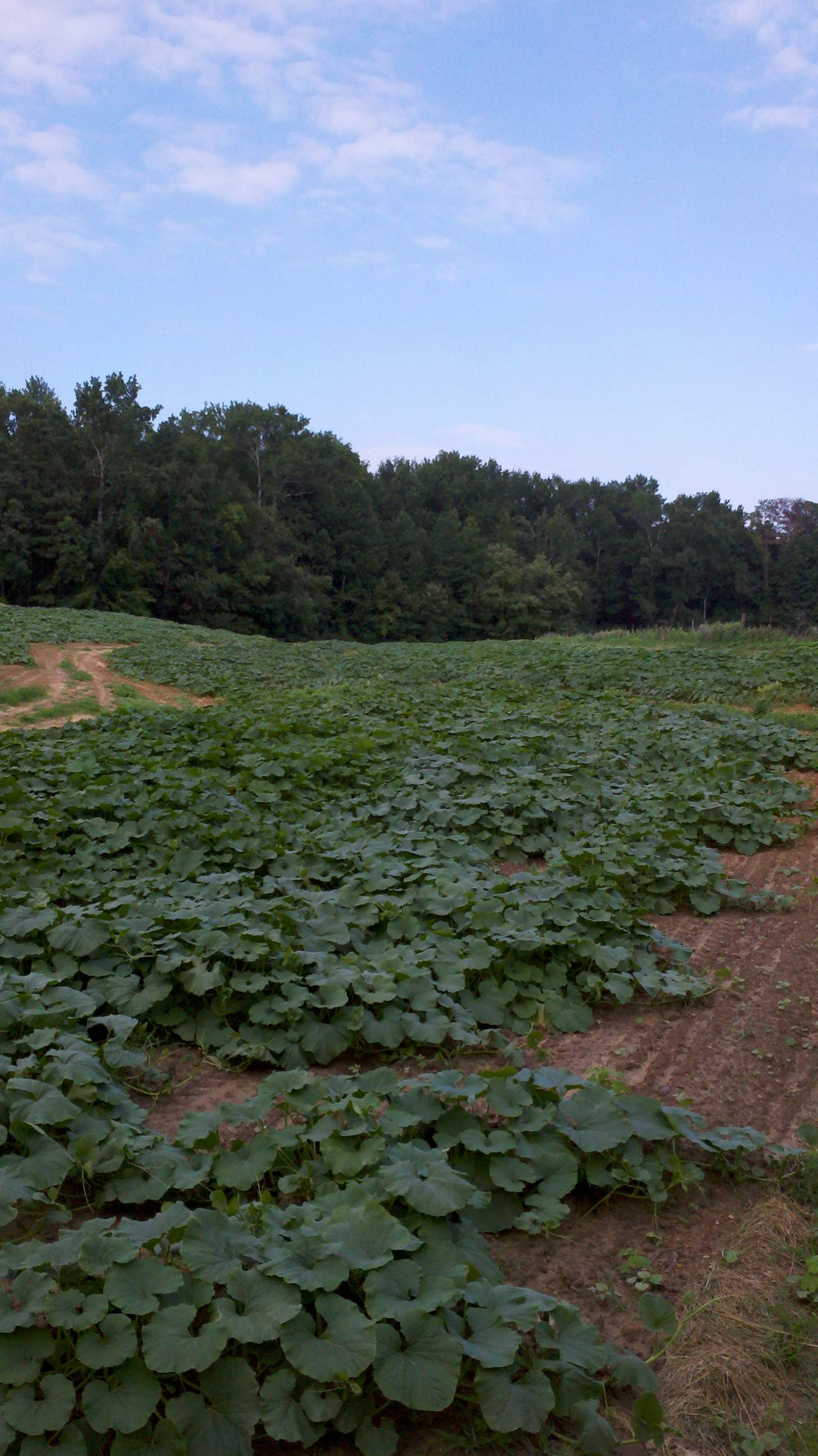

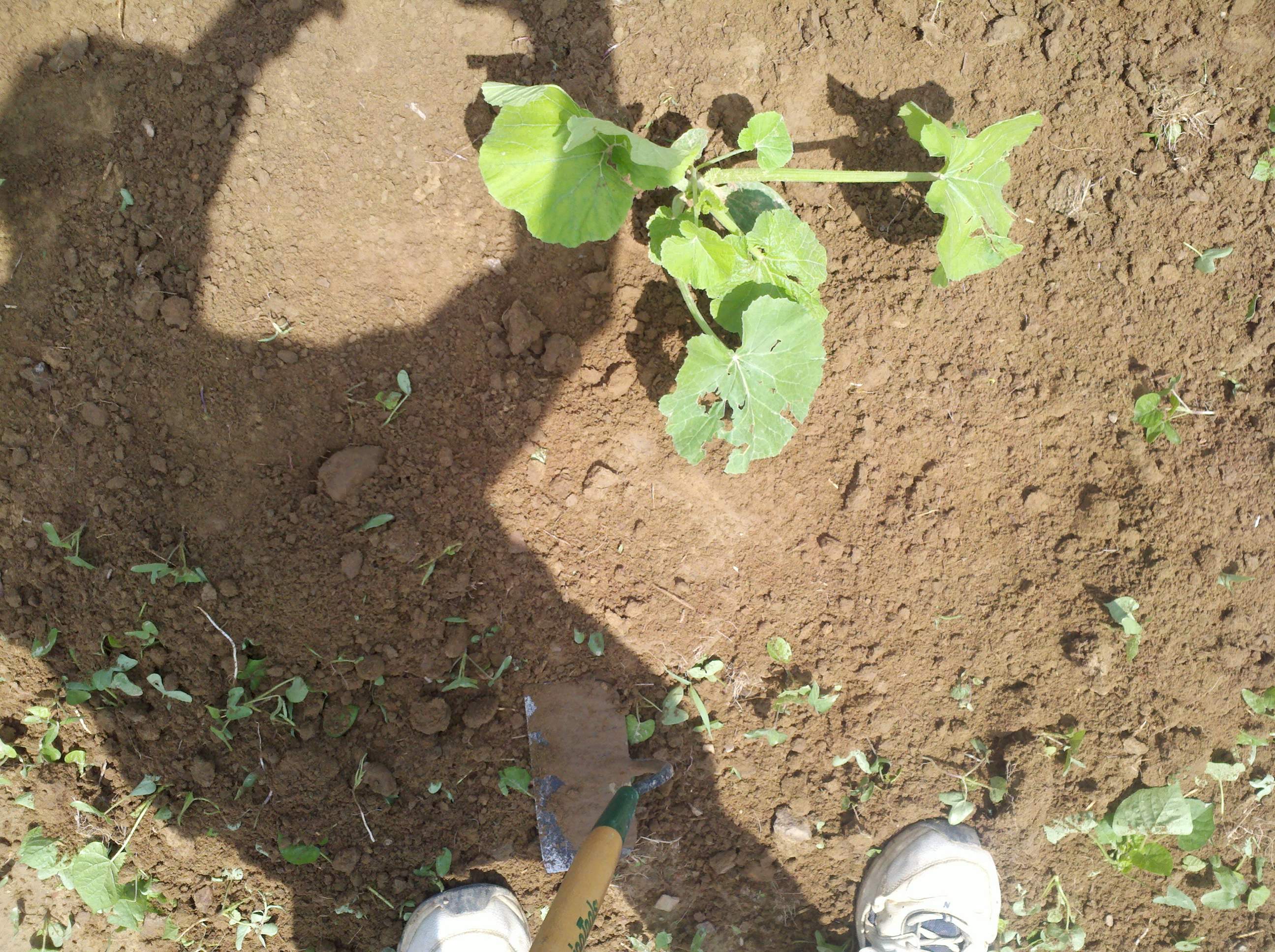

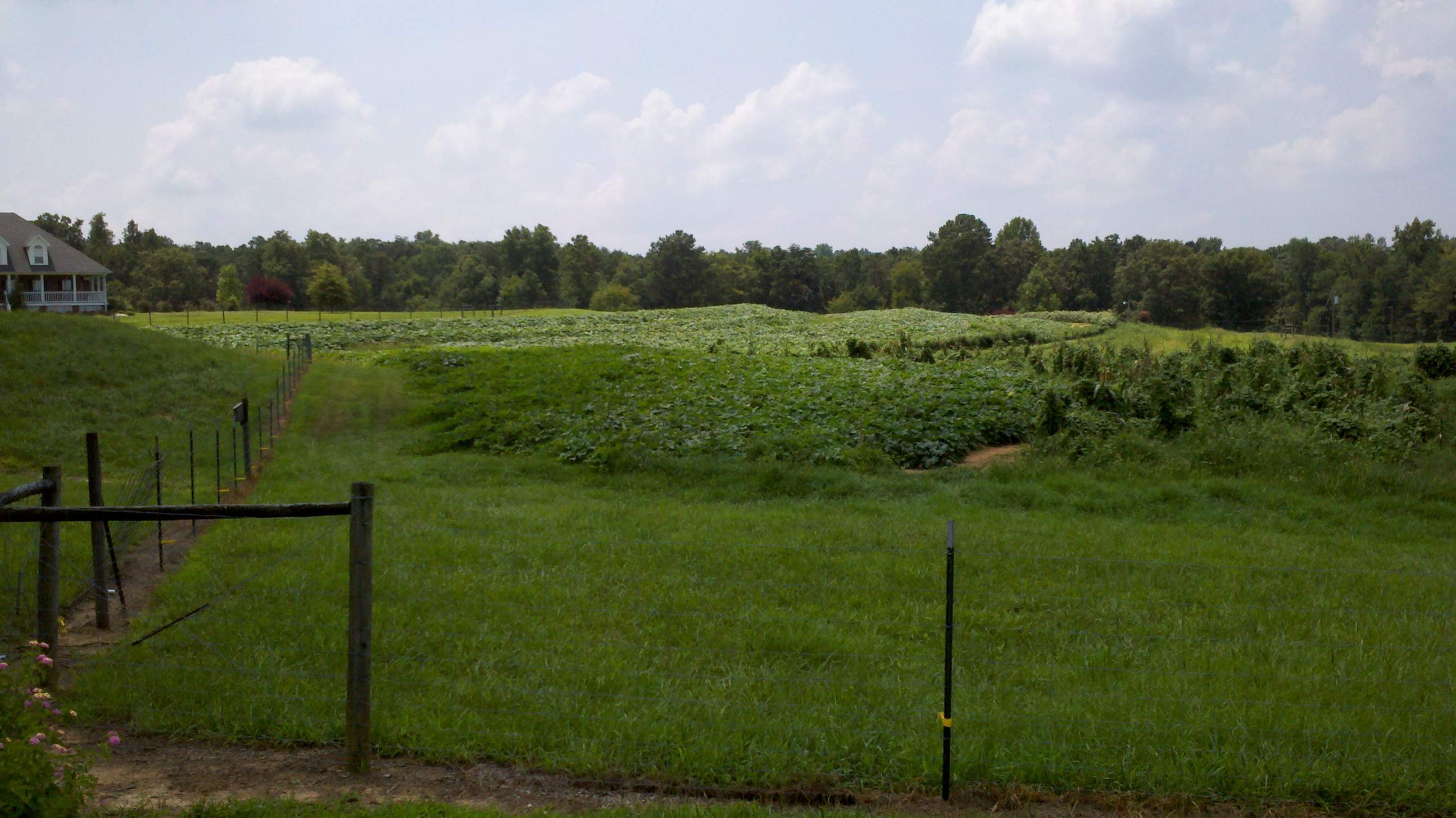

It looks like your letting your pumpkins act as ground cover to keep the weeds out once they get well established....what row configurations are you using when you plant? Are you just direct seeding into the ground? I could ask a million questions...but thanks for any answers you give.

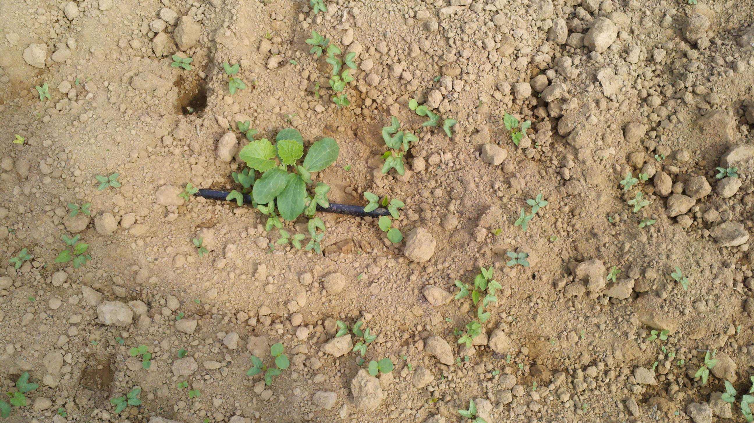

Question: How do you get your 2" pump to run through drip tape? I would think the pressure would blow the tape apart. My 2" trash pump fills a 500 gallon stock tank in about 5 minutes....
I'm using the 2" pump to water about 6000' of 5/8" drip tape (3 acres). The emitters are on 12" centers. The tape puts out .25 gallons of water per 100 feet per minute @ 10 psi. That's about 15 gallons per minute.
I have a liquid filled guage on the outlet side of the pump. I run the pressure @ about 25-30 psi at the pump. If I don't exceed this pressure then I don't have problems with the tape. If I exceed this pressure I do have problems. That's about 1/2 throttle on the 2" pacer pump.
I do use the vines as ground cover. I just have to cultivate the rows until the vines start to run. If I cultivate the last time just as they start to run I get good ground coverage and very few weeds.
Harris seeds has a chart in their catalog that tells plant spacing for the different type of pumpkins. Some are planted in 5' rows with 24" between the plants (bush type) and others are planted in 10' rows with 6'-8' between the plants (giant pumpkins).

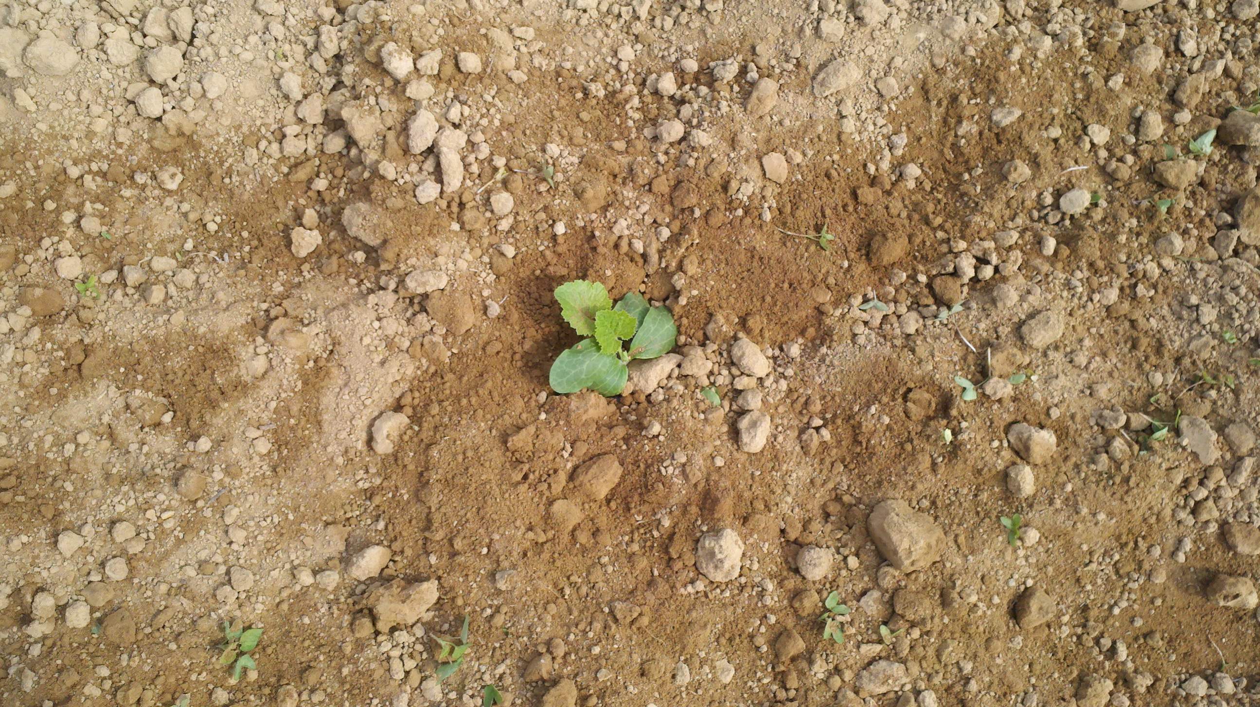

I do direct seed (by hand) and with the planter. Some of the seeds are really expensive and we plant them by hand (2 seeds to the hill). Others, such as the pie pumpkins, are less expensive and I plant them with a Covington planter. I then go back and thin the plants to one plant to the hill.
