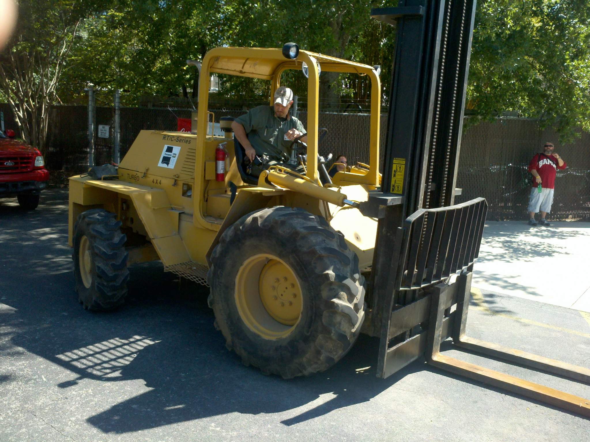

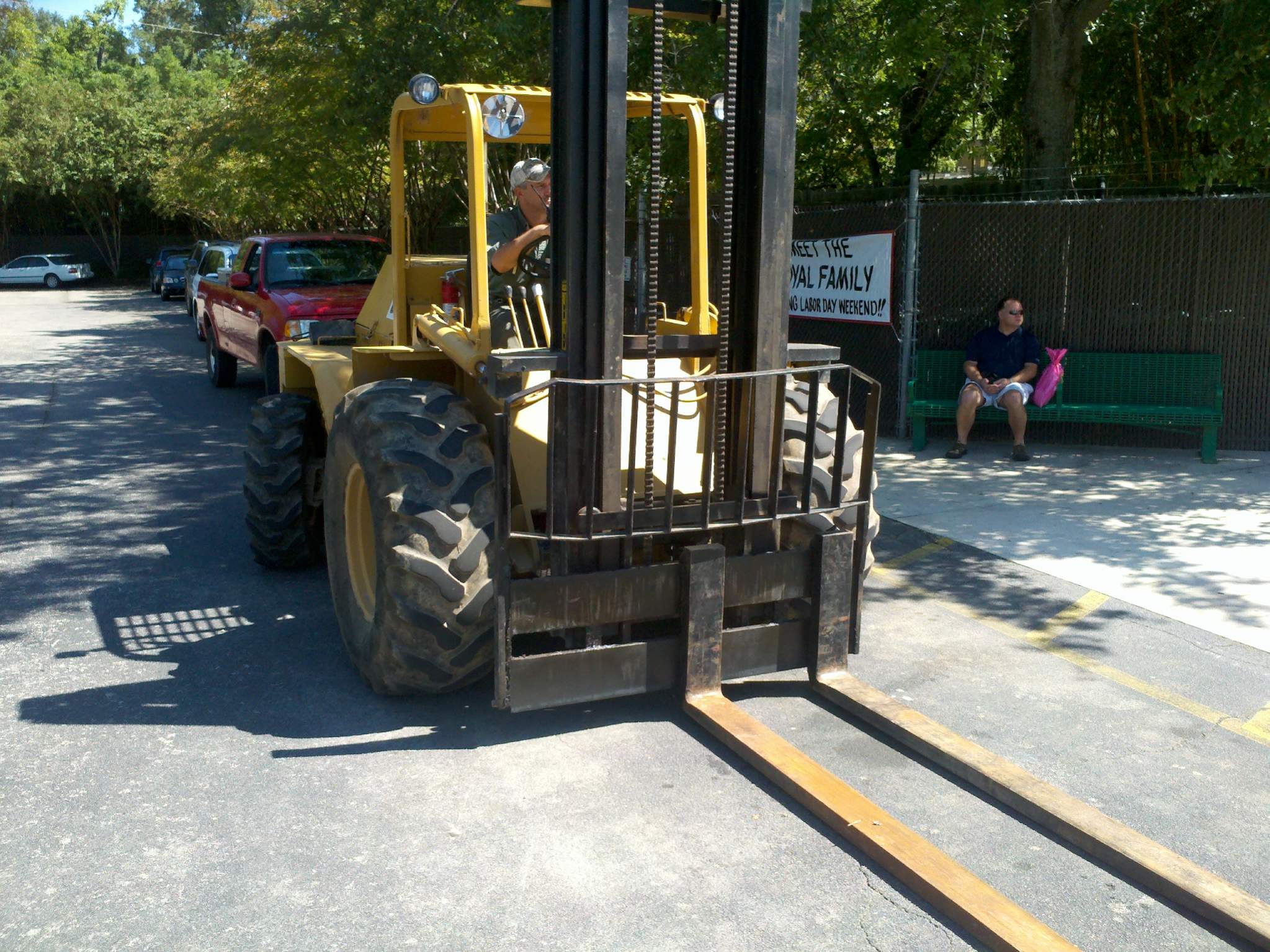

Since everyone loves pictures, I'll post these.
I went to the zoo this weekend to deliver two bins of pumpkins. This year they bought their pumpkins and cornstalks for "Boo at the Zoo" from us. I was afraid that they wouldn't have a way to unload them.
I think this forklift was a little overkill for a 4'x4' bin of pumpkins.... The forks were 8' long. I tried to convince my wife that if I had one of those, I could easily load two bins @ one time. It didn't work.... :cool:
