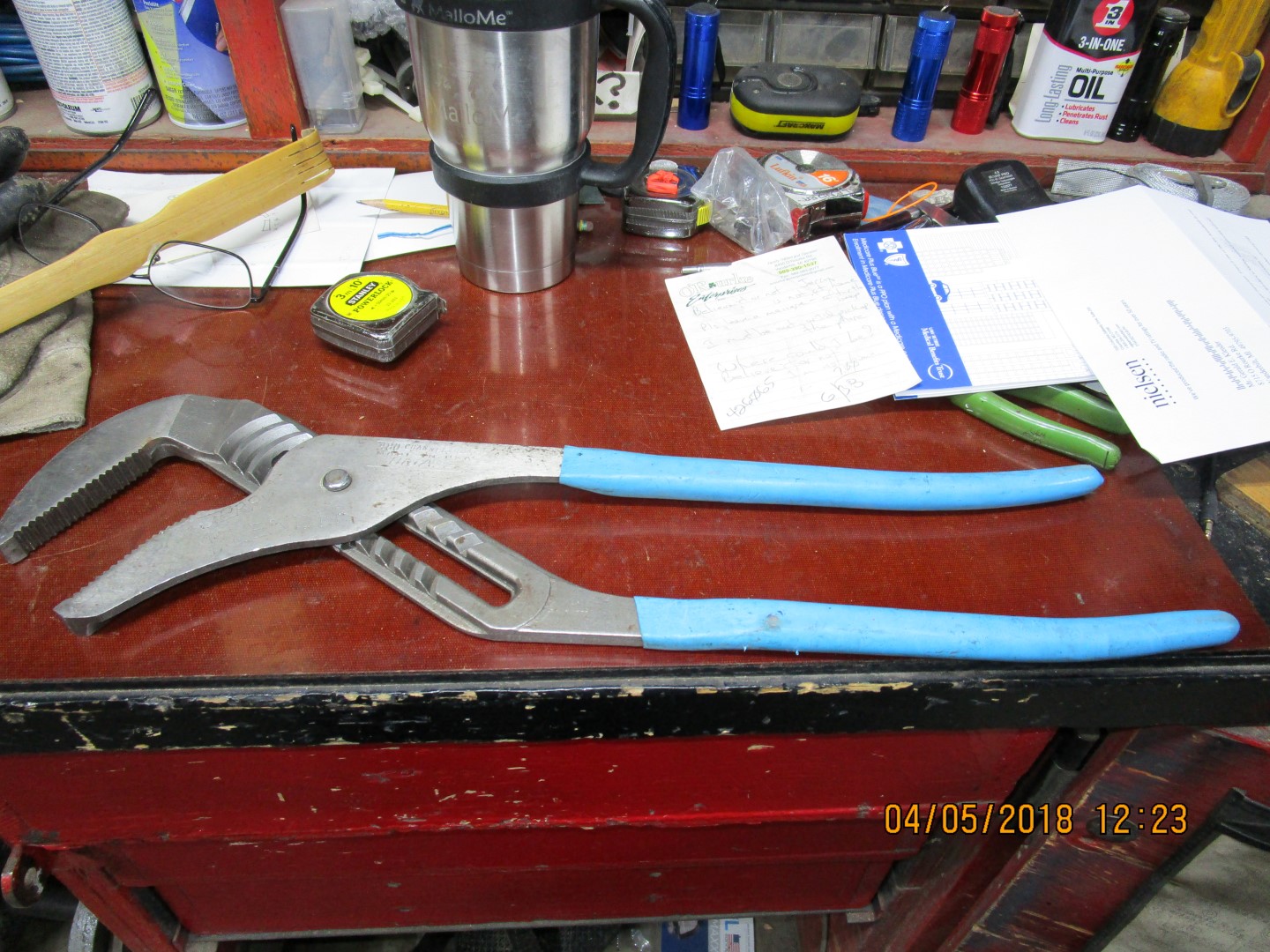

Same thing happened to me yesterday. Oil filter is pretty bent and I cant get it off yet.
   / Punctured oil filter #10
Sometimes you have to break out one of your big old ugly screwdrivers that you have been using for a pry bar for years [ don't have screws anymore with that big of head ] and drive the sucker right thru the filter from side to side. Helps if you put a smaller one thru sometimes. That used to be my filter removal tool of last resort.... before I had a drawer full of different various oil filter removal tools to fall back on...
   / Punctured oil filter #11
I use giant vise grip like oil filter wrenches to squeeze/crush filters in that condition
   / Punctured oil filter #12
The filter was severely deformed by the branch. Bent pretty bad so I pried it against the frame with a large screwdriver. I moved the electrical conduit below the filter (for access) and used a large channel lock pliers to get it off. Wicked rainy yesterday so I just screwed on the new filter, later today I will fill it with oil and check it real close once I get it to the garage.
   / Punctured oil filter #13
Big channel locks, kind of like BIG AZZ Channel locks.......??????????????????????????? :)

I just got my filter off using channel locks. I had to move the conduits to grasp it but it did turn off. I put in 3.5 quarts of oil just to limp it to the garage to check it over good. I think I’ll finish this project and then do fluid changes when it warms up.

I just got my filter off using channel locks. I had to move the conduits to grasp it but it did turn off. I put in 3.5 quarts of oil just to limp it to the garage to check it over good. I think I値l finish this project and then do fluid changes when it warms up.
Go invest in a good filter wrench. It will come in very handy if you intent to do any servicing on your own and you'll be glad you did. They aren't expensive and a bargain at twice the price. For filters with difficult access I sometimes resort to a strap wrench.
