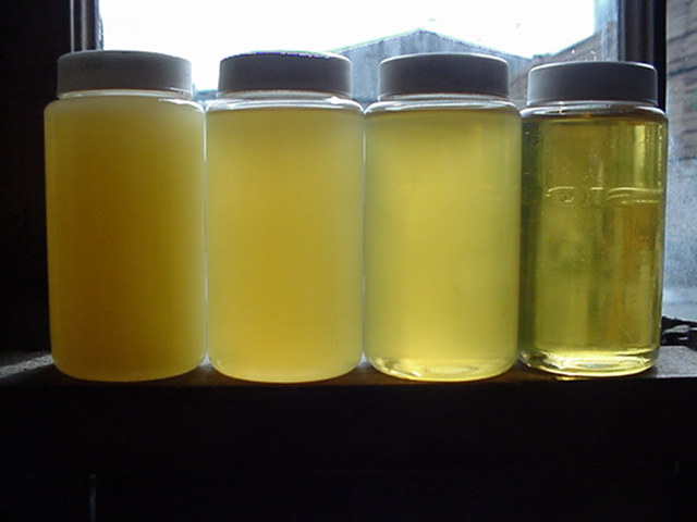

There was roughly 10 gals of clear oil in my reservoir of my hydraulic winch.
After hooking up my just built log splitter, The oil changed to something that looks like egg nogg. The water had to be in the cylinder before installation ( 4'' dia. 40 '' long when closed).
I have since drained and replaced the oil three times, used maybe 15 gals to do this.
At present the oil is still white, not egg nogg... but definitely not clear.
So my friends thats a long winded attempt to say that I don't think it takes much to make a mess.
I attached a pic. not great, but you can see the milky oil jar in the bottom of the image
Kinda late in the conversation, but did you test the oil to see if it was indeed water in the oil........especially where this is a recent start-up
I only say this cuz air-entrainment through a vacuum leak at suction hoses/fittings/pump shaft seal ect will make the oil white and foamy like you are showing.........Milky oil (from water) and foamy oil (from whipped up air) will look similar
Just an observation.........;)
   / Purging milky oil from system #70
I agree with wdchyd on the air entrapment, so wait about 24 hrs and look again, and if the fluid looks normal, then you have a suction leak. If it stays milky looking, it is probably emulsified water and oil, and should be removed ASAP.

This happens more times than you would think....The first thing I do is determine which problem it is.....
A glass jar full off coffe milkshake on a sunny window sill will tell a story.....from there it'll give you a direction.....
Like others have said here many times a suction leak will sneak up on you..... suction hoses, connections, tubing, pump shaft seal all can be culprits...
If the suction leak is in a questionable spot, then pack it with grease, start it up, to see if it keeps the oil clear from an overnight rest.......if the pump shaft seal is exposed, sometimes this is an easy way to rule out bad shaft seal.....glob it right on.....
I had a job where 2 technicians spent 3 days looking for a suction leak on a large press brake at a welding/fabricating shop...air bubbles in oil and knocking sounds.......the hyd pump was above the reservoir and was not leaking oil when it ran......so the other guys said "There's nothing wrong with the pump".......standing on top of the machine I called for a new tube of grease from my helper......2 grown men looked at me like I had 3 eyes.......I emptied a half tube of grease on my hand and smeared it on the exposed shaft coming out of the pump.....
I said "Start it up"....and the pump noise smoothed right out......took about 10 minutes to find the problem.....bad hyd pump shaft seal
If you have trouble finding the issue, grease will be your friend.....:thumbsup:
