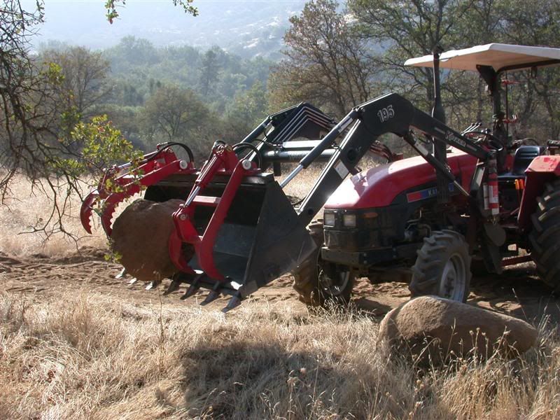

I finished repairing the tractor from the damage to the lower drag links when we got to camp last weekend. I ran into a couple of problems but got started with the rest of the trails. I started down the trail to the West side clearing along and came up to the fence line.
Along the way I ran into more rocks and had to move them. When dragging the boxblade, I would constantly pop up small boulders like these.
