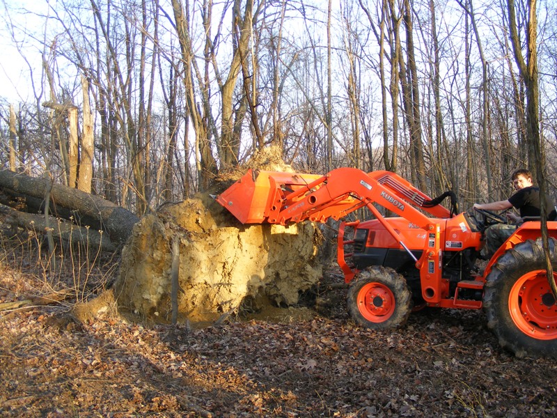

When I'm pushing on trees trying to get them down, my limitation is the tractor. The wheels will slip or the tractor will bog down or start climbing the tree. I haven't damaged the fel in the four years of doing that. Don't know if the recommended fels for different tractors are matched like that or not.
Here is a picture of my son testing the limitations of the L4400 HST. The trick is getting the tooth bar undeer the root ball. That is a wild cherry tree. Oh and it also helps if you let the wind blow it down first.LOL
