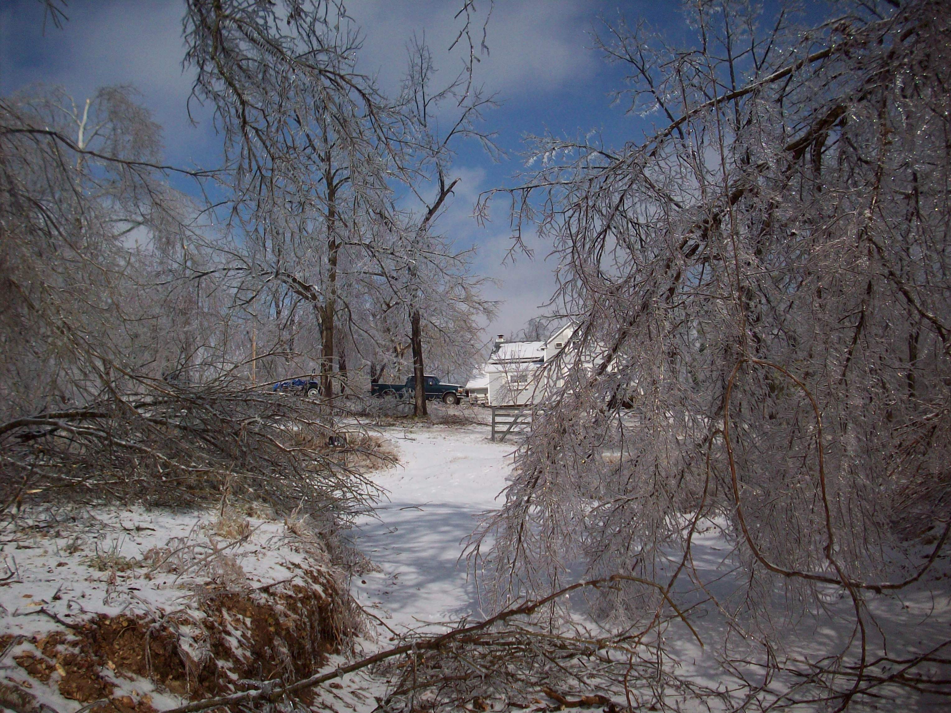

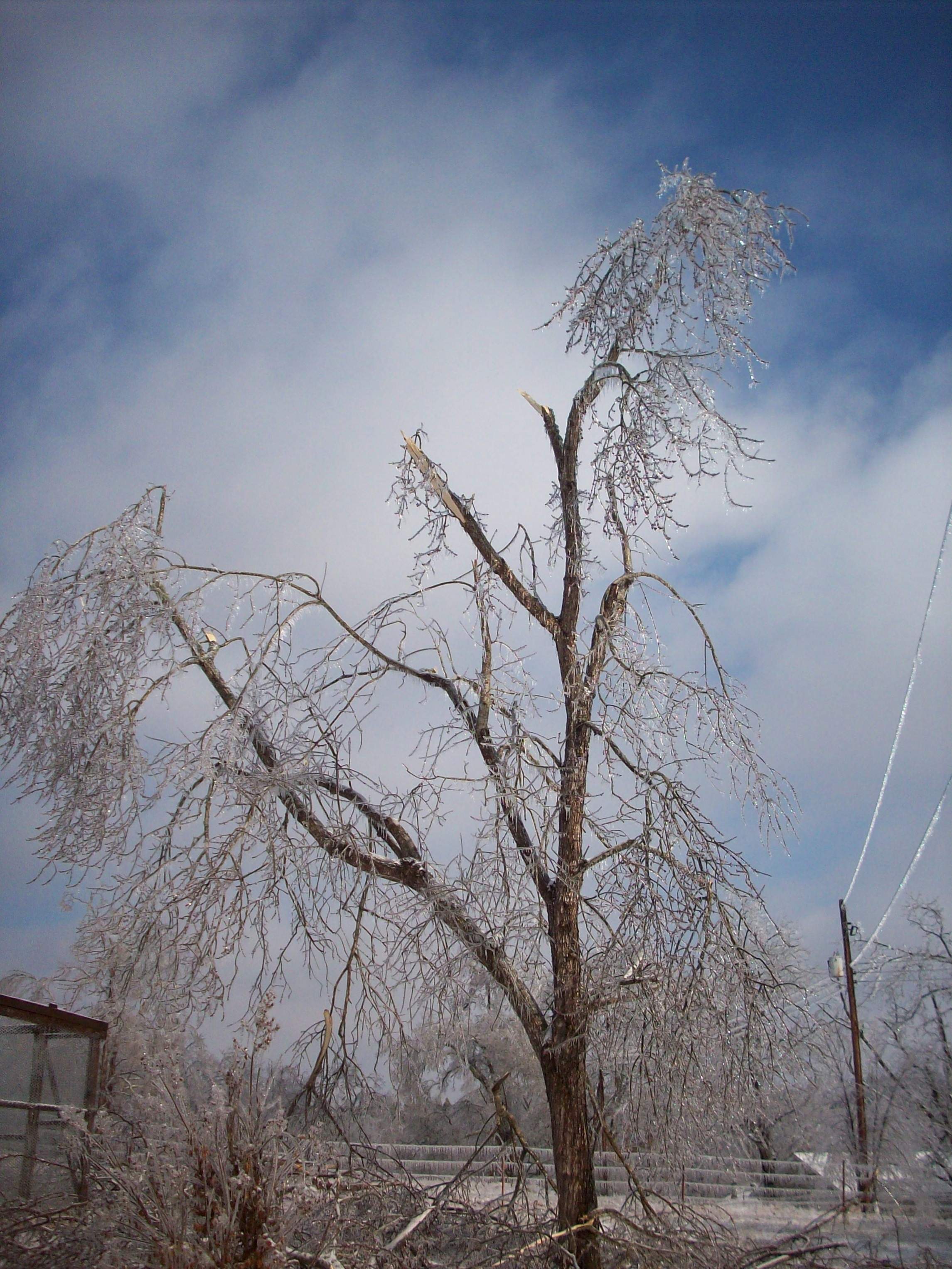

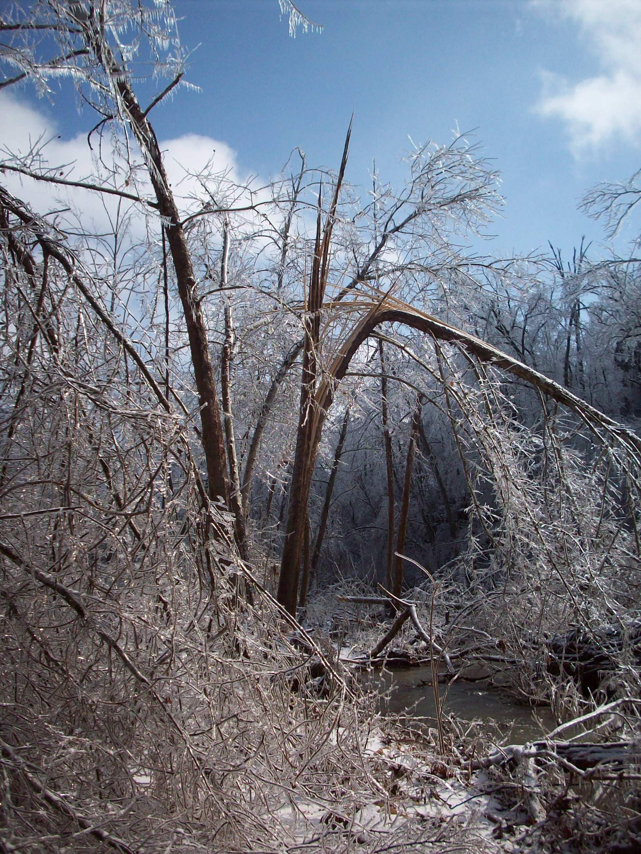

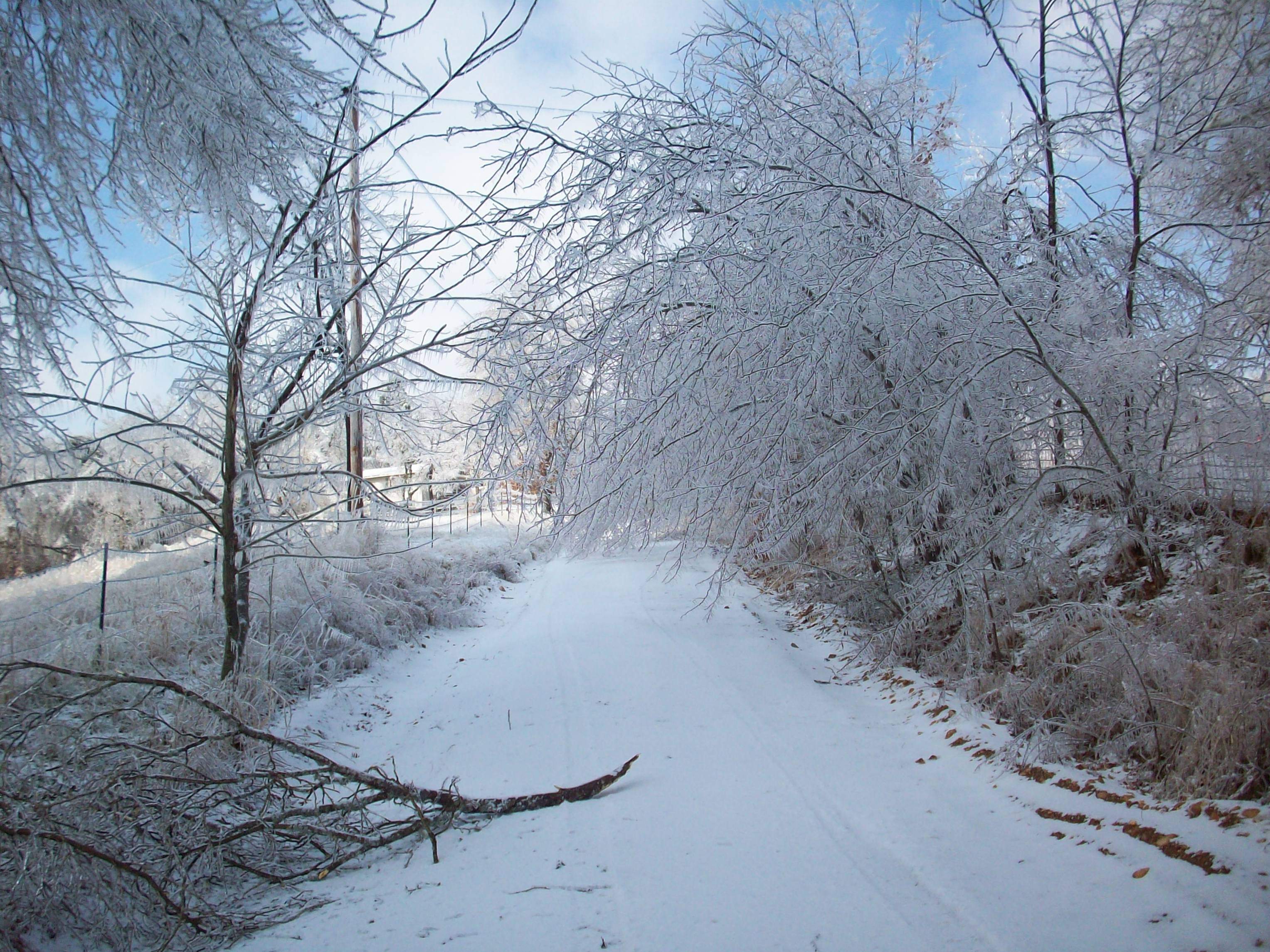

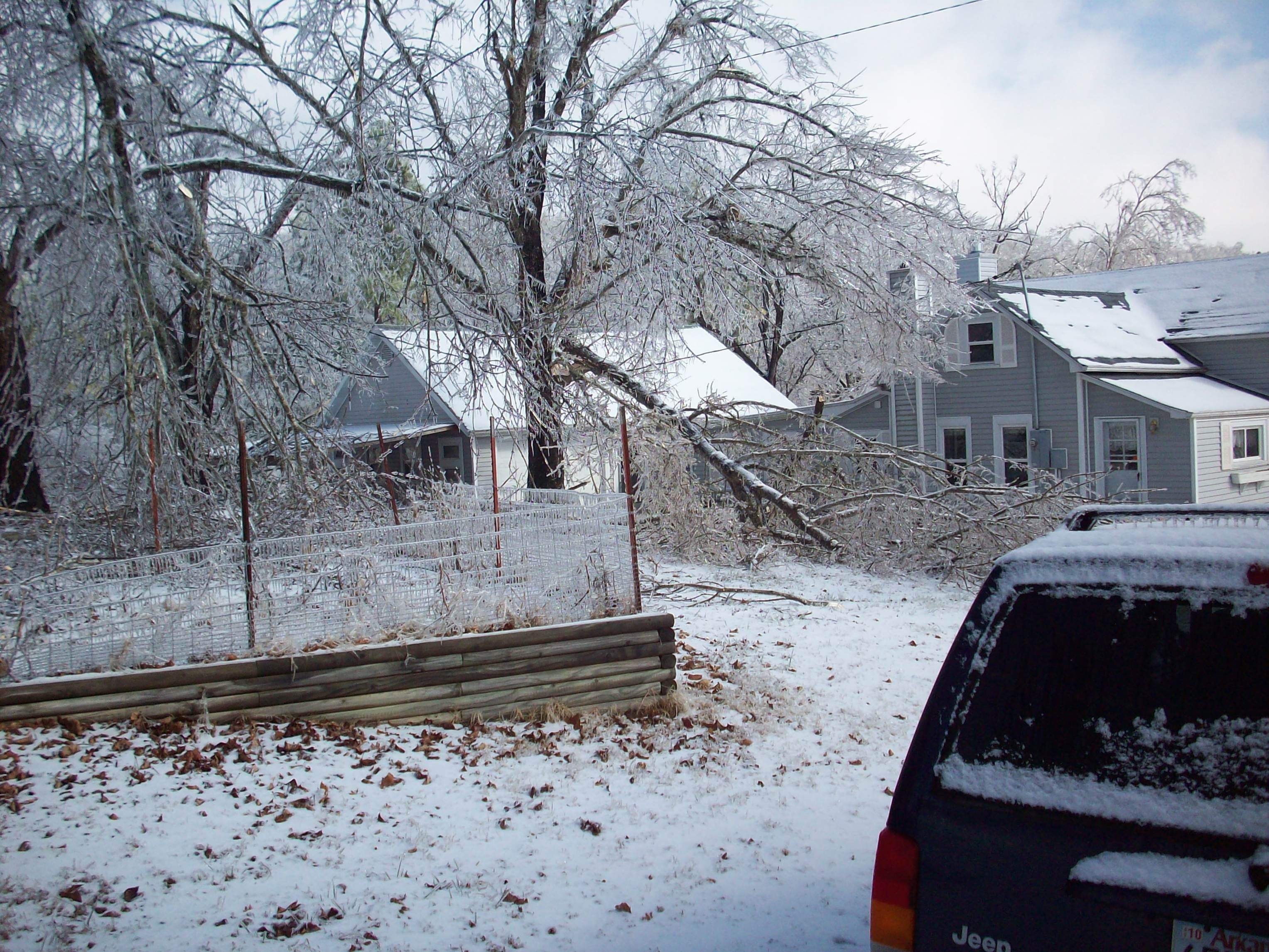

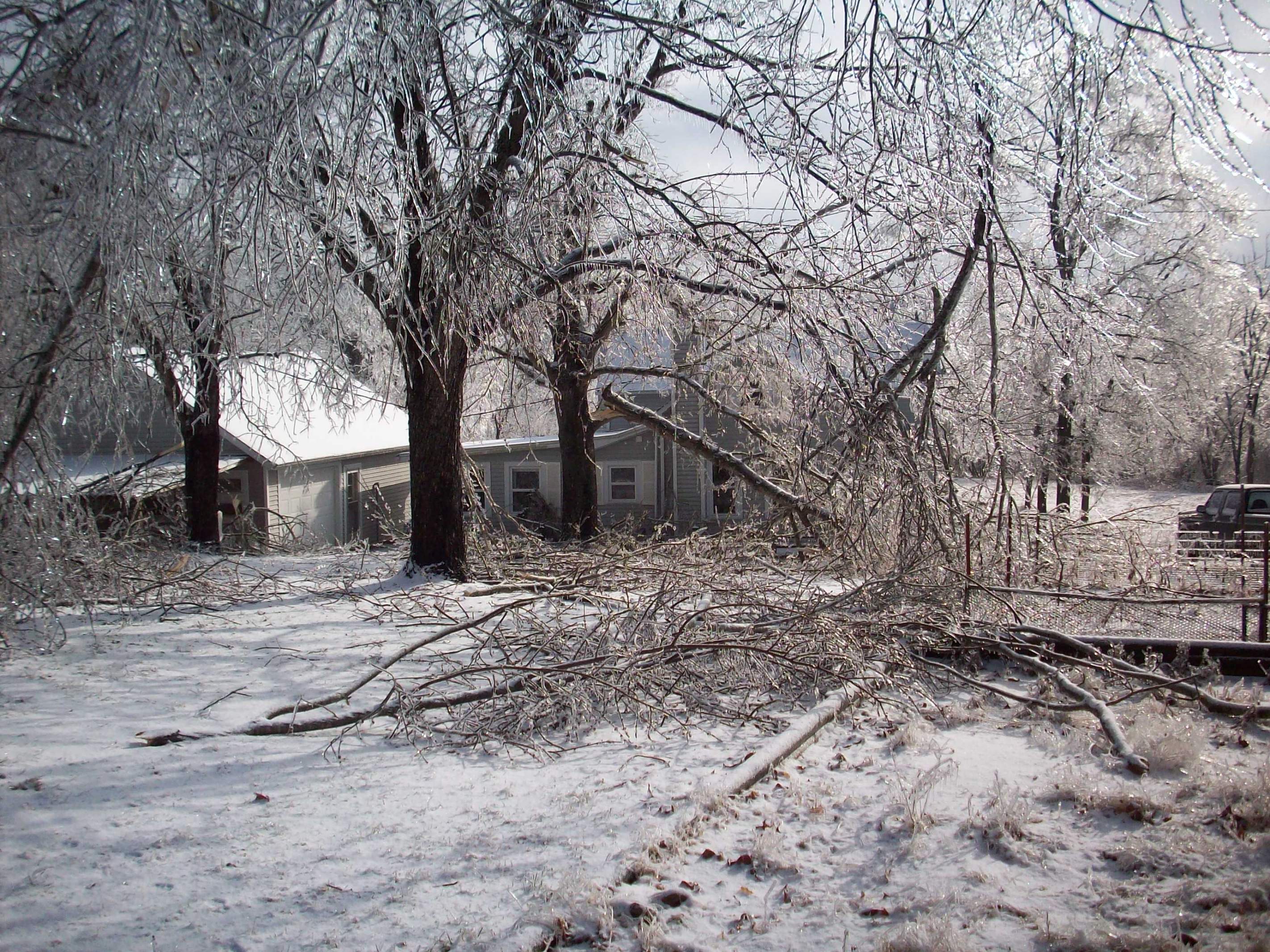

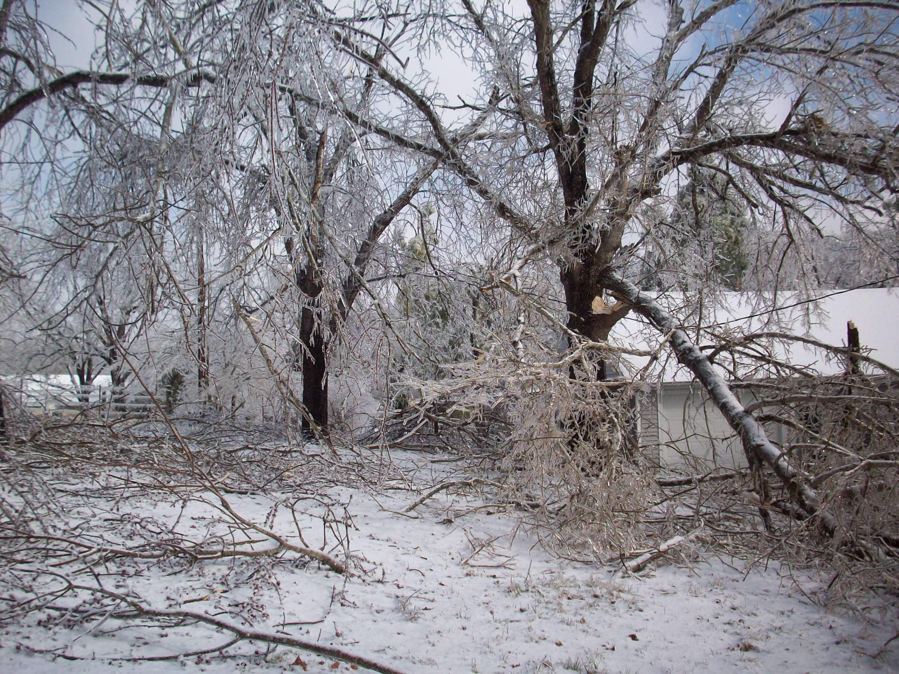

I've read some posts where people discuss using their FEL to push down tree's. Naturally how big a tree you could push down would depend on your FEL and tractor size. I have a NH 2420 (60hp / 4WD) and a NH270 FEL. How big a tree could I push down without damaging the FEL? Of course pushing tree's down is dangerous and safety is important so I'd be interested in safety information also. I guess my bigger question is how much can your FEL push without breaking it. Obviously a tractor and FEL is not a bulldozer. And a FEL is probably more prone to damage than a solid blade mounted on the front end. We just had a major ice storm here in North Central Arkansas and I have some tree's which simply need to be pushed down and cut up. Which do you feel is a safer way to get a tree down... knock it down with a tractor or fell it with an axe and chainsaw?
Here are a few pictures of the storm's aftermath. That last picture is the road leading to our house.

When I'm pushing on trees trying to get them down, my limitation is the tractor. The wheels will slip or the tractor will bog down or start climbing the tree. I haven't damaged the fel in the four years of doing that. Don't know if the recommended fels for different tractors are matched like that or not.
/ Pushing With FEL #3
IMO your not going to be pushing trees down anything near like the size of the ones in your photos, even with your 60 HP tractor.
I'm sure the tractor will be worth it's weight in gold during the substantial clean up you've got on your hands, especially those large broken limbs that are still partly attached or hanging from the tree, the loader should be capable of dislodging them safely as opposed to trying to go at them with a chain saw. But some of them widow makers way up there are just plain out of reach and the whole tree might have to be cut down, which is no easy/risk free task with them hanging over your head.
If the tree looks like it could survive,I'd try and snag those high branches with a rope and pull them from a safe distance with the tractor.
This storm is going to cause a whole lot of collateral damage/injury in the months ahead I'm afraid, as people deal with the colossal clean-up

A dozer will just drive forward and push over trees. But, unless it's a BIG one, they will raise the blade and push from higher up.
With an FEL, you can raise the FEL up high, push into the tree and then lower the bucket. You can also uncurl to add more force. Just pushing from 12-24" off the ground and a 4" tree will stop you cold. Unless the ground is marshy.
jb
/ Pushing With FEL #5
I have pushed a 8" dead tree over with a 60 hp TLB. Go up 9-10' and push, when it starts going over drop bucket down & continue. Idea is to keep the rootball out from under the front axle.
Your case it may not work at all if the ground is frozen the rootball will stay & best case is breaking the trunk.
Another thought the roots have stored energy and by just trimming the broken branches the leftover tree may bloom.
/ Pushing With FEL #6
I know they look horrible now, but like others have said I would clean up the branches and see what survives. I'm guessing in a couple of years you wont even be able to tell most of those trees were hit my the ice storm. Mother nature is pretty good at making messes, but she's also pretty good at getting things back to "normal" too.

Yes, some of those trees are definitely too big. I just included the pictures as an example of what a bad ice storm can do. The night of the storm I went outside and about every 30 seconds I could hear a tree snapping or splitting. It sounded like people hunting in the woods. I've never seen (or heard) anything like it.

I pushed over / dug up some thorn trees that were about 8 inches at the base. I dont think you will damage the FEL doing that. I have a 45 HP tractor and it would just ride up the tree if you raised the bucket, with it lowered, the tractor would just spin all 4 wheels. I get it down by taking my box blade and lowering the scarifies as low as they would go and cross hatching the root ball and then digging out the dirt and kept doing that till I was able to get the tooth bar under it and curl it out. I did the same with a small oak and it was much easier than the thorn. Willow trees in a marshy area, I just hooked the bucket under them and pushed / lifted them out. 6-8 inches is about the max i have done so far. Really be careful with dead trees or one with loose limbs unless you have a very good FOPS on your tractor. Dont ram into a dead tree either as it will surely snap the top if it is weak in it will come back on you. Just gently push it over or throw a chain around it high up and pull it would be better idea I think. Just make sure your chain is longer than the tree is tall.

Just be careful. Some trees can snap up higher than where you are pushing and the upper piece will then fall back towards you on your head instead of away from you. Seen it happen with a tree that seemed pretty healthy, not just dead trees. Would be safer to pull it down maybe from a safe distance? Or use a chain saw to cut it down.

I don't think you can really come up with one formula for the tree size you can take down with your tractor. There are just too many variables. The type of tree and the soil moisture are two of the biggest things that can vary your results. Also, a dead oak tree is an accident waiting to happen if you have dead limbs above your head. Even healthy postoak trees will have brittle limbs that easily break off if you shake the tree too much.
Recently, I used my little 45 hp tractor to push over a postoak tree for my neighbor. The tree was at least 18' at the base. The soil was sandy, but there were some large rocks around the base of the tree. My neighbor had first asked me to clear the rocks so he could dig out the roots, but I suggested I could do the root grubbing with my toothbar on the FEL. After only 10 minutes of digging out rocks and cutting roots, I gave the tree a gentle and steady push from the uphill side about 6' up on the trunk. The big oak tree just slowly went over. I repositioned once and had it on the ground with the second push. Then, I dug under the root ball and popped the stump out of the hole. It was almost too easy. Not only did I get the tree down, but I put it exactly where he asked me to. I didn't damage any of his other trees. Now he has a cabin built on that spot and you'd never know that big oak was ever there.
