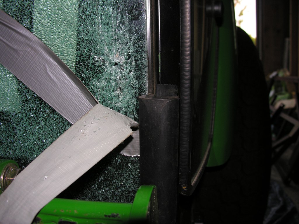

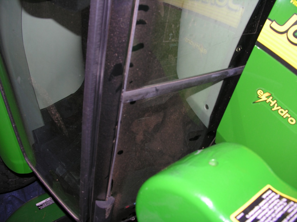

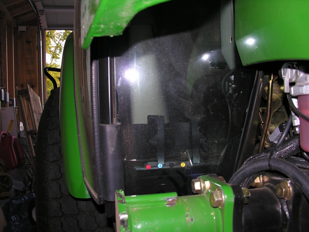

Nuru said:
Plus it fits easier in tight places! Oh and I gotta buy a new lower window, taking the loader off in the wooden garage and it moved a bit and the left loader arm hit the window ever so slightly but it shattered. I goofed, buit it will only cost me <$100, and it won't happen again. There will be precautions, put in place so if it happens again, something else will take the slight hit.
But boy was it fun to cut the lawn today, it was over 90 degrees out here but it was very cool in the cab. All i need is SAT Radio installed and that will do the trick for me
Please share your ideas on how not to break the glass to a cab newbie.
The big and heavy might be nice for me. The 61 is pretty light. I slide it around with ease when its off the tractor.
   / Put in the order for a new 3720 Cab today #14
Well after a little research, I find my unit was telling to watch out and I did not bite. The lever that secures the latches on the left side, was sticking and I finally just decided to go ahead and assist it past the part of the loader that was binding it. huge hint here - the loader is not level if this happens! It was only slight but it was enough to matter in a cab tractor with glass so close. The JD rubber Loader bumper did not cut it as the arm jumped knocked it off and slightly punched the LH lower glass and boom it was shattered. So i would advise that some shock absorbing material like rubber be used between the loader arm ends and the Lower window glass on both sides. I am gonna use Horse mat and just place the sheets in the path while i am working on installing and detaching the loader. That should do it.

Thanks for the picks nuru....
I was hoping for the same thing Dave... BUT I am going to get the 59" snowblower so I will have to remove it each season.
Thanks to Nurus advice, I guess i will take it slow and stop when the slightest thing does not feel right. I have run into the same thing on my open station as Nuru, and did the same as he. Hopefully I can save the 100 dollars by being extra carefull.

yep. me too, but with the loader on and no rear ballast, the unit feels more tippy, so when mowing it is not gonna happen for me. But without the loader on with those Turf specials, the unit is very good and is agile from a tractor perspective.
nmu98; I would advise getting the horse matt and cut it so that you can just place it between the loader arms and the windows, I would imagine that should help prevent the bump jump from causing you to spend ~140 bucks like I did. Even that rubber used for workout centers might be good enough - just something that will prevent a surgical strike like i had from nailing your LH and RH lower windows. Surgical strike as in it hit above the loader bumber on one side and that is all it took!:eek:
