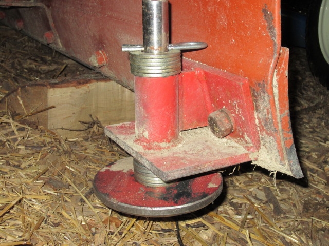

I made brackets to hold snowplow shoes for when the ground is soft.
I had these on a plow once. They dug in like crazy. Took them off and threw them aside. There really mostly for pavement.
The real questions is if the ground is that soft do you really even need to touch the ground with the plow?

^^Correct, if we are talking muddy ground like the OP has, the shoes will just dig grooves.

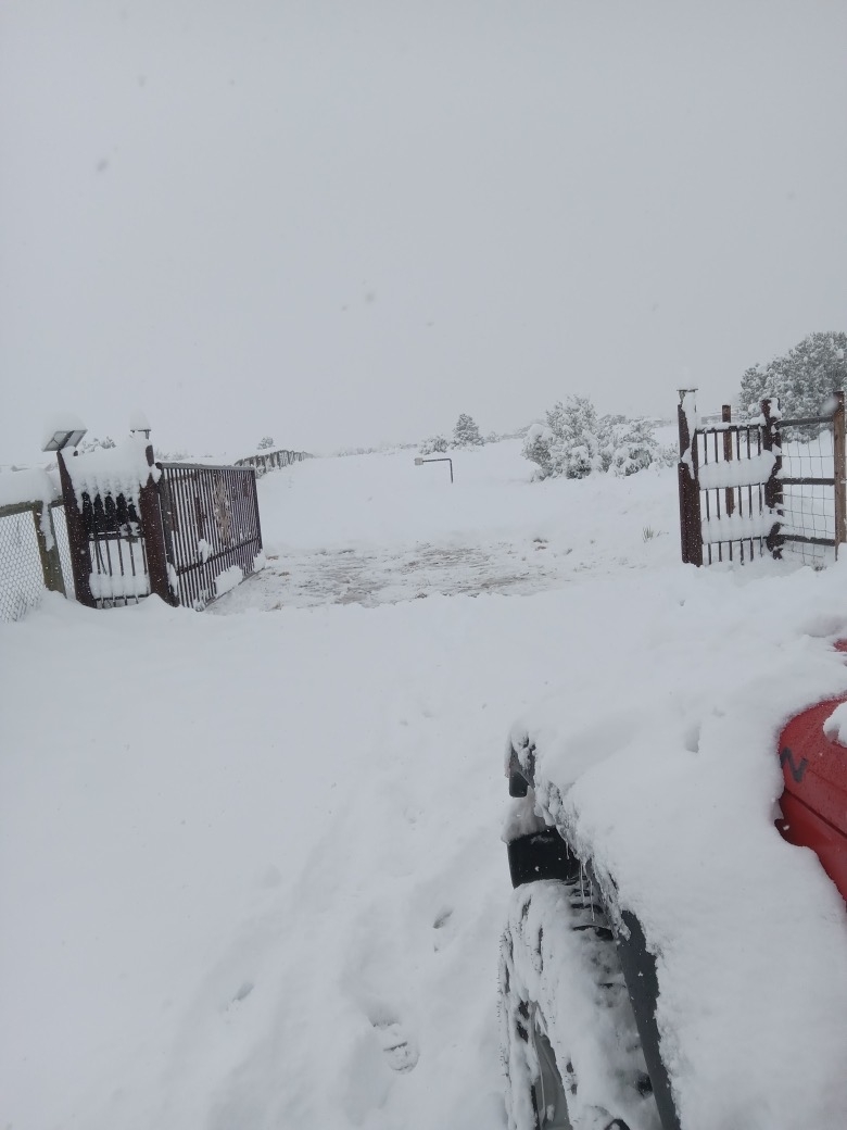

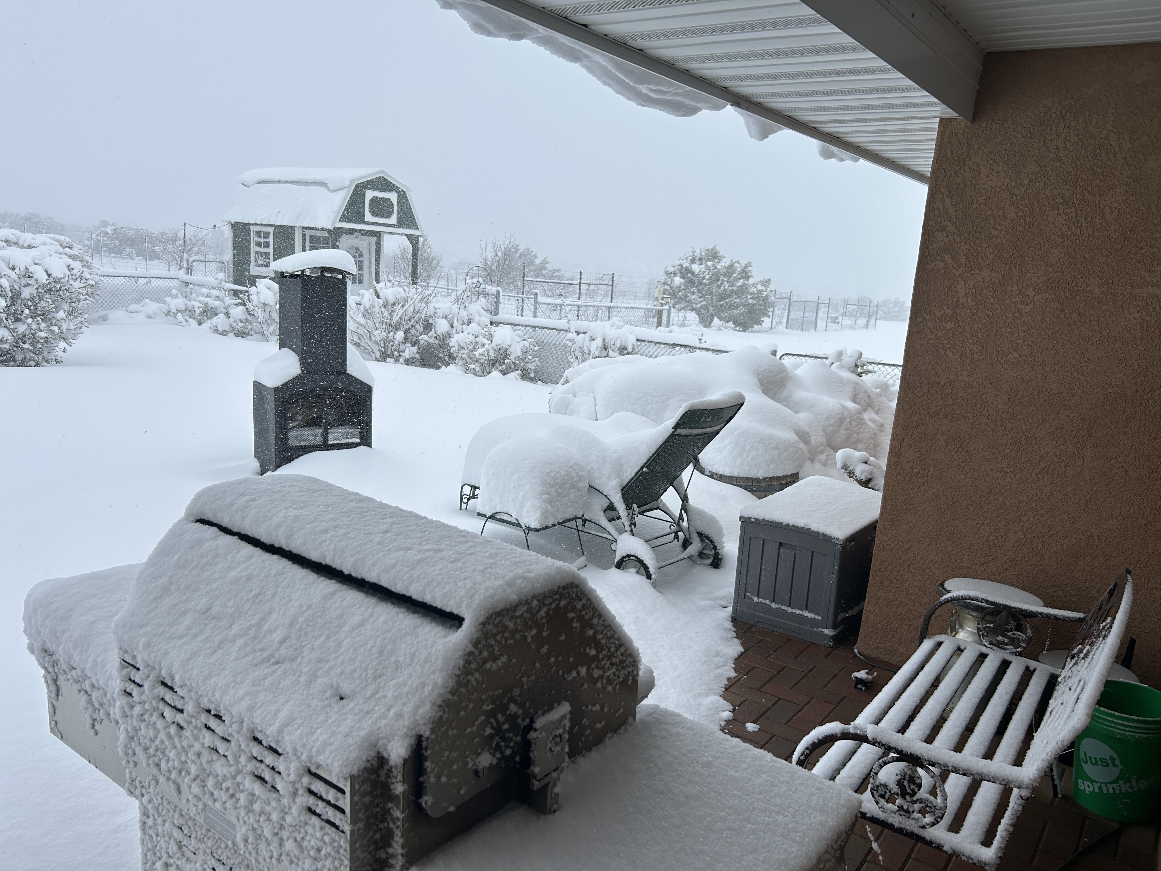

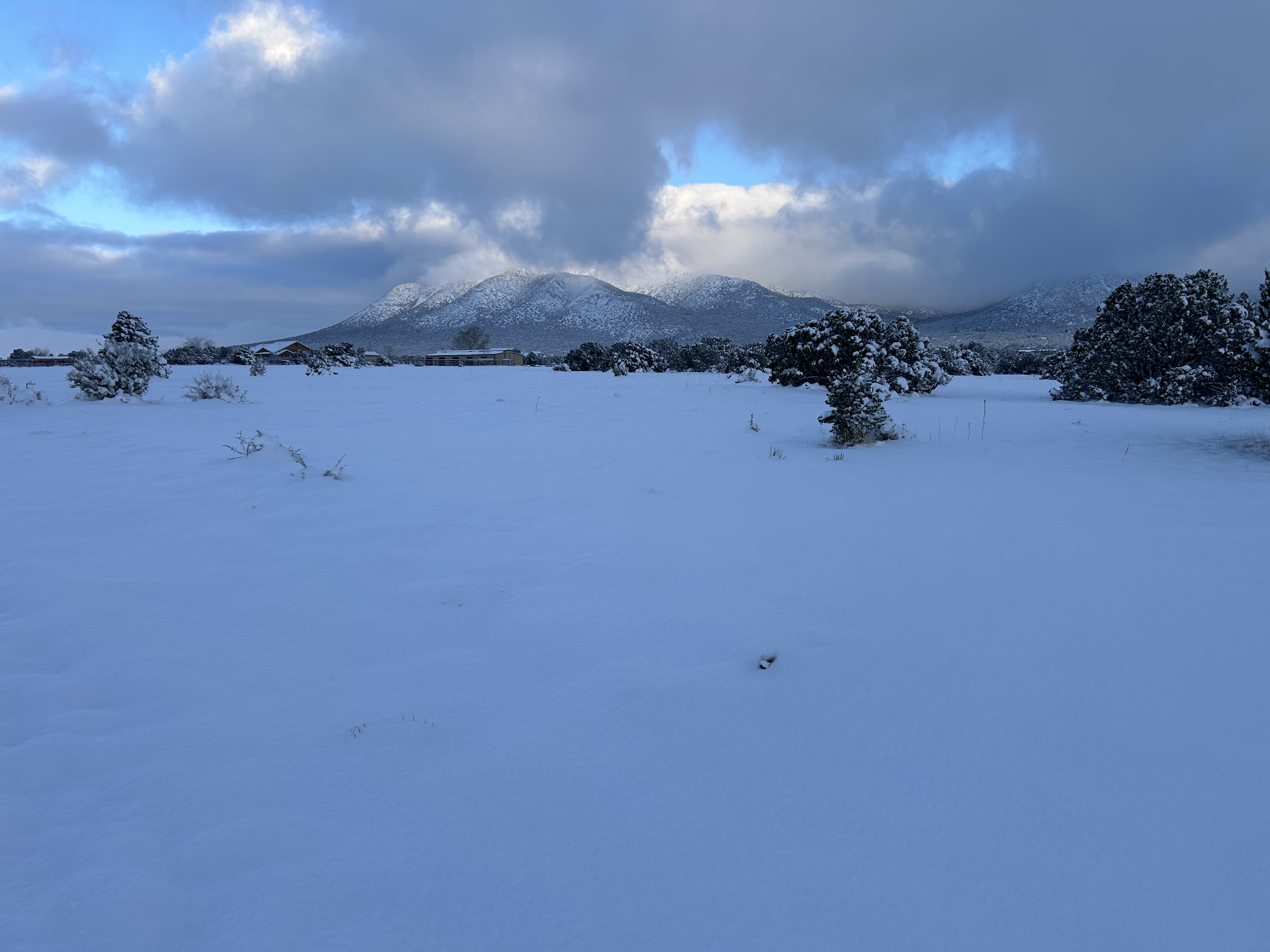

We have had over 3’ of snow in one storm, many 18” and typically 12” storms. I don’t know who told you that we don’t get snow. We do have some open winters, but certainly do get slammed by heavy storms when the Pacific fronts move in. We also get wrap around winter fronts from the Rocky Mountain front range. Your sources of information are absolutely wrong and I have lived here 21 years.
